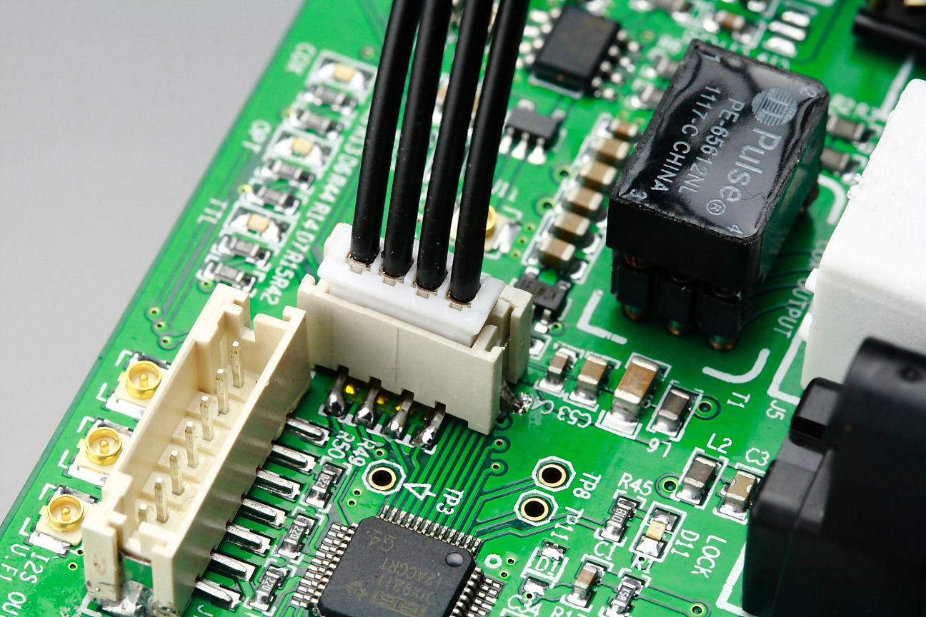

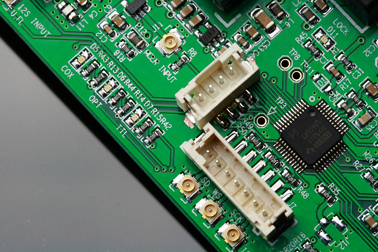

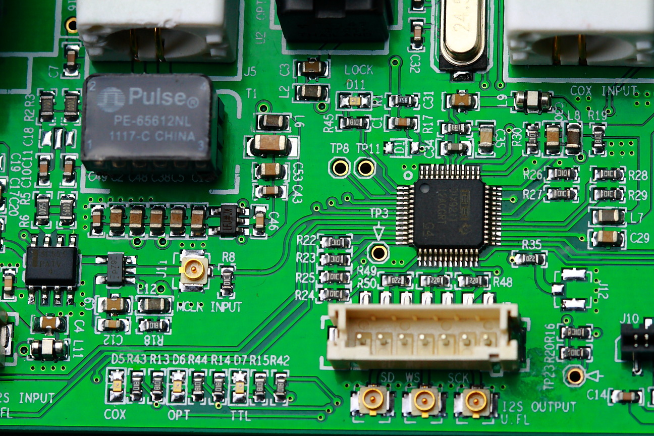

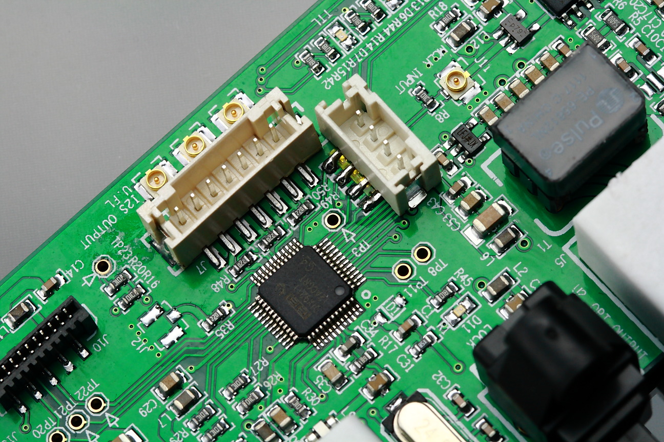

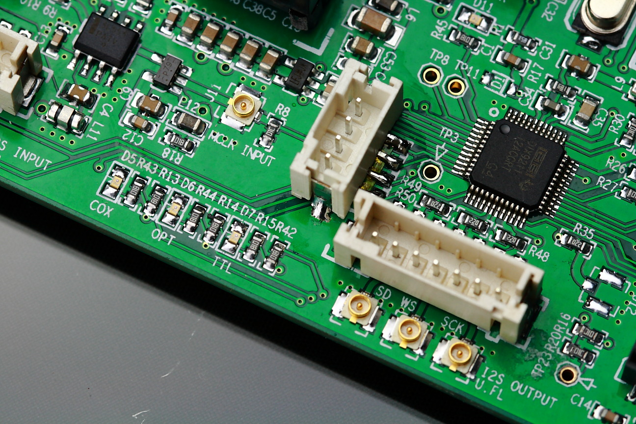

Steps to tap connector header to the reserved I2S input port on the S/PDIF Board

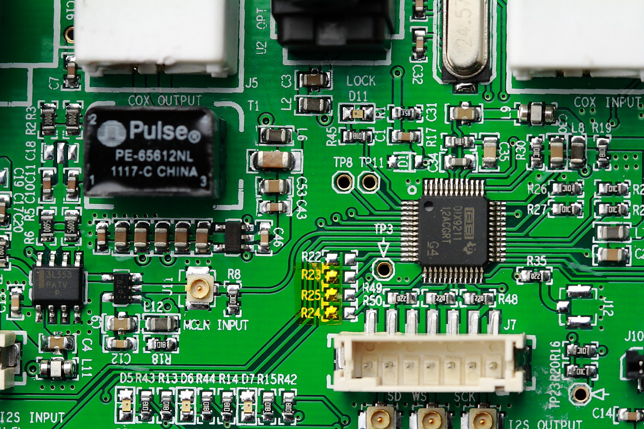

Step1: Remove R22, R23, R24, R25 from PCB. SMT soldering station is recommended tool, but normal solder iron is still OK.
Setp2: Cover the GND pads of R23, R24 and R25 with fine cut high temperature tape to avoid signals short to GND.
Setp3: Solder the 4P SMT PH2.0 header, Pin1 (WS) to R24 signal pad, Pin2 (SD) to R25 signal pad, Pin3 (SCK) to R23 signal pad and Pin4 to both R22 signal pad and GND pad,
Step4: Cut the solder mask paint beside the both GND pads of the header appearing small area of GND copper plate, please be careful no touching any other circuit route.
Step5: Solder the support pads of the header to the appeared GND copper plate. Solder iron with higher power may require. For enough support force, applying compound of strong glue (such as epoxy) is highly suggested for double support.
Step6: Make an I2S cable to introduce an additional I2S input source.
