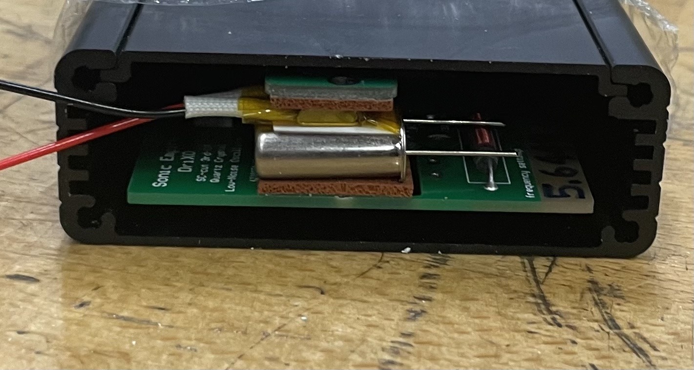

Hi Ian,
I finally got the time to assemble your latest goodies and i‘m a little bit bummed….
The oven kit doesn‘t fit the larger SC-cut crystals. 😬
The too small mounting PCB isn‘t really a problem, but you can’t fit both heater elements when you use the hammond case unless you omit one or both silicon pads, but i don‘t wanna do that.
Is one heater sufficient ? Or i could mount both heaters on top of the crystal…
What do you think?
…and i have another question: do you have s datasheet for the heater elements?

That crystal is really too big. What frequency it is? The mounting bracket PCB was design for the standard size crystal. So it doesn't fit the big crystal. You need to use something else to hold the heating elements.
One element is fine, but not as good as two. If it is possible, you can try to put both of them on top side.
Please let me know if you have update.
Ian
to be fair, that crystal almost looks to big for the PCB itself... tight near the edge for me anyway. You may be able to find a suitable, but thinner interface material at https://www.kerafol.com/en/thermal-management/

thanks for the quick reply,
it's the 5.6448 MHz crystal from Andrea´s group buy, and it was more expensive than the others, 75€ instead of 45€.
i think the PCB would be just fine when i modify the mounting, i figure something out.
and i will test, if one heater is enough to heat up the crystal properly, if not, ill use both.
and @InspectorGadget, thanks for the suggestion. there is a very thin thermo adhesive tape in the oven kit, that's not the problem,
the silicon pads are for anti-vibration and i don't want to omit that.
cheers,
Mirko
I think you'll find the product I linked would/could take the place of both. it is a thermally conductive foam. just a thought anyway, I would expect them to have something that fits the bill, but as mentioned, not the easiest place to get a small amount of anything from.
@M_Balou you have the same crystal as I was supplied with. It's quite the monster isn't it! I am currently experimenting with how best to solve this one. My current plan is to not use the supplied PCB but to wrap the heater / crystal together with tape as that is thinner and will go in the box. I'm not bothered about what it looks like as it will be inside the box!
