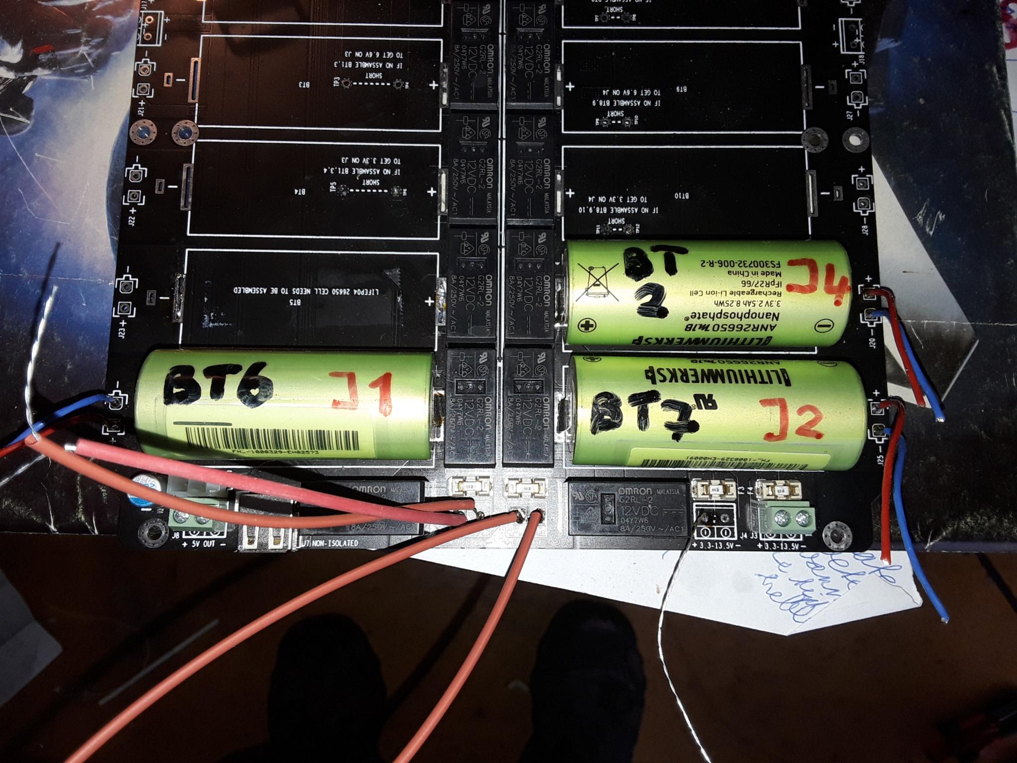

Hello Ian,
As you can see i already removed one cell but i can reinstall it again.
The blue/red kimber will be attached to the 3 UcHybrid boards.
J1 will go to the terminal J5 on the Stationpi board to supply 3,3 volt to the side of the fifopi which is normally supplied with 5 volt.
J2 will go to the 3,3 volt terminal on the fifopi.
J3 will go to the reclockpi circuit.
J4 is not used but can be used when cell 4 is reinstalled again.
J1, J2 and J3 all have an UcHybrid board so i guess J4 can be put in parallel with one of them.
BIG question which will give an improvement? Go for the cell that is facing the biggest " current drain"? Maybe an advantage if you can make the time without charging a bit longer?
In the end i could end up with ucpure but for months to come i will go for this solution.
WHERE can i found more info on how to connect the several earth connections.
Lifepo4 board is mounted with metal stand off to the metal chassis.
Greetings,Eduard

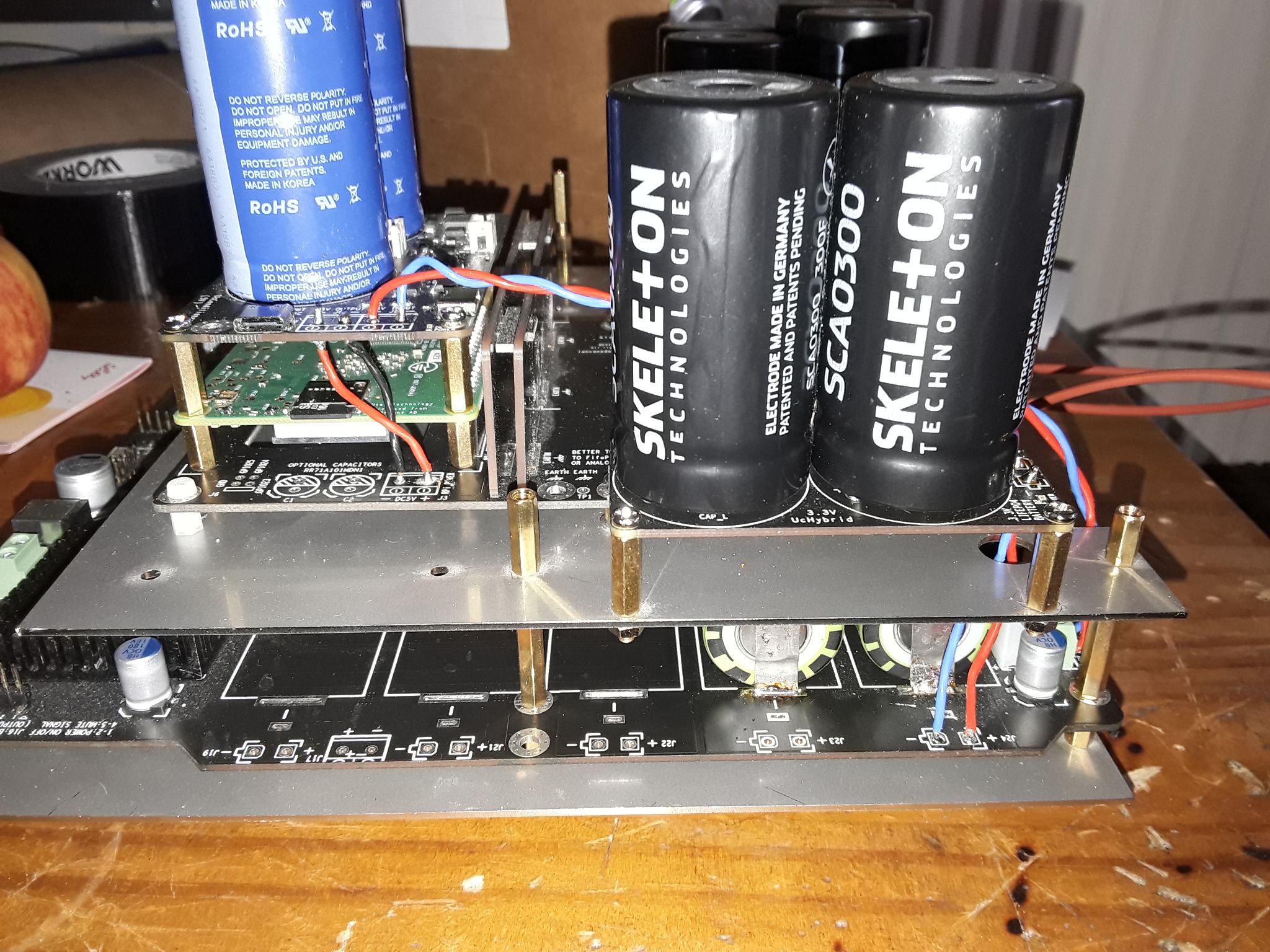

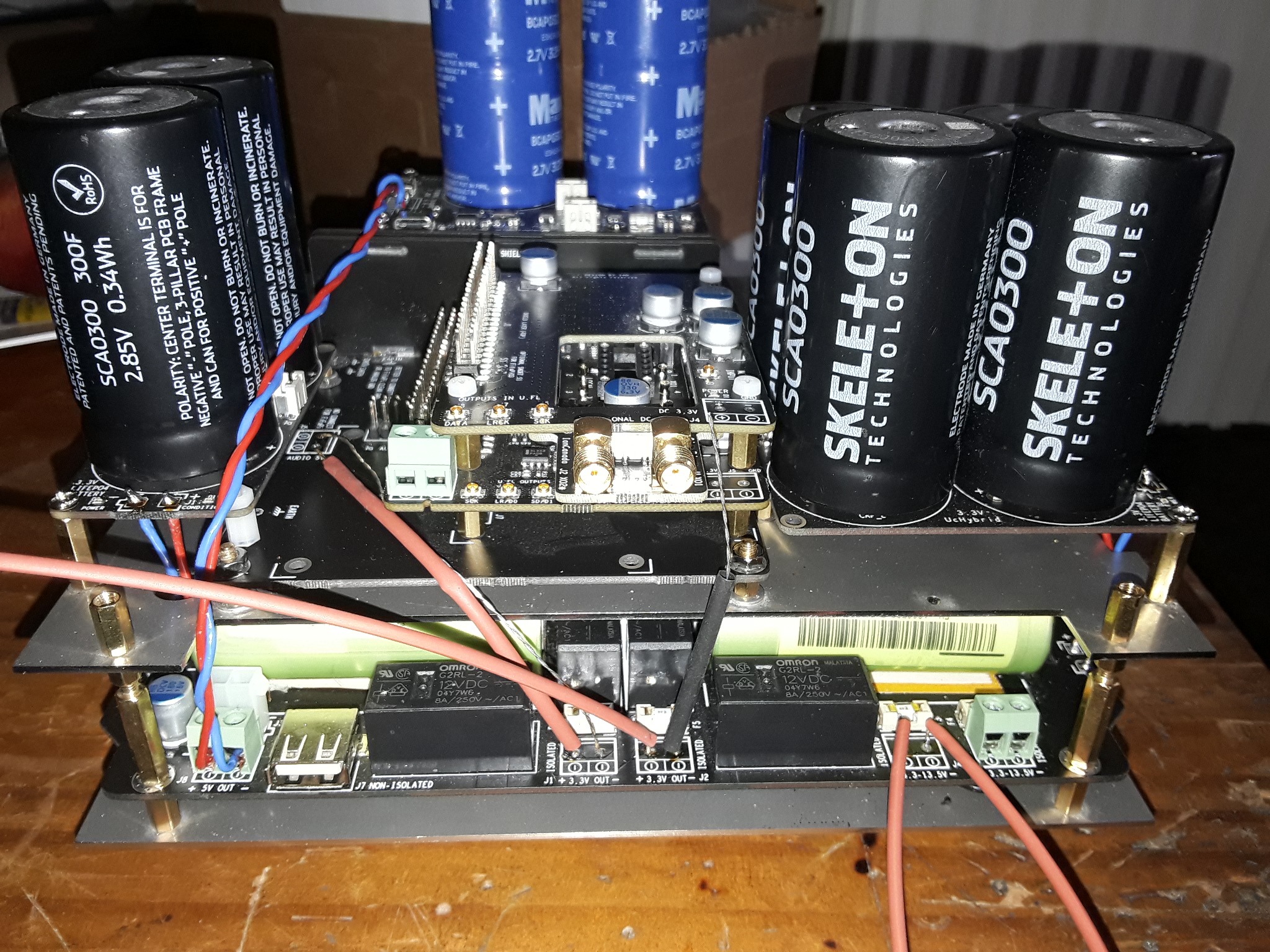

Hello,
I managed to put one extra lifepo4 cell in parallel to the one feeding the Reclockpi circuit. J4 terminal was the terminal with no UcHybrid circuit connected in parallel so the closest one was J3 which is feeding the Reclockpi.
As you can see it was not that difficult to '' improve '' the connection between UcHybrid and the lifepo4 board.
The complete 'construction '' pictured in the attachment will be mounted in my DDDAC chassis in such a way that the stainless steel '' mounting plate '' is connected to the DDDAC chassis.

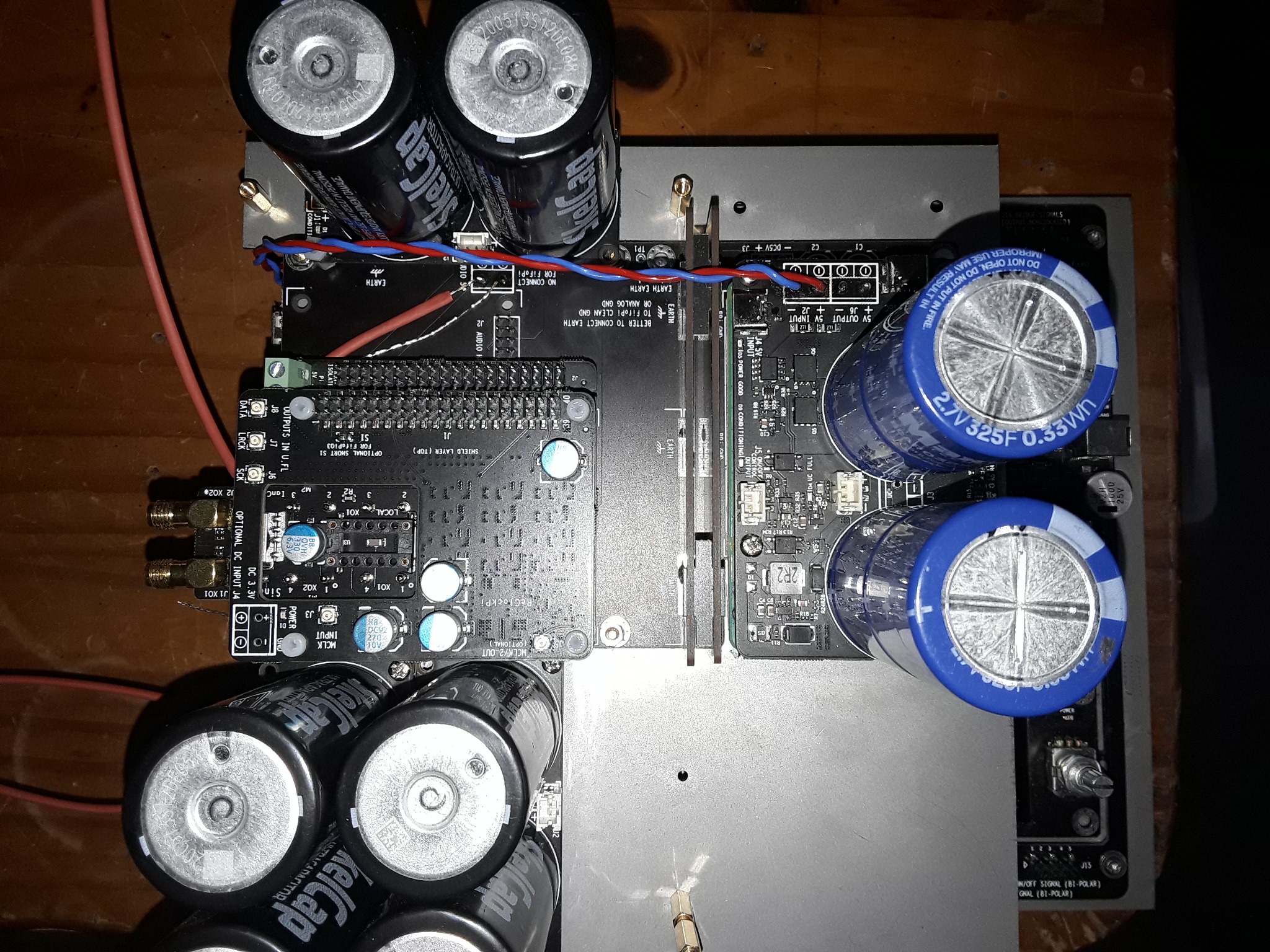

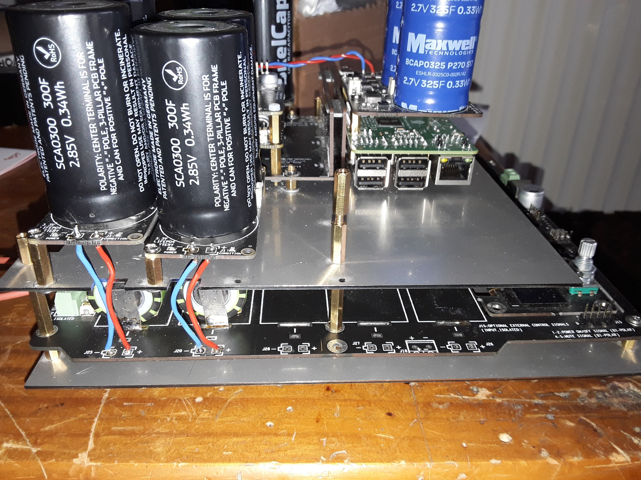

ALL the boards ( 3 UcHybrids, liofepo4 board, Raspberry, Reclockpi, Sinepi, Stationpi and Fifopi are mounted using metal stand offs. The 5 volt supply on the lifepo4 board is used for feeding the Raspberry. The input voltage for the lifepo4 comes from a well designed ( Doede) supply.

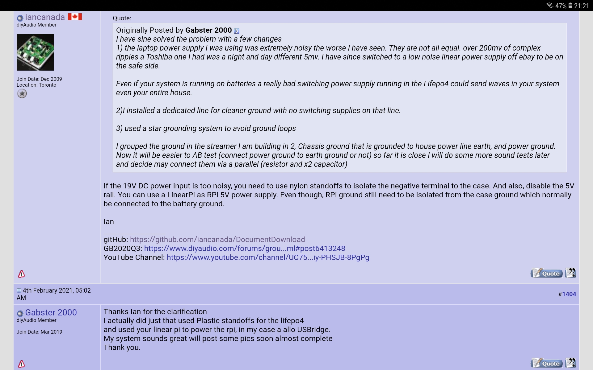

In one of the attachment you can see a screenshot ( made long time ago)that has some information telling me in my situation the lifepo4 should be mounted on isolating stand offs.
What about the other stand offs in my construction?
As you can see there is an additional stainless steel mounting plate mounted with the 4 holes at 186/104 mm hole ''pattern '' located at the ''terminal side '' of the lifepo4 board. So things are well connected.
There are several earth soldering '' spots '' on the Stationpi. Which one(s) to use and where to connect exactly?
FIRST have to get this construction working before switching to Ucpure. If things are not used according to certain '' standards '' moving to Ucpure is pretty useless i think.
Thanks in advance and greetings, Eduard
