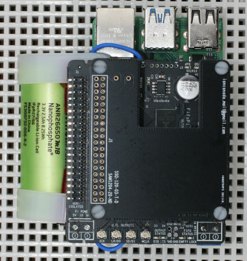

I'm a newbie too, but got my feet wet with some of Ian's products.
I am running the most minimalist Ian setup possible as I need both portable and desktop solutions.
As shown in the photo, I'm just running a battery direct to GPIO on a RPi 8GB with Ian's:
- FiFoPi Q3
- GPIO Terminator
- ShieldPi
So what you listed should be more than enough to get things rolling. But a reminder I believe you need to power the clock side with 3.3V on the Q3, so you may need to plan a power solution.
It's been a while since I thought about the architecture, so I cannot confirm on the power requirements.
What I do is I use the non-isolated GPIO pins for the non-audio related stuff like IR remote and OLED. I don't touch the isolated GPIO pins as shown in the photo as it is GPIO terminated with a ShieldPi on top.
I have no need for GPIO power 3 or Volumio so no clue how those play out. The StationPi I have not touched, but plan to work on that in October.
