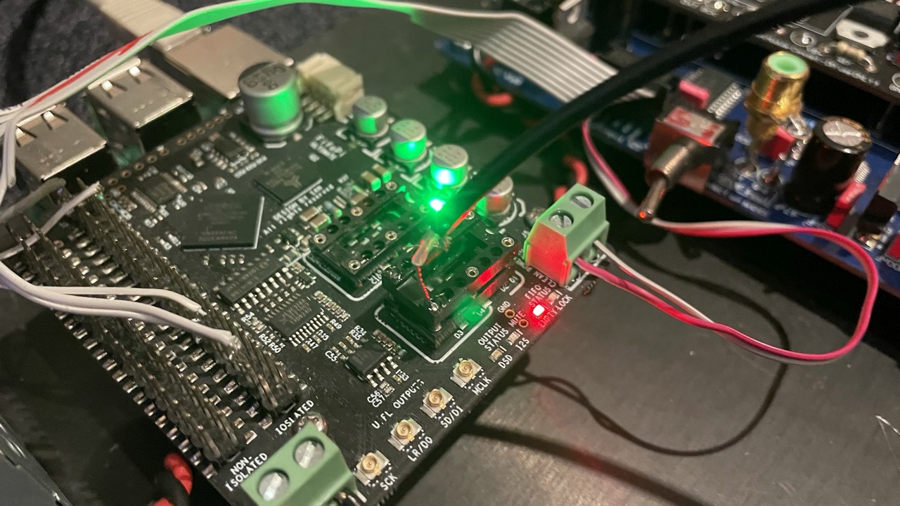

HI All,
hope this is the right thread for this.
I'm having a problem with my new stack PI4>ReceiverPI>FIFOPI>TranceiverPI
I have had it playing fine today with input selected by switch (pin 19/20 , just powering my CD selects SPDIF RCA) it was playing fine, after switching back and forth several times between inputs PI / Spdif RCA from CD, then on switching back to CD....no sound.
Nothing was changed just switching inputs.
PI plays fine and sounds great
Spdif on output --- leds on ReceiverPI blue RCA lit and blue lock lit,
--- leds on FIFO red empty lit amd both xo leds flashing alternatly.

"leds on FIFO red empty lit amd both xo leds flashing"
It means FifoPi can not figure out which XO match the input signal frequency
Two possible reasons
1. Check if XOs are fit well into the socket
2. FifoPi clean side power supply
I would suggest
1. Try different spdif source
2. Try RPi only without ReceiverPi
Please let me know if you have an update.
Ian

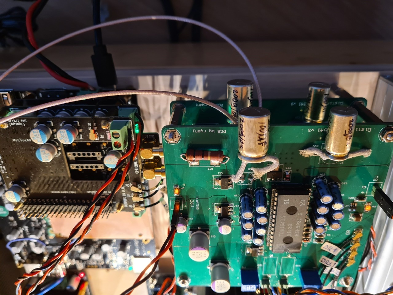

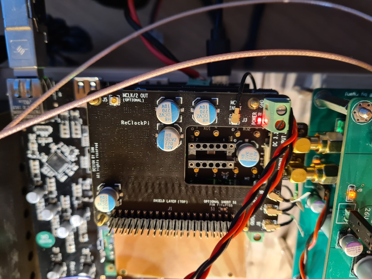

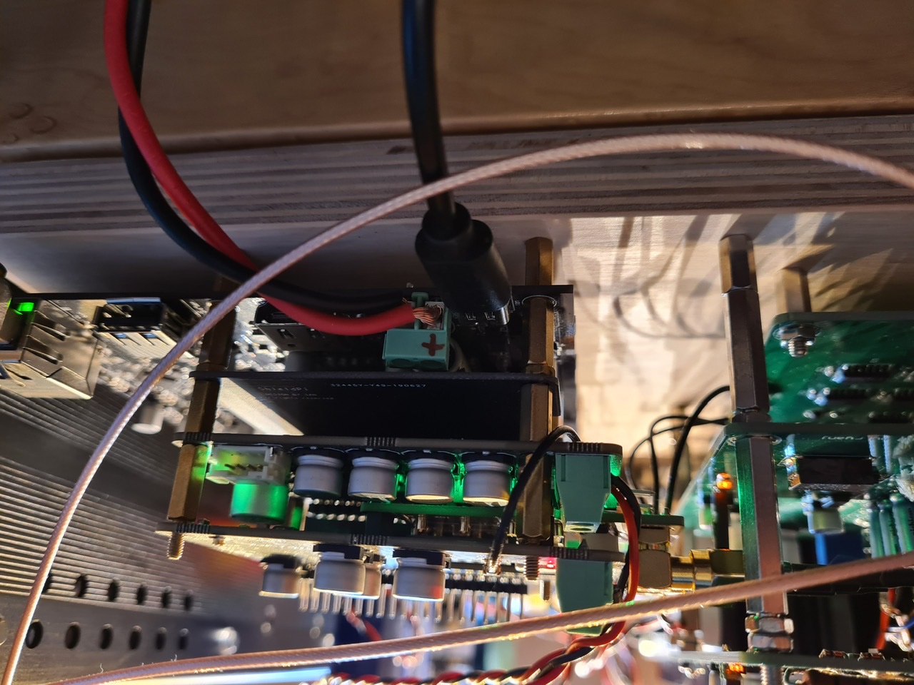

I have been doing some first listening with the same setup I have been using for all the clock tests. This is not the top-top-top possible version of a setup. The idea behind is, that also in a somewhat more normal DAC situation things should make a difference (or not)
I will write some more on my Blog Site later, but just wanted to give this first impression. Which of course is my personal experience in my system.
Long story short, besides the mechanically benefit of the SinePi versus the sine-square board from Andrea, it also sounds a little bit more spatial and let the instruments and voices tone a tad more natural. I have been going back and forward several times and it was recognizable on different tracks. The difference is small. I cannot repeat enough that this is not about high-end versus shower radio. Both are fantastic and I could easily live with both. Like so often, if by some magic the sine/square converters would be changed without me knowing and I would listen to my setup a few days later I most likely would not jump up like "what the heck happened !" but instead just enjoy the music 😛
But as it is in our hobby, if in a direct comparison you lean toward option XYZ, you just let that option sit in the final setup and take any further tweaking from there. And that is also the case with the SinePi. Now it is there it can stay.
Some pictures of the setup. As you can see I made a poor mans A123 Battery supply with the EATON Ultracapacitor Bank to power the Andrea 5.6MHz clock (In the background you might notice a Neutron 3 11MHz clock - in my blog later more)
I could not yet try if there is a cross influence when the 6,1MHz clock is connected to the other SMA connector, for the simple reason I cannot get the 6,1MHz clock to work. Andrea is already trying to help me out (Thanks for support Andrea !) so hopefully that will be tested as well soon.

I also mounted the sinepi into my new dac. It is too early for me to compare the differences because I am running a complete new dac since a week, so everything sounds different.
The mounting is certainly more stable than the doublers from Andrea, especially with the reclockpi on top it is fixed quite well.
I just want to let everything, including the sinepi, run in for a while before I judge the performance. But I already can say that the sinepi does not seem to hold anything back as the sound is already very involving!
The setup is as follows:
-Allo Usbridge Signature.
-shield
-fifopi Q3
-sinepi
-reclockpi
Power to fifopi-sinepi-reclockpi is by 3,3v Linearpi and UcConditioner.
The I2S data is fed to an I2S-SIM converter that also makes balanced datastreams for each channel to be used by 2 balanced TDA1541A dacs, the IV conversion is done by Sowter 1465 transformers with the IV resistor on secondary side.
I will report my findings at a later stage!

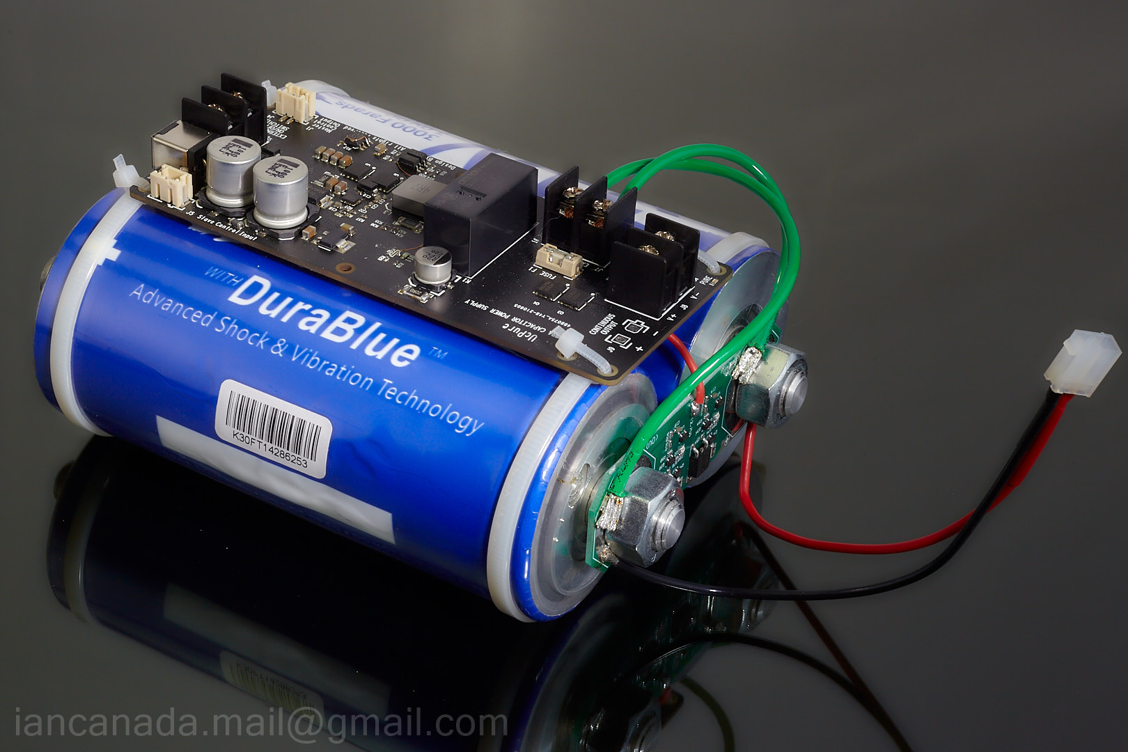

I have one thing highly recommend to you which the is 3000F ultracapacitor power supply for SinPi/FifoPi clean side.
You can just simply try a 3.3V pre-charged 3000F pair as FifoPi clean side/SinePi power supply. It can last at least 5 hours before drop to 3V.
I believe you will have a new surprise. The ultra capacitor power supply won't disappoint you.
Or, for a well designed pure ultra capacitor power supply, you can wait for my UcPure (in default 3.3V configuration). I'm trying to make it available soon.

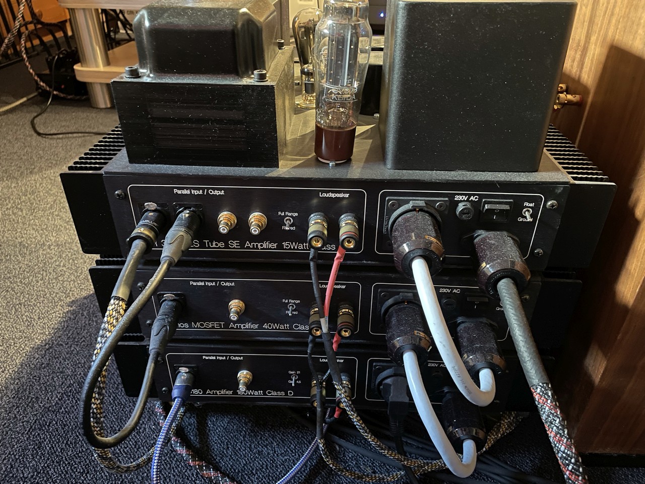

sure, here you go:
After the DAC the signal follows:
Preamp: Cleo7 (Tube amp Mu stage with 6N30P) Built by me - see my blog site
3 Amplifiers (first two designed and built by me):
KR 300B XLS SE amp for all above 200Hz - passive 12dB filter - 15 Watt
Tumos class A Amplifier for 0-200Hz - passive 12dB filter - 40 Watt
Subwoofer amp (UCD 180Watt) till 60 Hz with 48dB/oct: Behringer digital cross over compensating bass fall off in closed enclosure - Sub goes down straight till 25Hz
Speakers "Gydinel" (see DDDAC 2000 vintage website for project description) are a kind of Avalon Sentinel clone with Ceramic units from Thiel and their diamond tweeter
see some pics below (I just realize it is time for some dusting off 😀 )

Your SE tube amplifier has XLR input. Is it with a balanced tube input stage? How about the Cleo7? Also balanced? what's the circuit? BTW, the 300B tube looks very special, higher power?
Is each speaker drove by three amplifiers?

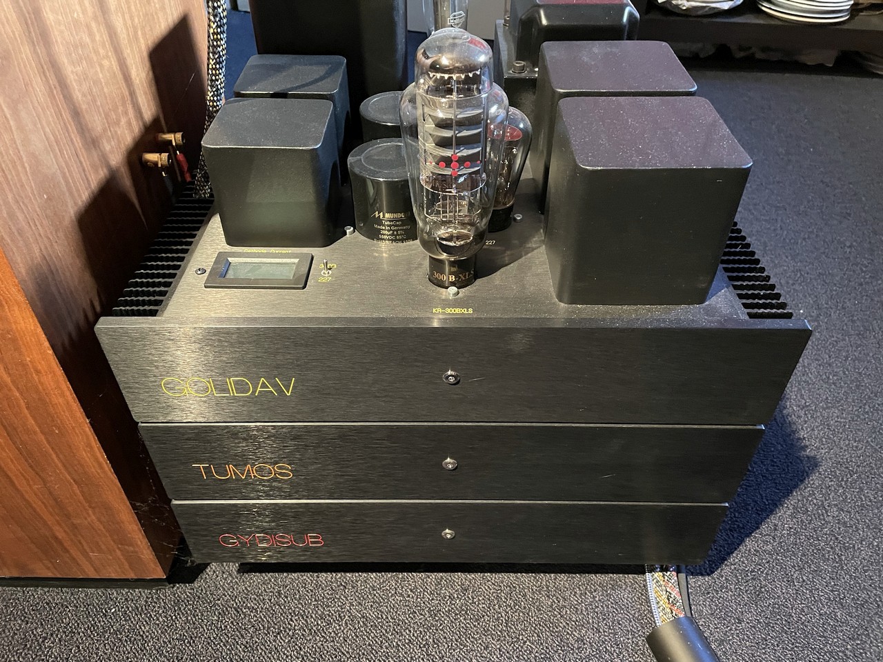

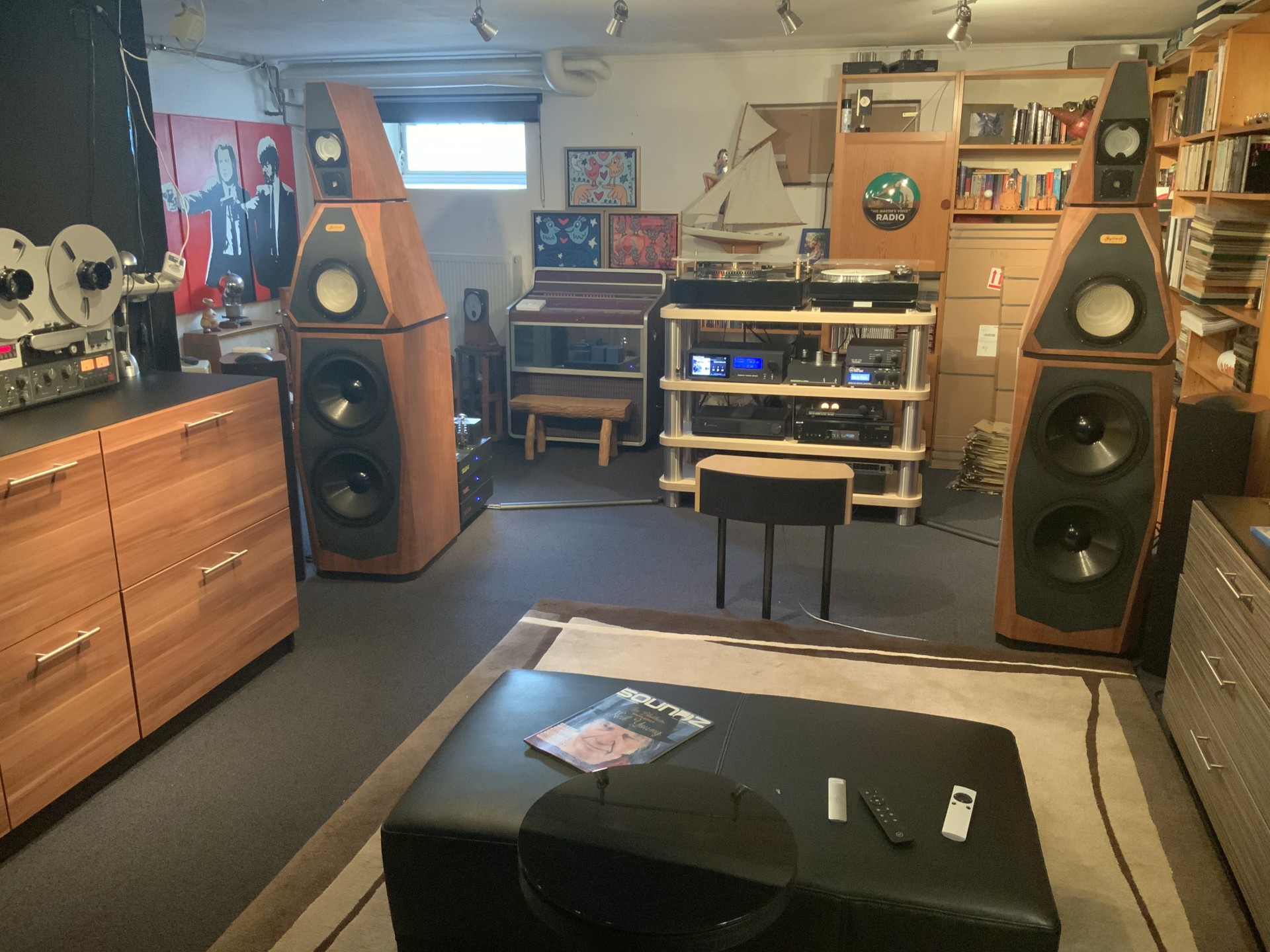

sure, here you go:

Hi Ian,
no it is all single ended. I did play with the idea, but balanced in tubes is a lot of extra stuff (and money)...
so what you see is my consistent signal interlinking with keeping the hot and cold signal inside a shielding. The shielding does not carry signal. So basically the audio GND is one of the two signal carriers inside the cable, which is pure silver core inside Teflon tube
This is done most practical with XLR connectors.
The circuits are all on my blog / website
but also below:
PS: yes the Tube is a special version with extra Power capabilities and sounds awsome (but extremely expensive unfortunately - hope they will be very long life 😀)
The top enclosure with the two speakers units (the mid and tweeter unit) is filtered passively by a 12dB serial filter. (Driven by the B300 amp)

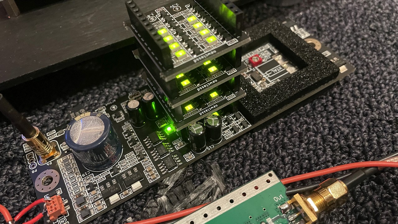

Final clock Tests?
It seems I am coming to an end with the clock listening tests 😀
Although…. Not tried the “Ian-Oven” yet 🙄
I will definitively write a more comprehensive story on my blog site, but I will be traveling till Sunday, so I wanted to not let you all wait!
In the pictures you see that also finally my whole clock scheme is ready with the two best available clocks from Andrea (5.6 and 6.1 MHz) and the corresponding 4 doublers. So now I will be able to play all tracks up to 192kHz (That is also all I have)
I already reported on the difference between the sine to square converters so this time it is the following:
- SinePi with full Andrea Clock setup
- Neutron 3 11MHz with direct DIL connector (The Neutron outputs cmos square wave)
Both are powered by the Poor mans A123 / Ultracap power supply
Rest of the man cave is also known by now I presume…
Listening impressions:

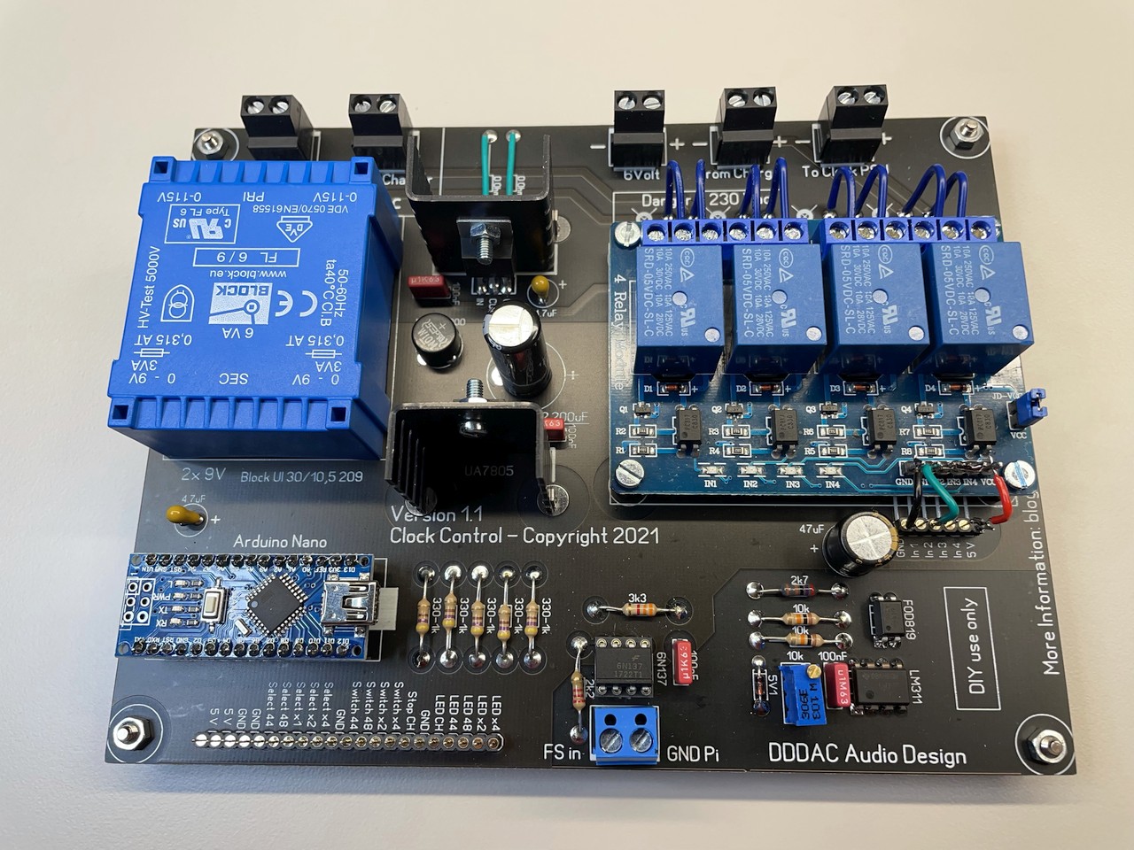

No, you wonder how this will be solved? Well I was already working on a separate chassis for the clocks where I wanted to get the max out of the base master clocks by the following setup:
Control unit with Arduino (See picture = ready and works fine) doing the following:
Charger control. If voltage drops below 15,5 Volt the charger will be connected to charge the bank for 3 hours and charge till 16.8 Volt. When by coincidence, listening takes place and you do not want the charger to be connected, there is an override switch.
The unit will output digital control signals to go to a switch board where the clocks and doublers are connected (PCB is in design – 4 layers and RF relays) – The idea is that depending on FS (44.1, 48.0, 88.2 etc. etc.) only one clock with one or two doublers will be switched in to the right configuration and will output one sine wave clock signal going to the DAC Chassis with the SinePi
FS will be read directly from the Raspberry PI GPIO L/R clock. Also, front panel switches will allow for a manual override and manual selection of the cloak and how many doublers
All signals are connected by Optocouplers so there is full isolation between RPI, Clocks switch board and power supplies
So, when playing a 44.1 track the doublers are NOT switched in series after the master clock
