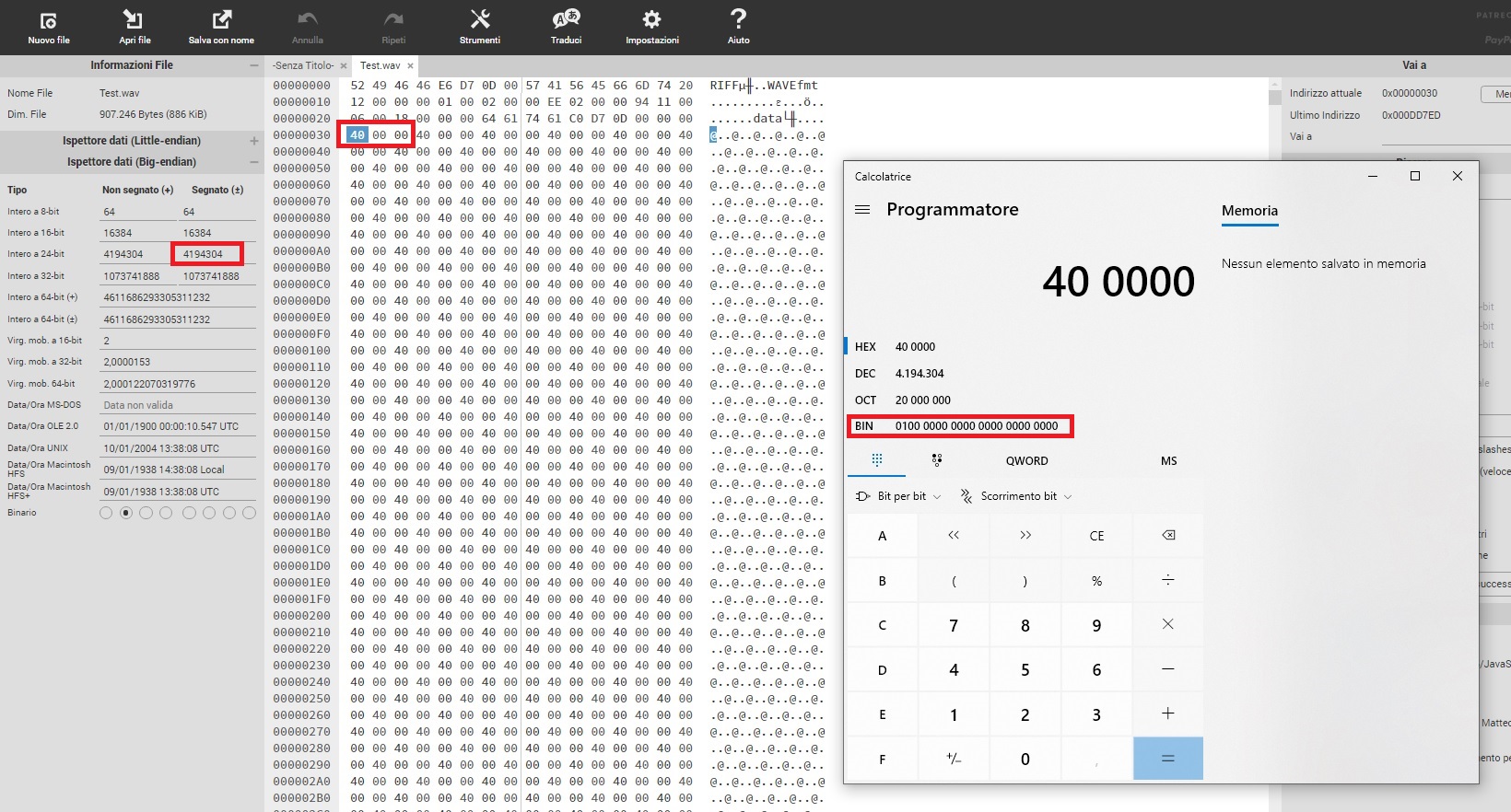

By default all of those methods are likely to fail. Windows Sound Engine will almost always resample the output stream unless certain conditions are met. WASAPI Exclusive Mode can bypass the resampler if the driver requests it (Exclusive Mode is not supported by most DAC drivers, although plain WASAPI may be supported). ASIO can also avoid being resampled, but only if the audio device is not automatically made the Windows Default Sound Device, nor made the Windows Default Communication Device. A green checkmark next to the audio device in the Windows Control Panel Sound applet indicates the device is set to one or both of the above defaults. Also, Windows may automatically reassign a device to one or both of the above defaults if the device USB cable is unplugged then plugged in again later.
How do you confirm resampling is actually taking place?
There are two ways I have used to tell if resampling is occurring. The first was that a sound card I once had came with an app that showed the actual sample rate it was receiving from the driver. The other way is by listening. There have been a number of times I have noticed my custom AK4499 DAC sounded more distorted than normal (although I suspect many people might not notice the effect at first, and some dacs may obscure the effect with their own distortions). When I notice a distortion increase has happened I start thinking about what could be causing it, and at some point decide to check Windows sound settings for the device. That's happened enough times so that checking Windows is usually the first thing that gets looked at.
Maybe you are right.
I have just connected the oscilloscope at the output of the USB to I2S interface.
I have generated a 24 bit/192kHz DC sample at half the max amplitude (4194304), so only the MSB should be switched on (binary data attached).
When I play the sample by the Windows app the sample rate is reduced to 48kHz and several bits are on.
That's incredible, one has to get crazy to play the most simple signal (DC).
But this is the world of the Lord of the Blue Screen, the one I avoid to name.
I shouldn't have expected something that makes sense.
