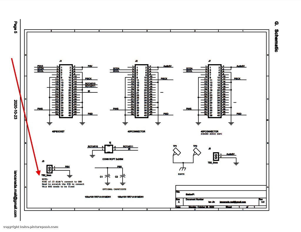

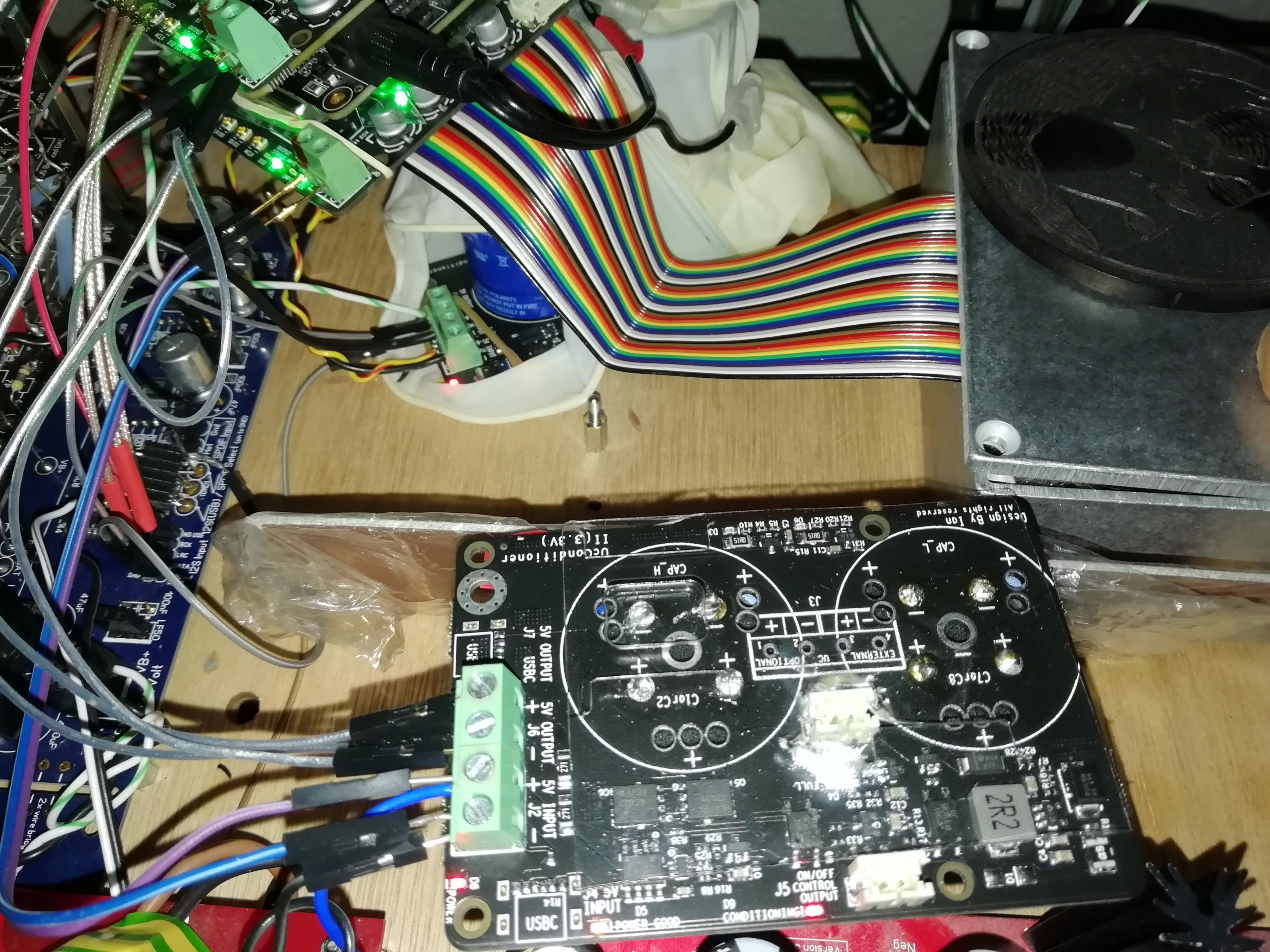

To rule out that the Mute problem is power supply related (ground), I removed the separate RPi power supply from the RPi power connector on the StationPi and also connected it to the 5V connector of the LifePO4 Power Supply, conclusion is that the problem is not here and the Mute problem still exists.
@A123,
5V is Powered via stationpi, output is from Linear power supply Supported By supercaps going into FiFo via GPIO
Wallmount Raspberry powersupply (5V) is used to feed J3 on stationpi, recommended by Ian in stationpi manual and in this way completly isolated from 5V clean side.
First 3.3V battery supply with super caps is powering FiFo clean side.
Second 3.3V battery supply with super caps is powering transportpi with onboard ldo bypassed, IN/OUT is bridged by wire.

@A123,

My mind is so focused on the portable project and not giving any attention to the MKIII/StationPi ATM so it gets confusing on the power requirements, so I might end up confusing others... Once I start back on the StationPi project, I should be back in focus.
If you look closely @holco 's StationPi photos, it's close to how I plan to implement once I start up the StationPi project:
