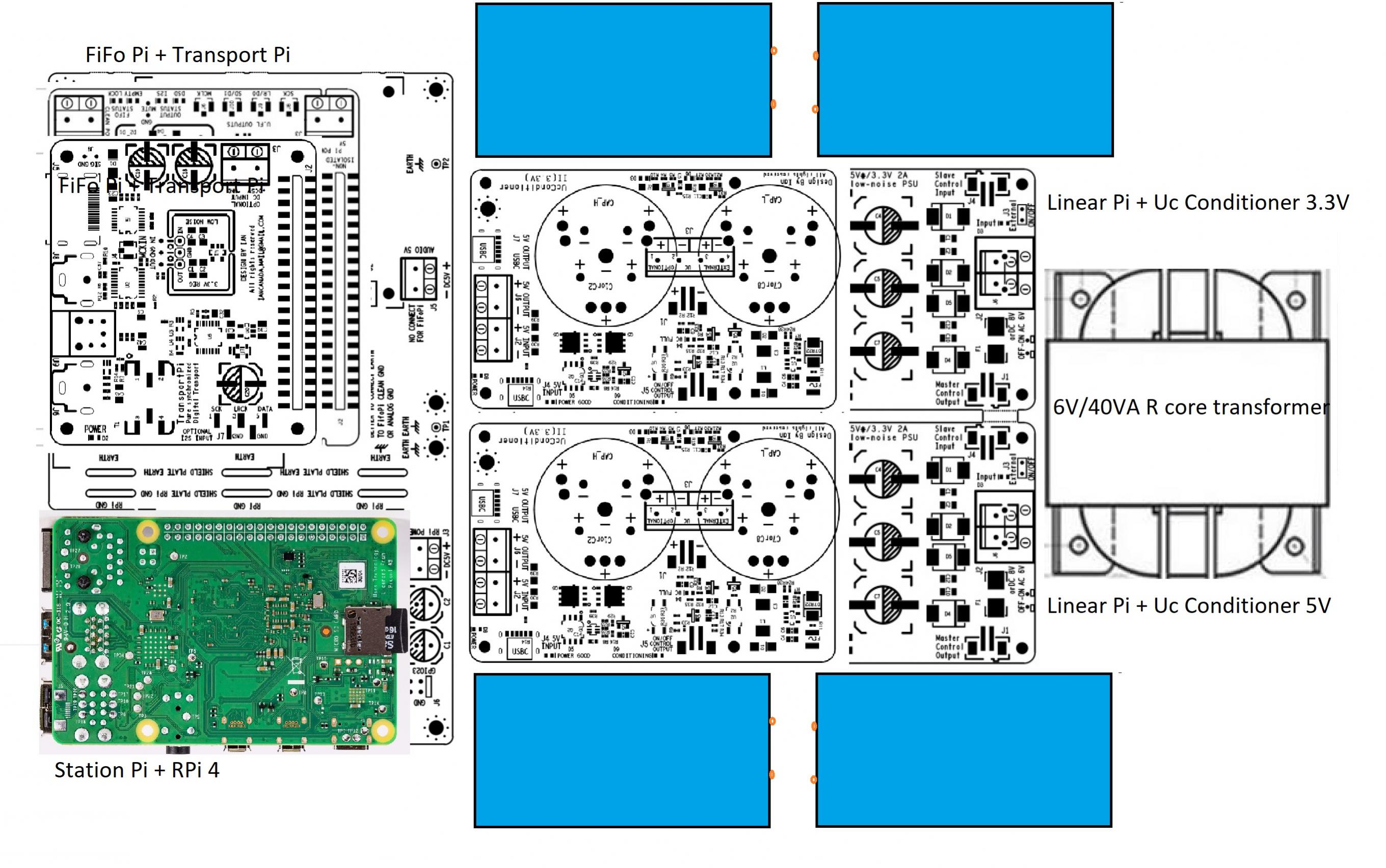

Using your video, I have made a layout using the Transport, FiFo, Station, Linear with Uc Conditioners, and an RPi4 and keeping the height to less than 50mm (moved the capacitors off the Uc Conditioner boards).

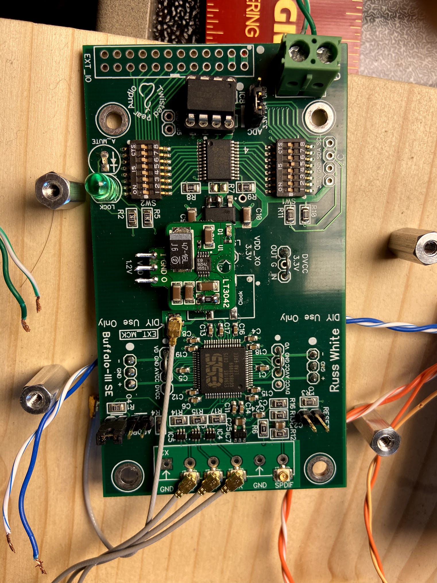

Is this a synchronized setup? I saw your post previously:
Asynchronous I2S FIFO project, an ultimate weapon to fight the jitter
Which shows your synchronized setup which I used in the previous post indicating:
Sync mode for BIII is:
SW1 (X os off, 0 is on)
X000000X
SW2 (X os off, 0 is on)
X000X000
Can you please confirm that this new picture is for async (or for both asynch and sync)
SW1
0000X000 (X os off, 0 is on)
SW2
00000000 (X os off, 0 is on)
Other than the connections and dip switch settings is there anything else that needs to be done with the conventional BIII and it strident regulators and clock for async mode?
For Sync mode is there any modification other than unpowering the clock on the BIII?
Once I have this understood and working in both modes I will put together a FifoPi/BIII step by step for everyone to be able to refer to.
Many Thanks!

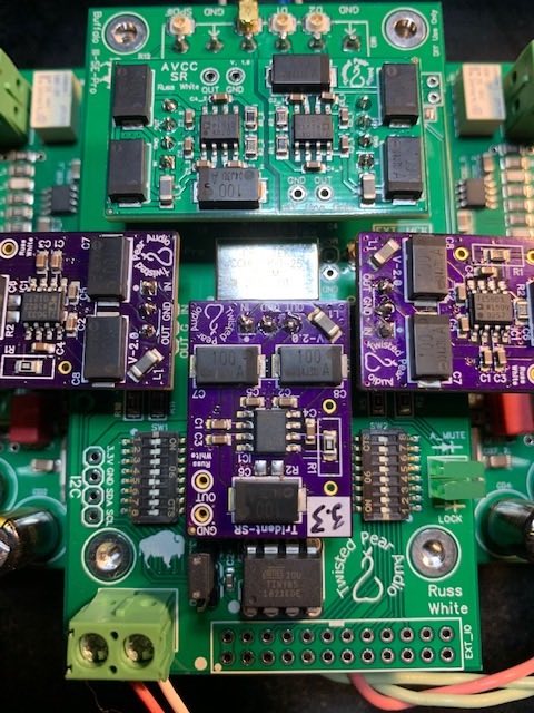

BIII SW2 inversion
ON configuring the DIP switches on the BII board according to Ian's photo it turns out our SW2 on the respective BIII boards are mounted differently. I suppose the function is the same despite the different numerical orientation. On is still On etc... Perhaps Russ could weigh in on this. If anyone has a comprehensive connection guide for these two devices assistance would be appreciated.

@Navin
Your draft looks great! You did good job. Looking forward to your update.

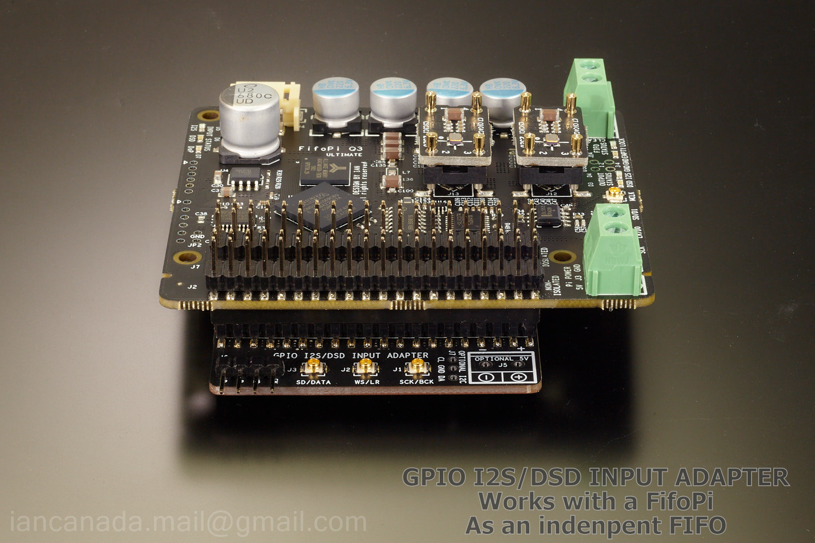

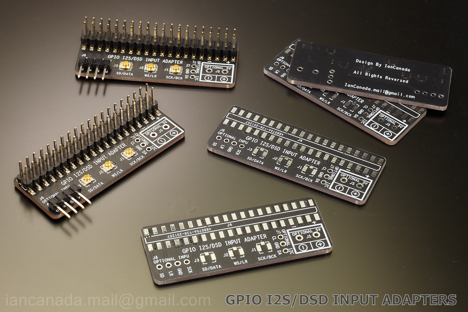

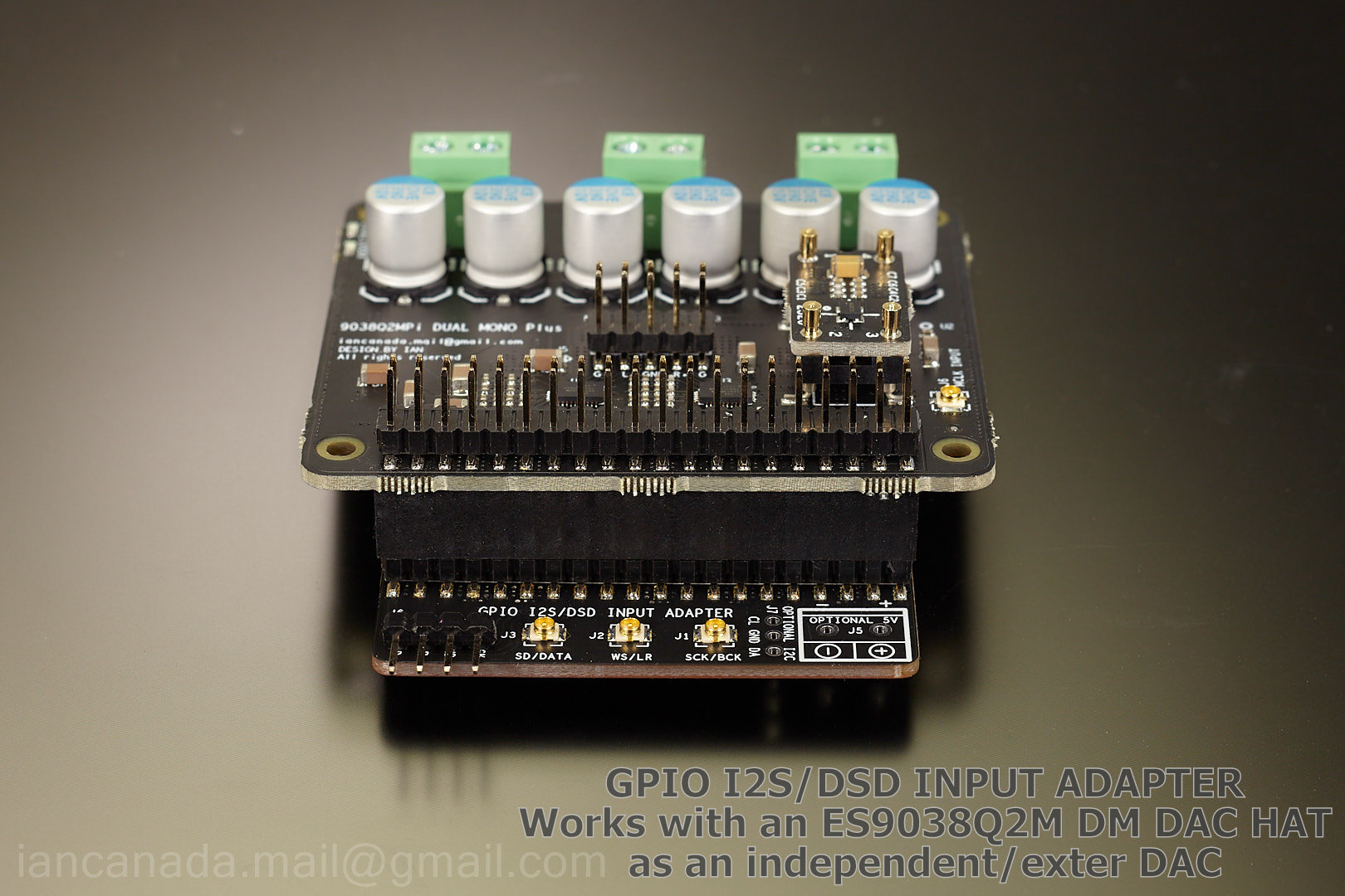

GPIO I2S/DSD input adaptper
Some community members suggested me to design a GPIO I2S/DSD input adapter.
So here you are.
With this input adapter, a FifoPi can be an independent Fifo and a DAC HAT can be an independent/external DAC.
I have 10 extra of this input adapter PCBs. I can share all of them as a KIT with community members for free evaluation. Including a PCB, a GPIO connector and 3 u.fl connectors. Please make sure you can do the SMT assembling by your self.
I'll post details of apply in my GB thread.
Good weekend.
Ian
SW2 on Ian's board is backwards. Yours is correct.
