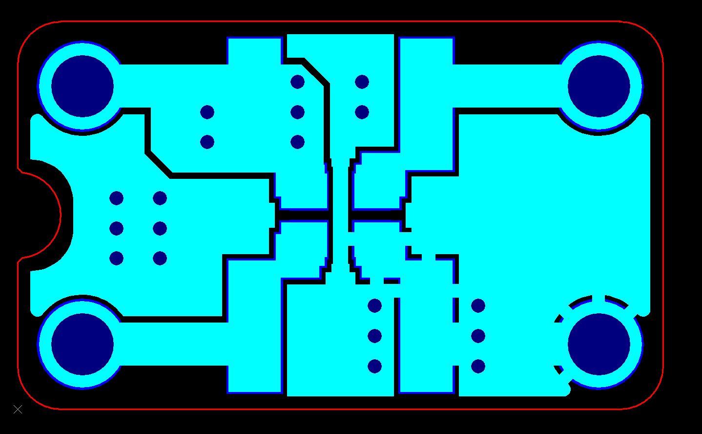

Re-designed XO adapter PCB compatible with many SMT XO
The old adapter PCBs were run out. I designed a new one, which could compatible with most popular SMT XOs, CCHD957,CCHD950, 7*5, 5*3.2,3.2*2.5,2.5*2(NZ2520S).... Each KIT of GB II will still come with one for free, as well as those who didn't get from GB I.

Ian: I asked in another email amongst other stuff, how to work out the values for the 2 R or C? used on the underside of the XO adapter board?
yeah the vectron stuff is good, not always available as an import item without special permissions if I remember correctly
Usually I use 3 MLCC, 1u(0805), 100n and 10n(0603). However, If the oscillator comes with internal decoupling capacitors, you can leave them open.
ok fair enough, i'm just not always keen on adding arbitrarily chosen decoupling cap values as a one size fits all thing at these speeds and wondered, if I could borrow some scope time what I should be looking for. I figured they were just decoupling positions, but also wondered if they may have something to do with pull up/down resistors for logic levels with some clocks
I left them out for the crystek, as I figure they would probably do more harm than good given theyve already got well chosen cap values inside
have they got np0 in 0603? not easy to find many values in 0805, not as easy as 1206 anyway. might be a good position for one of those murata CLC networks
