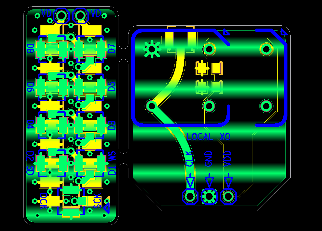

I forgot who gave me this suggestion. But with running at sync mode, my own experiencing shows current BIII input port and the local XO adapter still have space getting some improvement for the last drop of juice 🙂 . So I designed this PCB KIT. Actuall two adapters integrated together.
One is the input adapter. I put a 20P SMT head on the bottom side to get connect with B III, on the top side, there is a group of U.FL connectors which could improve the signal quality. For stereo I2S aplication, only three U.FL socket are required. Because at the sync mode, ESS9018 still very sensitive to the input I2S sck, improving the signal transmitting quality is very important.
The other one is the local clock adapter. It will be soldered vertically right above the local clock position by a right angle 3P connector pins. If you put a local XO (make use of the 100Mhz CCHD950 for example) into the socket, ESS9018 will run at async mode. or, If you want to run the sync mode, you just need to remove the local XO from the socket and connect the MCLK cable from FIFO clock board into the U.FL socket on the adapter PCB. So, you can switch between the two mode quickly to enjoy both, or doing some listing compare.

Great Job. Although I managed to solder the U.FL sockets onto the BIII PCB, but all three sockets are broken when I tried to disconnect the cables.
One suggestion, is it possible to modify the PCB so that it can switch between two I2S source (e.g. FIFO + WaveIO)? Or I can use the Sidecar with two PCB?

Could you give any details on how you're terminating that i2s from u.fl into the pin female pin header? Have you had any thoughts on how to improve the situation at the DAC end of that interface? I've had thoughts about making a small pcb to convert pin headers to u.fl sockets and would appreciate your thoughts/experiences. I guess there is probably a bunch of other people in this thread looking to interface this board to DACs that don't always have ideal methods for connecting the i2s signal.

Thanks hochoperper, I remember now it was you who provided this suggestion.
At beginning I thought it would be very hard to achieve. But when I realized this problem has to be solved, I got an idea mounting the header and u.fl on the different side of the adapter. It seems OK. I will make some prototype PCB the next.

Ian, thats great mate, any chance of putting the 2.54mm positions in between? i've been wanting to make exactly this for interfacing with titan, which has RJ45 or strip header. actually looking at it, the BIII uses 2.54 strip headers now doesnt it? I would use this for interfacing titan, which has RJ45, or strip header
bad idea, high speed switching is not a simple task and will ruin performance for both devices. you must do this actively, passive switching will ruin impedance terminationIan
Thanks for your advice.

I also want to switch between two sources and I was thinking about these options (in this order):bad idea, high speed switching is not a simple task and will ruin performance for both devices. you must do this actively, passive switching will ruin impedance termination
1. use one of Omron's G6Z high-frequency relays with 50ohm impedance
2. Use two Potato semi PO74G125A buffers and switch by their OE pin
3. Use a high frequency bus switch like PO3B3257A
Which of the above or else would you recommend?

2 I think, with termination on the input, well I cant advise on 3 or 1as I have no experience with them, though 1 sounds interesting, I would worry about linearity, but i'm a bit of a 'worry wart'
