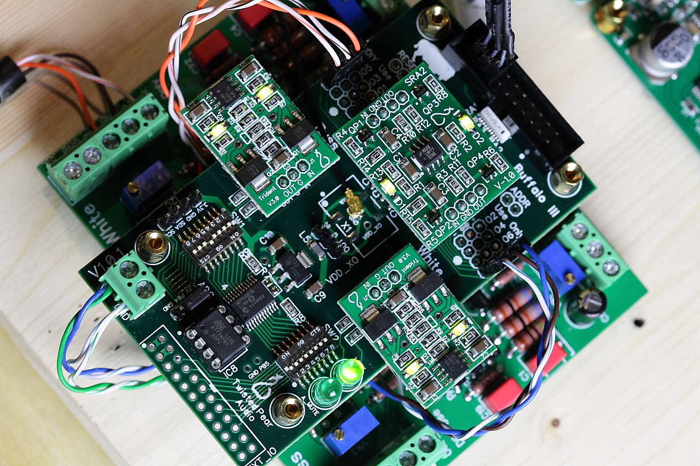

Successfully running ESS9018 (Buffalo III) at synchronized mode
I hooked up the FIFO KIT and B III into synchronized configuration yesterday. It runs great without any problem. The setup is easier than I thought. Please see the attached pictures for details(find the names for the meaning of the pictures).

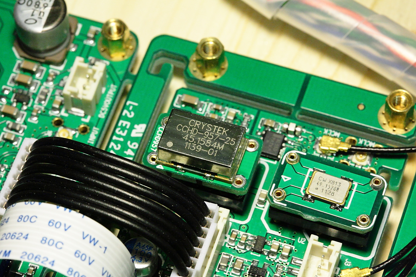

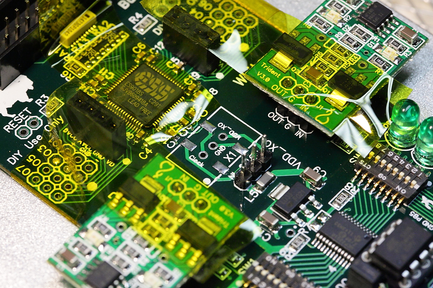

Step1: Remove the CCHD950 OEM 100Mhz local oscillator
After the CCHD950 was removed, I found TP has already left a backdoor for the sync mode. There is a 3 pin socket underneath, GND, VDDXO and CLOCK
Tips: protect the surrounding component with thermal tape and heat the back of the PCB first to avoid any possible damage.

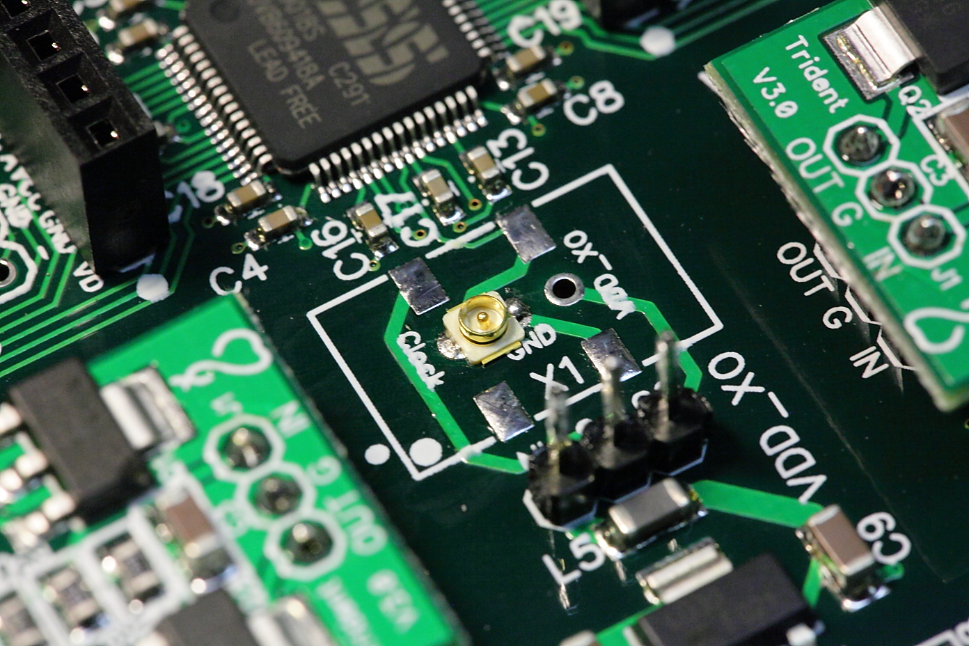

Step2: Assemble a U.FL socket
I still think U.FL socket is better for the clock signals, so I just soldered it on the BIII board. Signal (MCLK input) to CLOCK and shield to GND. However, using the 3 pin dip connector will make it easier switching between sync and async mode, so later on, maybe I have to give up the U.FL socket and switch back to 3 pin dip connector.
Step3: set up the Dual XO Clock board into double speed mode with 45.1584 MHz and 49.1520 MHz oscillators.
Please see the attached PDF guidance for details. Please be notice, jumpers have to be set exactly as what directed in the doc. Actually I finished this document 6 weeks ago, but I have to confirm it by myself before I public it.

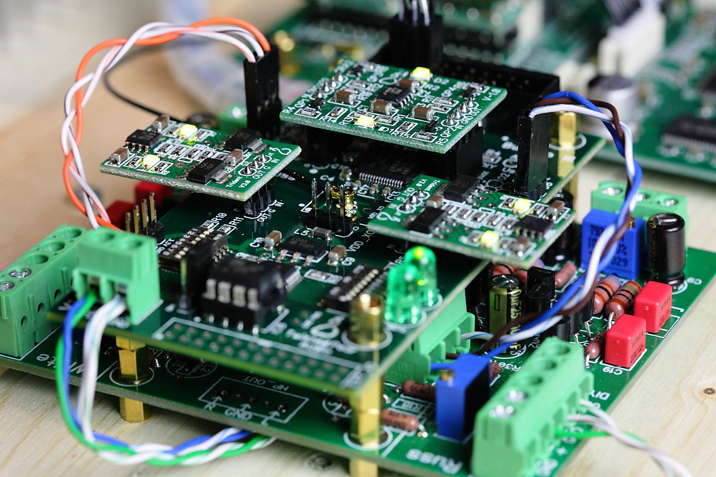

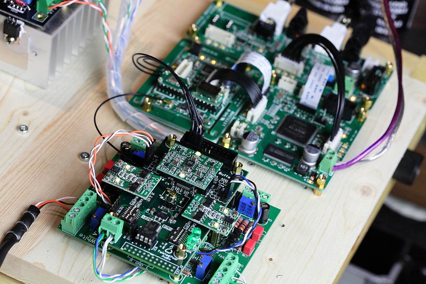

Step4: connecting the cables
I2S output to I2S input, MCLK output to MCLK input.
Step5: Enjoy the music.
It runs right away without any hesitating. The LOCK LED keeps lighting all the way indicating it synchronized with the input I2S stream unconditional even I set the bandwidth switches to 'lowest' and run music at 192KHz from an USB.

I added an additional piece of heat sink and make it facing up. The stable working temp on the surface reduced from 60C to 53C J.

good job! yeah no magic to sync mode, you just need the right clock/i2s source.
guess i'll still be sending it back for quad mode setting
