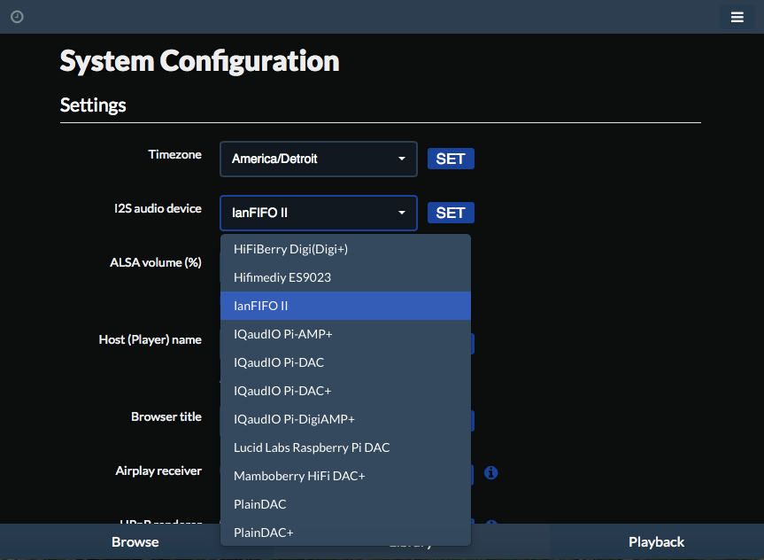

Moode release 2.5 (Jan 2016) includes selection for IanFIFO II 🙂
I'm planning a 2.5 test release in December. Download available at moodeaudio.org
