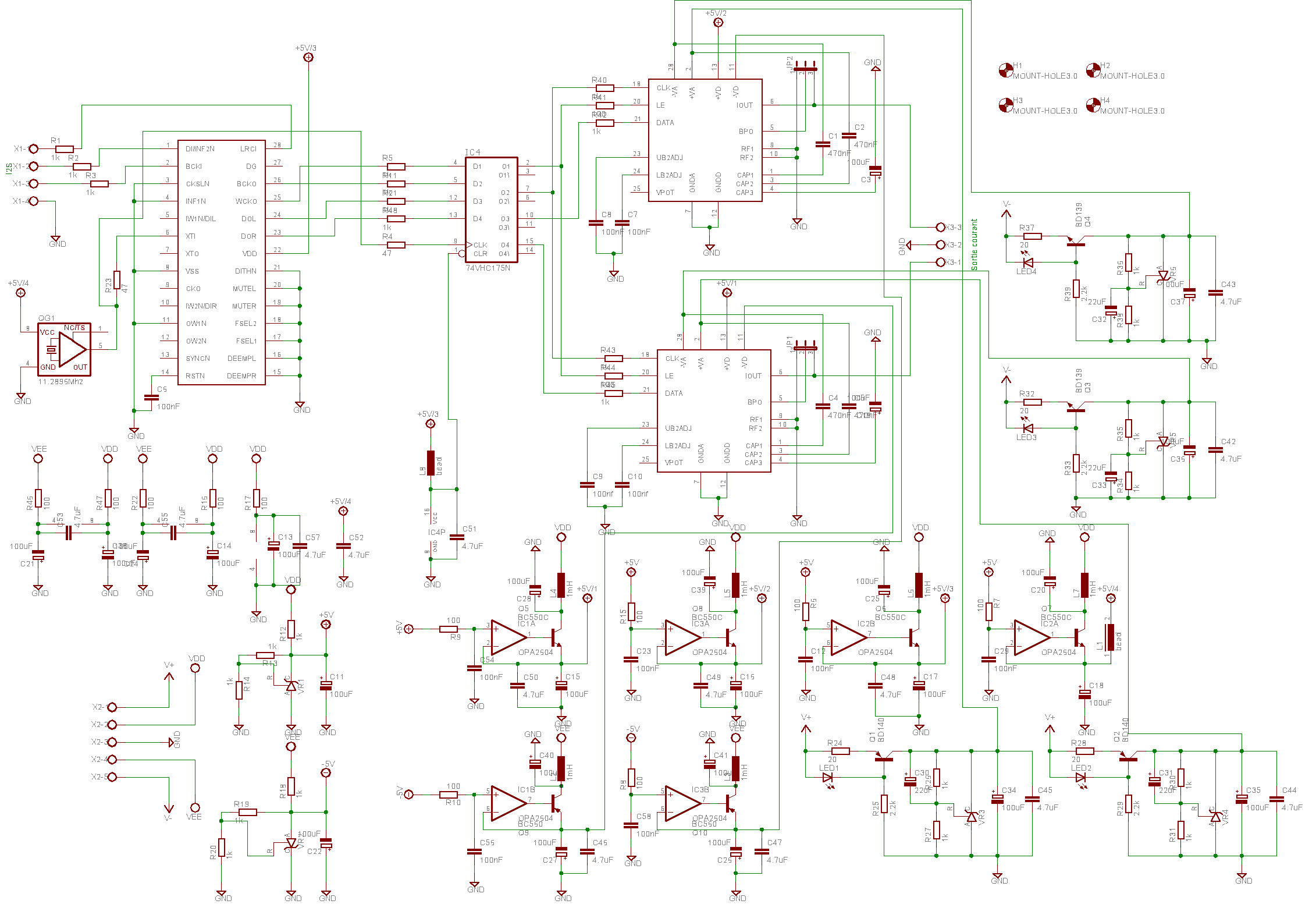

I would like to order FIFO kit, but I'm a bit confused.
As I said I want to feed FIFO kit directly from CD PRO I2S, then I would like to take I2S output and MCLK and feed digital filter NPC SM5842.
You tell me that SM5842 do not accept I2S format data, while Rregal in a previous post said that it can do it.
I found on the web the attached schematics that interface I2S with 5842, so I believe you're right.
BTW do you think that I can feed 5842 using this schematics?
If yes, do I need FIFO board only?
What frequency oscillator?
Anyone can help me?
Thanks in advance
Andrea

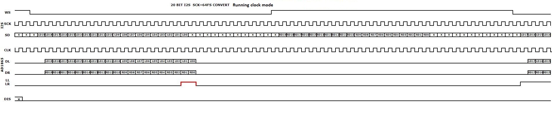

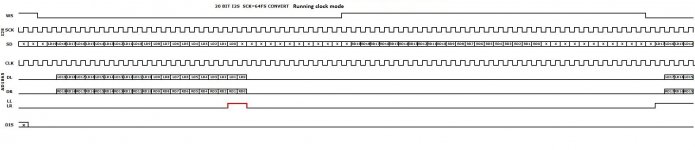

I attatched the updated timing plots, taking example for both AD1865 and PCM17xx. Let me know for any problem.
*please don't care about the LL,LR signals at the next word, I forgot changing them on the plots.
They look good to me.
I don't want to split hairs about stop clock mode of PCM17XX but during conversion of a PCM1704 the clock will still run. To have a non-plus-ultra converter another stop clock timing is needed where the bit clock is stopped 2 cycles after the latch goes down, I think.
One more note: for the running clock mode I think the attached timing is good for all the mentioned DACs. What do you think?
I almost forgot I would also need and inverted data signal as the single ended preamp after my I/V inverts the phase. Nice idea to support it 🙂
Thanks.Zsolt

[...]One more note: for the running clock mode I think the attached timing is good for all the mentioned DACs. What do you think?[...]
Not sure what you mean with running clock mode. The timing is OK, if you use right justified data.
But...for AD1865 and AD1862, I really would advise to stop the clock in any case before the LE line goes low. It will improve jitter performance and would be the preferred method when this logic is feeded with left justified I2S data (as is output from FIFO).
I meant a format with a continuously running bit clock, which is the basic operation mode of the DACs we discussed so far - that's why I think we should have it.
