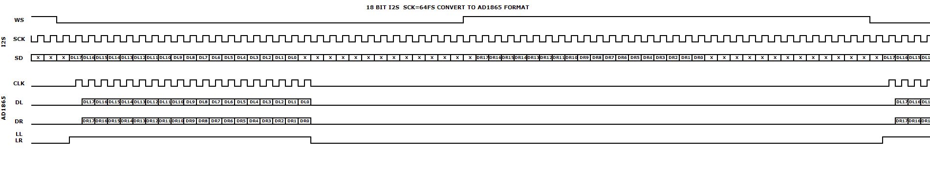

This is the I2S to LSBJ converter I'm using: linkCan you share your schematic?
Note to the schematics: the MCK divide by 2 is not needed, you can simply reclock with MCK so only 5 ICs are needed. The data lines for L and R are shared and the word latches are distinct. The actual pcb schematics I used is here: link . I removed the MCK divider from it and added a U-FL connector for the MCK. You could either do this on breadboard or I could send you the gerbers.
As you see I wasn't aware to use high frequency flip-flops for reclocking nor to comply with LVTTL systems. You should use 74HCT ICs, I used 74HC so I had to lower the supply voltage to 4V to have VIH low enough. If you need more info about this schematics/build let's move to the thread where I posted it.
I took the main idea from Eric Juaneda's decoder: link and slightly modified it.I think I'll open a thread, as I have some ideas, but with "traditional" logic.

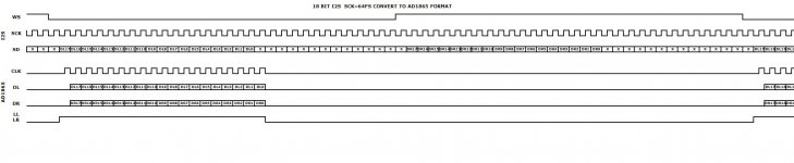

This can convert a 64bit I2S stereo sample into the preferred bit depth LSBJ format. The reclocking of Word Clock is mandatory to have everything in sync but will not degrade at all because it is done with the MCK from FIFO (as on FIFO's clock module).

It would be really nice to swap eight ICs with one CPLD/FPGA - four reclocking flip-flops would be needed anyway.
I would be happy to buy such a pre-programmed IC or even a whole kit project. Do you have in plans to start such a converter project or should I better invest in a bunch shift-registers 🙂 ?
Very good progress. What I'm suggesting is:
1. Get a really nice lock first, it will make you distinguishing the good power supply.
2. Based on my own experience, feeding batteries into the reg and feeding them directly into the oscillator (without reg) dosen't make much difference. However, feeding a ac based regulated dc supply into the reg was making big difference. You already know what I mean 🙂.
The most significant problem is, the rectifiers are actually working at switching mode. Your could even receiving that rectifying noise from a short wave radio! Fast recovery diodes are better, but still can't eliminate those rectifying noise 100%. That noise comes with very high bandwidth extending to couple of GHz, no regulator could supress them very well. Multi-order CLC filters are working, but you have to design them with carefull to catch up with batteries.
Having more fun with your project
Regard
It would convert from I2S with 32bit frames as this FIFO spits out, to the right justified data the AD1862 and ..65 needs.
AD1862 being different to AD1865 in that it accepts 20bit depth.
Bit lenght could be even switched i think.
The solution i have in my head would not "interrupt" the Word Clock line with logic, nor it would be necessery to reclock it, so to maintain the essential jitter performance as good as it comes out from FIFO.
However, we would need to tap WCK as it serves as a Flag for BCK stopping and directing into the correct channel (L/R).
So we can "oversample" via software, save the Files as eg. 192/20 (or whatever the DAC chip can accept), and play it via USB or S/PDIF. The FIFO will reduce the jitter as good as it gets, AND spit out a single format without having to take into account bit depth or whatever.
TDA1541A would not need any modification of this FIFO output, as it accepts I2S.
Thank you so much for sharing your ideas. You make things getting more and more interesting. If I did this projcet, I'd like to use a CPLD.
1. It will cover both AD1865(18bit) and AD1862(20bit), as well as PCM63(20bit).
2. Accept I2S signals with sck from 48Fs to 64Fs. left and right justified, maybe.
3. Shifting left and right data into registers at same time and stop clk after doing that to reduce noise further more.
4. Launching left and right channel conversion at same moment to eliminate the phase difference.
5. All signals will be re-clocked by a high-speed low jitter flip-flop with the FIFO master clock before feeding into DAC.
6. Support DAC working at both stereo and mone mode.
I attched the possible timing waveform (take AD1865 for example). Please let me know if there is any problem.

I attched the possible timing waveform (take AD1865 for example). Please let me know if there is any problem.[...]
Sounds good Ian!
One suggestion: Please delay LL and LR (Latch Enable) going down one or more clocks after loading the data and stopping clock. So everything is quiet when the Chip does the conversion.
The other thing being, you cannot use this scheme with PCM1702/1704, as they need the Bit Clock running constantly. They do the conversion 2 or four bits after LE going down.
Not a problem for those using the AD or PCM63 converters, this is just to point that out.
