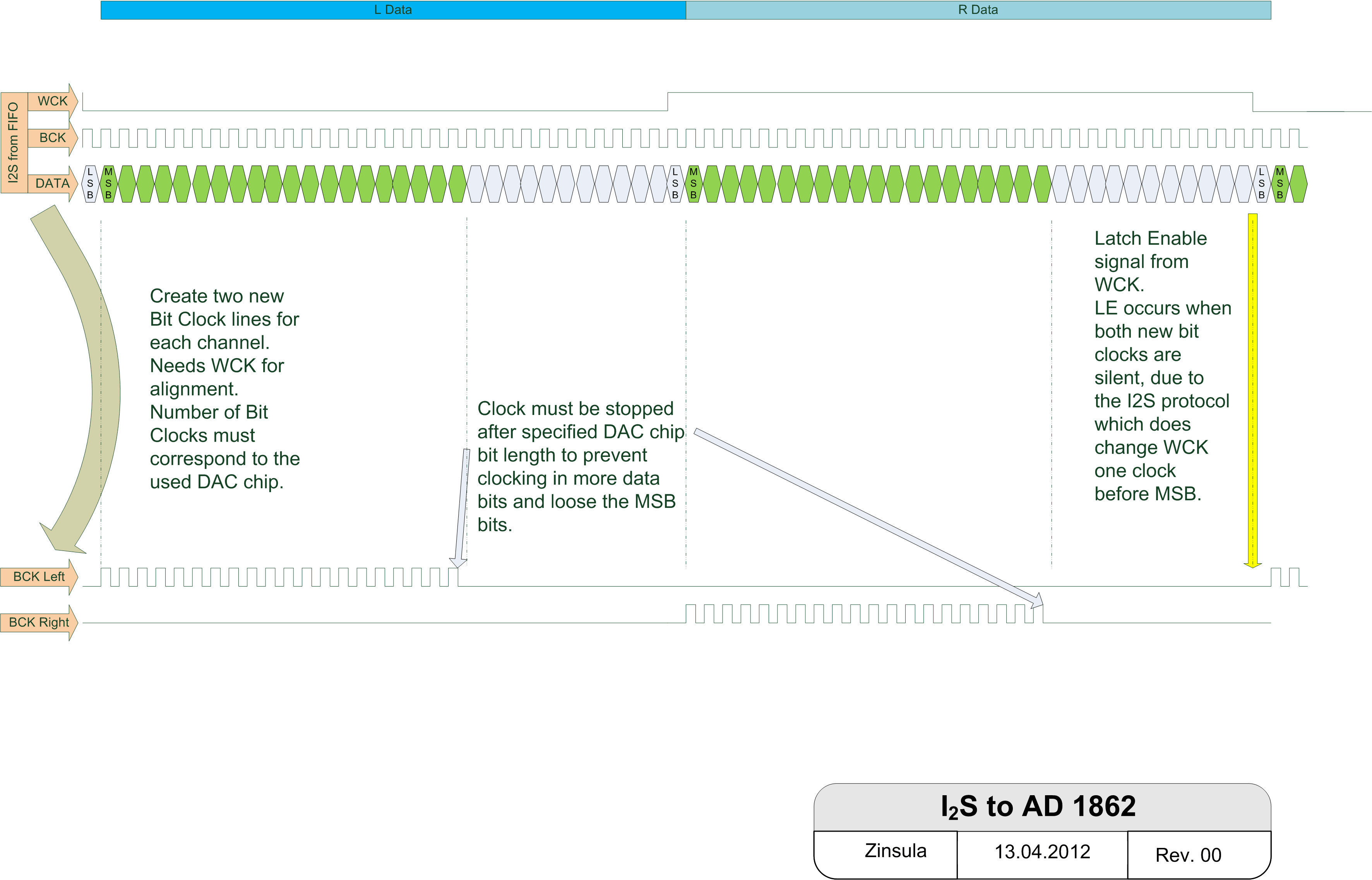

Asynchronous I2S FIFO project, an ultimate weapon to fight the jitter
I planned to construct this with 3 Shift registers per cannel and some XOR and NOR gates.

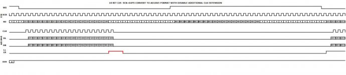

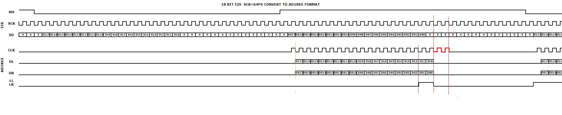

I attched the possible timing waveform (take AD1865 for example). Please let me know if there is any problem.
To have the correct sample for the L and R you should shift everything as in I2StoAD1865converting.jpg

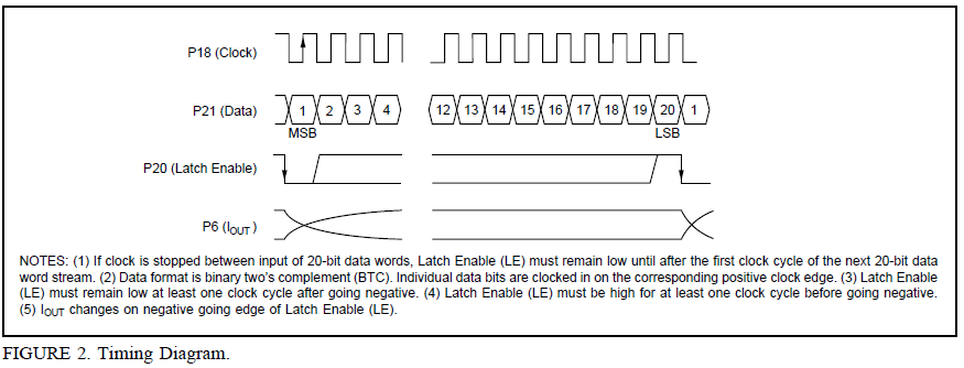

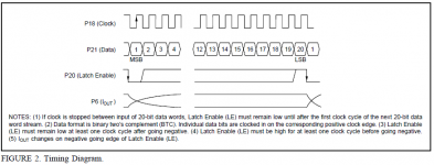

I reviewed the timing diagram of PCM63, PCM1704 and AD1865 so I will refer only to these.
Until now I kinda misinterpreted the functionality of LE. It must be set high one (AD1865) or two clock cycles (PCM63/1704) before we want to latch data into the DAC, but it can be kept high for more cycles. For stopped clocked operation PCM63/1704 specify that: "Latch Enable must remain low until after the first clock cycle of the next data word to insure proper DAC operation" - see PCM63 timing.png
The stopped clock operation looks interesting and its probably beneficial, however AD186X doesn't specify this mode of operation at all, but I think it could work fine if we follow the correct timings.
Some thoughts about timings:
- DAC output changes state for PCM63 and AD1865 when LE goes negative, while for PCM1704 two clock cycles after LE goes negative
# With a switch we could select the stopped clock format - basically to have two clock cycles after LE or not
- The minimum width of LE high differs among these
# A good compromise could be to set LE high two/three clock cycles before it should go low
- For the above DACs the converter should support bit depths of: 18, 20, 24 - I suggest to support 16 as well

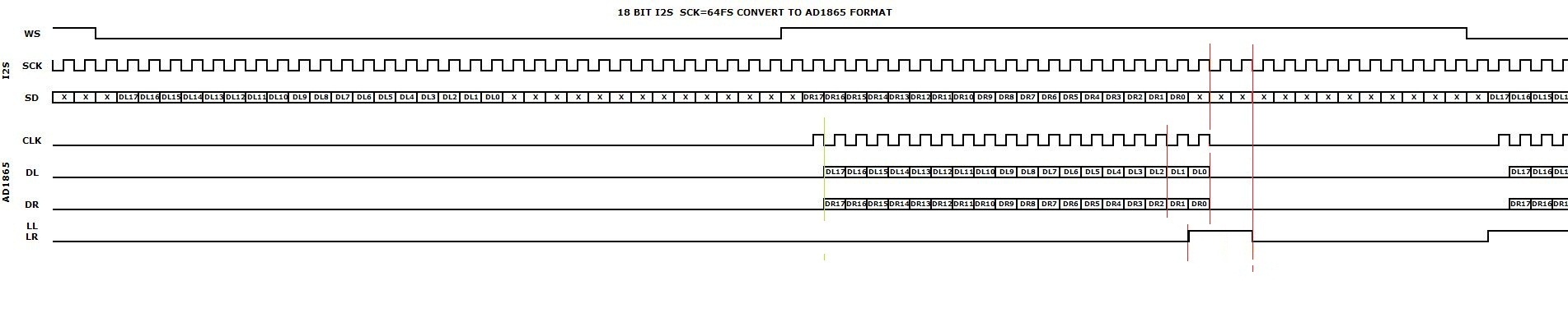

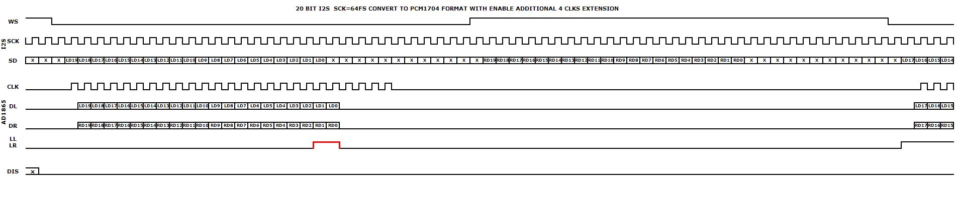

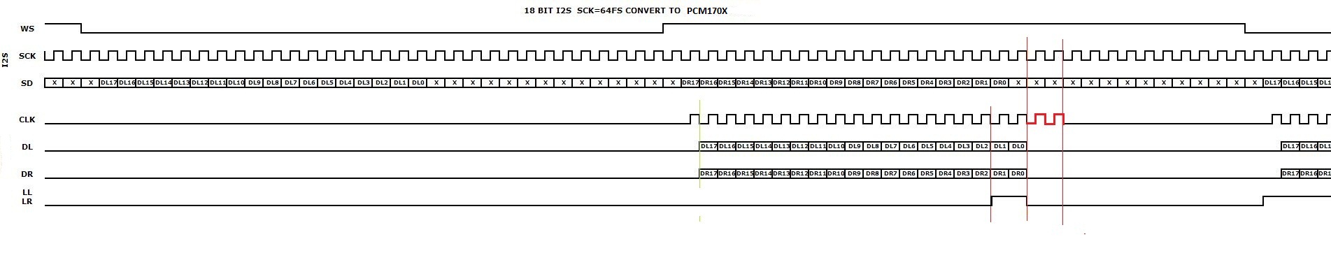

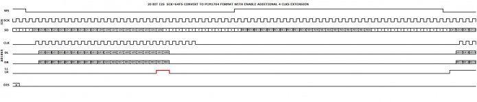

Taking into account zinsula's suggestions of delaying LE the stopped clock timings could be could be smtg like that:
[...]Until now I kinda misinterpreted the functionality of LE. It must be set high one (AD1865) or two clock cycles (PCM63/1704) before we want to latch data into the DAC[...]
Hi Zsolt
Strange that with AD1865. With AD 1862, there are no requirements of LE relative to the BCK cycles, only timing requirements:
- LE must go high at least 40ns before LE going low again
- last bit (LSB) must have been clocked in at least 60ns before LE going low
- next word (msb) has to be clocked in earliest 15ns after LE going low
- LE must at least stay low for 40ns
As i understand the function of this DAC, there is a shift register which works with BCK and DATA. As soon as all bits are loaded, you have to stop the clock OR go low with LE immediately (IE left justified data).
LE is just there to start the convesrion of all bits. Therefore the above timing requirements makes completely sense.

You are right that neither AD1862 nor AD1865 has requirements of LE relative to BCK cycles and I admit that extrapolating the required LE timing to clock cycles is confusing and error prone.
After all I think the timing I proposed is still valid for AD1865, PCM63 and PCM1704.
Zsolt

I2S to AD18XX/PCM63/PCM1704 convertor

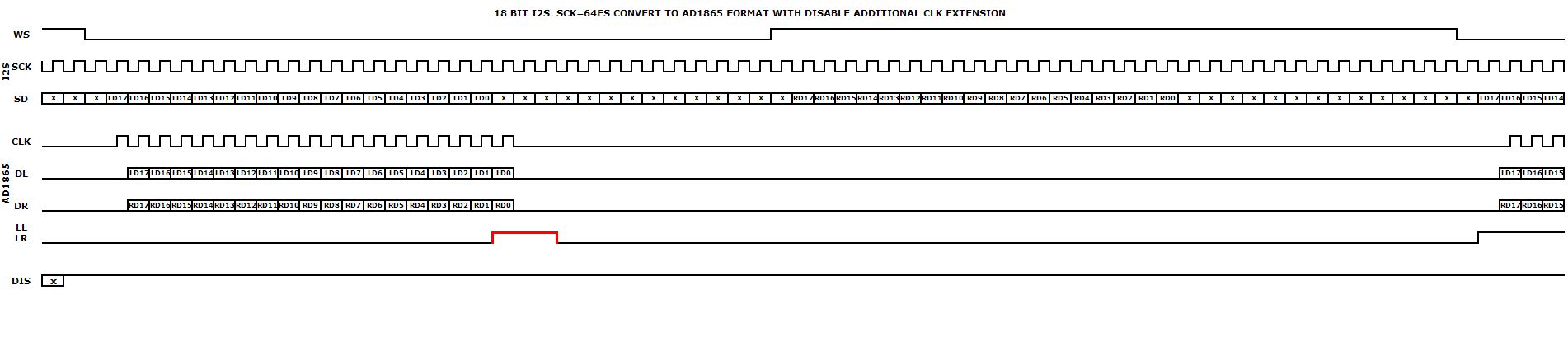

For PCM1702, Datasheet states the following:
So I believe it needs 4 clocks.
There are so many different requirements, it's kinda difficult to have all OK for all DAC's.
24 bit AND working with the 1704/02 would be nice... Could somone build it, please...
Make sense. I suspect, inside AD18xx, there are just two shift registers and two latching registers, PCM63, maybe. But for PCM17xx, they need a couple of addition clks for some different constructions.
It seems we should:
1. Supporting 16bit, 18bit, 20bit and 24bit format with selectable setting jumpers.
2. Including a clock function jumper to enable or disable the 4 clks after negative edge of latching,in order to be compatible with pcm17xx.
3. For AD18XX, do not compromize with PCM17xx. Delay the latching and stop the clock after shifting.
I attatched the updated timing plots, taking example for both AD1865 and PCM17xx. Let me know for any problem.
*please don't care about the LL,LR signals at the next word, I forgot changing them on the plots.
Nice weekend.
