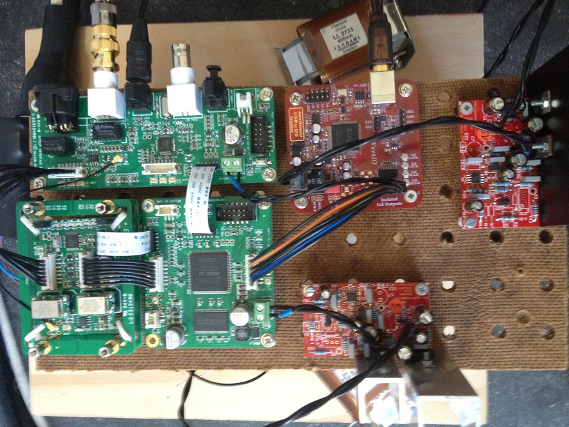

An attempt to loose all perceived ambiguity 🙂 :
- waveio has its own secondary winding, own rectifier, CLC, superreg
- FIFO + clocks have their own secondary winding, own rectifier, CLC, superreg
BUT waveio and FIFO share the same toroid primary, their secondaries are seperated
-D/A is a hypex dlcp with its own dedicated hypex SMPS powersupply
-A are hypex ncores with their own hypex SMPS powersupplies
But I have just a single phase entering my home driving it all.. What's totally galvanically isolated to you? A totally seperated phase for D and A or seperately battery powered or do I qualify 🙂

Could you please explain my common ground? 😱 I can only see the shared in my case 230V powerrail?
A continuity tester between your clock PS ground and your DAC ground? Is it not common?
Not sure whether you drive the NCOREs balanced...
Well I'm enclined to think it's not common.
-The fifo has its own transformer-bridge-CLC powersupply.
-The dac has its own SMPS powersupply
-The connection between fifo and dac is spdif, there's a pulse transformer in between (actually I think there are 2, sending and receiving side).
The dac is a hypex dlcp, poweramps are hypex ncore's. The interconnects are differential. From the hypex datasheet:
The audio input is differential. This means that ground is not part of the audio signal.
The dac and poweramps all have their OWN dedicated hypex smps as powersupplies.
There are no safety ground connections anywhere.
edit: there's a connection between dac/poweramps for the balanced cable shield, that could be a ground connection in effect, although the hypex datasheet states its passive and not part of the signal. But I just dont know how it works 😉

You are correct, in your case there is no common ground between Fifo and DAC and everything seems to be wired correctly.

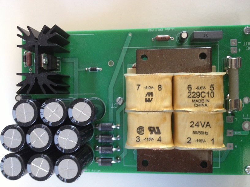

I have no idea how you experience those huge differences with minor changes to your PSU. What is this superreg you are using? For me the only logical explanation might be that your superreg is oscillating heavily.
One picture is worth a thousand words...
yep, that could easily be the case, there is a fair bit of capacitance on the boards and that could for sure be causing issues with the superreg, especially since the caps are low impedance types
Wouldnt that have shown up in the linear audio vol.3 test of them?
Also why would the insertion of the L between CC remove the oscillation?

probably because they tested them while using them appropriately 😉 following the designer's recommendations. both Jack (the guy who set up the tests) and jan (the publisher of LA, who also used to sell the old colony official super regulators) are very familiar with Jung type regs. if you read the directions for these reg boards you will see he has specifically warned against using very low impedance caps on the output.
it may not have removed the oscillation, just changed it, or perhaps the L damped the high frequency response somehow. i'm not guessing, pretty much all super regulators are not happy driving low impedance and somewhat highly capacitive loads and your pictures clearly show thats what you are doing. whether that definitely explains your results I dont know.

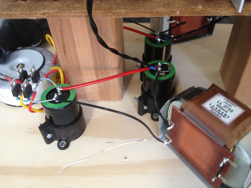

The reg has a single 50V/100uF cap on its output.
However it also has a 50V/100uF cap on its input. There I may have somewhat of an issue since its choke-47000uF-1 feet of awg20 twisted pair, then the reg's 100uF input capacitance. Maybe a little unwanted CLC action. Though still would not makes enough sense to me since the difference is very big.
I had the fifo long before the hypex dlcp, I though it had become obsolete because of the src but waveio isolated spdif -> dlcp is not even close to waveio -> fifo -> dlcp..
I am not imagining things, I've had others listen to the difference. And If I wanted to hear things why wouldnt the addition of the choke to the wavio PS improve my perception aswell? Since it doesnt seem better on that position, just oh so slightly different.
I was thinking about lower current draw from the power grid but if so then the effect would have had to be bigger on the wavio because it draws more then twice the current? Not the case so..
Now what if I reverse the question, why wouldnt a CLC supply provide a better/lower noise environment for the fifo/clock supply then C or CRC?

Also before I used simple LT1085 powersupplies for waveio/fifo as in attached photo, replacing those with C-sjostrom reg was a significant change for the better, for both waveio and fifo this time 😉
