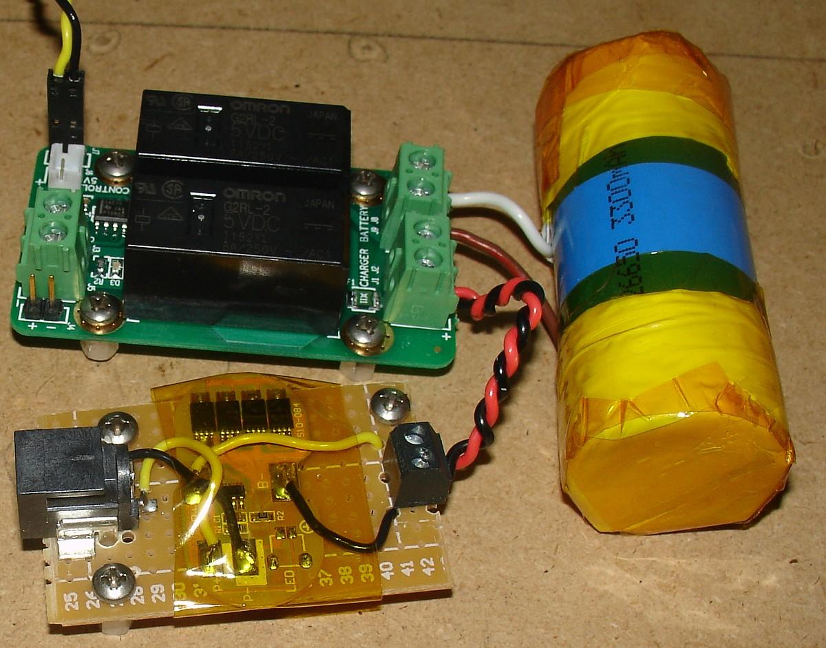

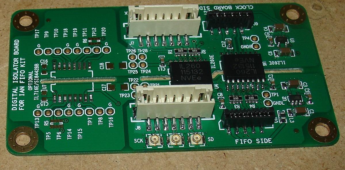

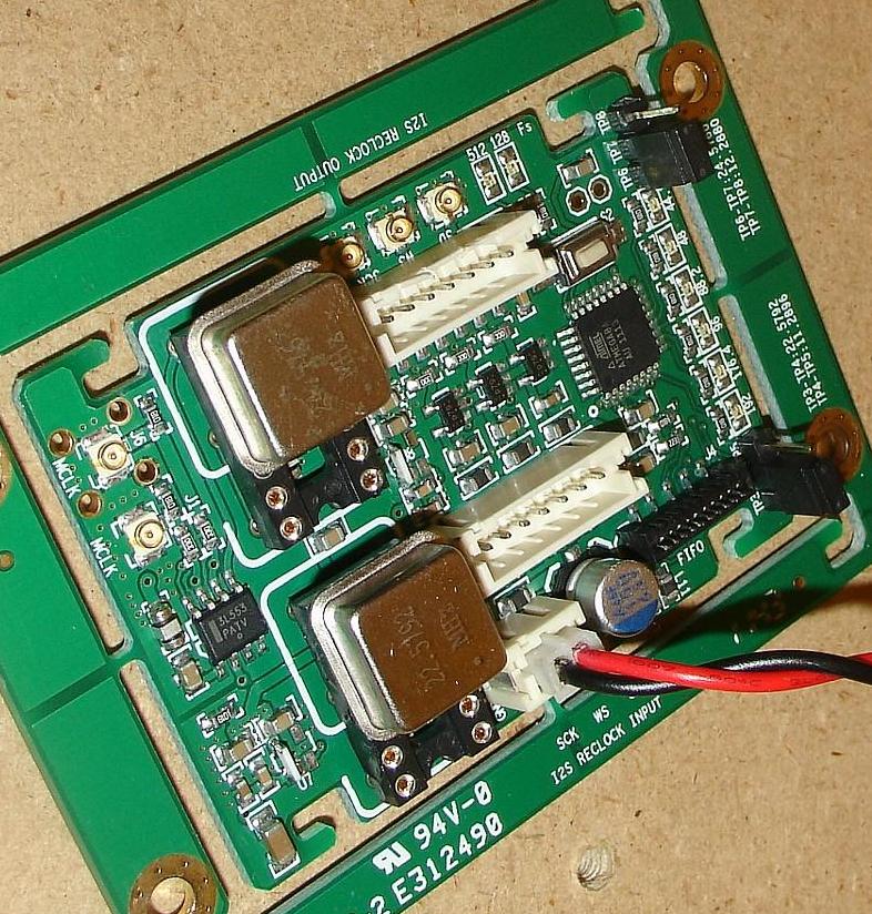

I had a working FIFO and 2x clock board (stock clocks), powered by the FIFO. I put together the isolator and the battery management board and removed the two regulators from the 2x clock board. Now I get no sound out of the device.
I removed the FIFO assembly and tested the dac board straight to the usb board and I get sound, so it's not the usb or dac boards. I removed the isolator and battery management boards and replaced the 2x clock board for the Si570 and single clock boards and still get no sound.
The battery management board I checked and it works fine when turning the control 5vdc on/off, it either feeds the battery output or shuts it off. When it shuts off the charger feeds the battery. Is there any way of testing the FIFO board itself for correct operation? The isolator board? It seems I've damaged the FIFO board?
I've attached photos of the isolator, 2xclock and battery manager. FIFO with Si570 hooked up and music streaming but not "playing" (i.e., no sound). The isolator has nothing soldered to the bottom side.
Thanks in advance for any help!

Hi Palmito,
Please check three LED indicators on the FIFO board,
1. If all LED are off, that means the problem is from the the isolaror board or clock board.
2. If Empty LED is on, it means input I2S signal has problem
3. If Lock LED is on, that means FIFO works fine, you should get sound.
If you are in case 1, try to run the system without isolaor to see if it is working(do not power clock board from DC input for this configuration)
Good luck,
Ian

I noticed you have already removed the regs from the clock board, in this case, you can't power the clock board from FFC/FPC calbe from FIFO, 5V may damage the clock board.
If you want to run the system without isolator board, you and use single clock board to play 44.1K music.
After you address the problem, you can go ahead what ever you want.
Ian

Both FIFO and clock boards are fully tested. So I suspect the isolator board is the criminal 🙂.
You should have the schematic, most probably is the resistor packs, try to find if there is any short or disconnect under the chip.
Ian

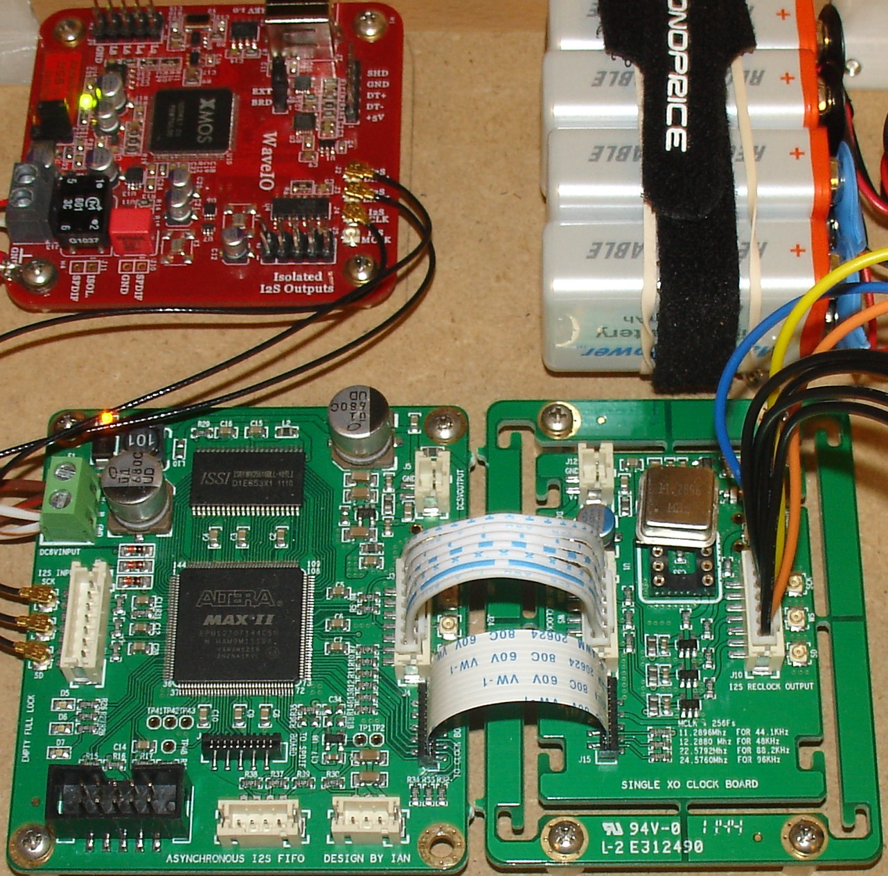

I set it up with the 1xclock, which I have never used with the isolator/battery manager, so it shuold not be damaged. Fed it 44.1 music. I tried both with the long cables and the u.fl cables in case I mistakenly broke one of the long cable connectors pulling things out. No sound from either set of cables.
Attached is a photo, the only led lighted on the FIFO board is the power one.

Hi palmito,
I saw the XO is at wrong position from the picture of your single configuration.
Please see the fifo picture with sinale xo below for details:
http://www.diyaudio.com/forums/grou...-pdif-fifo-kit-group-buy-104.html#post3372689
Please note pin1 of XO has to face the 45 degree corner of the xo footprint.
I believe you can fix it.
Ian

Thanks again Ian. I placed it correclty now. I never used the 1xclock board until now to test the system after it stopped playing and I don't remember ever pulling the XO out (but good memory is not a trait I have). I did pull the XO's out of the 2xclock board when removing the regulators, but I placed those back correctly.
But it didn't help, I still get no sound and only the power led on in the FIFO board.

Hi palmito,
In this case, please sent them back to me, I can address what was the problem. I don't know how long it will take for you to get the new board from next GB.
When you do so, please don't forget including a small piece of paper with your shipping address, your email, your DiyAudio ID ,your order number and some note about the problem. Thanks.
