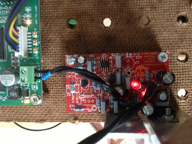

didnt see the pics, you using the JSR01, or SSR01? I have both PCBs here too, but since you mention SMD, I figure you mean JSR01 as only the opamp in the ssr01 is possible in SMD. it was the SSR01 in linear audio
Ah sorry my bad its the SSR01 so NOT smd, was mixing it up with his diamond buffers..

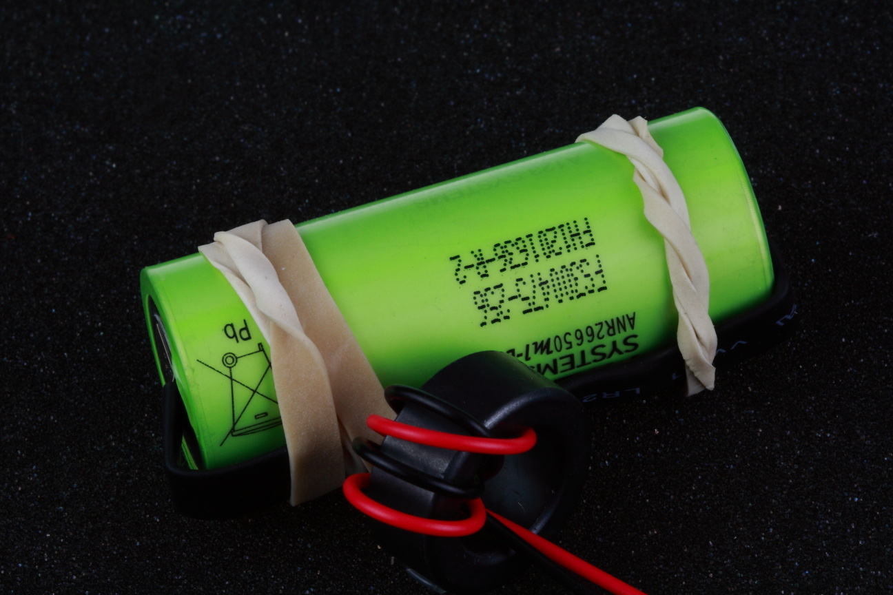

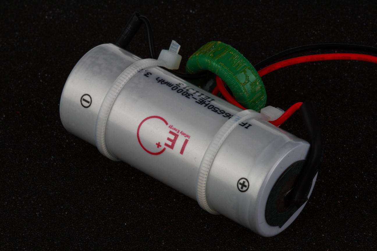

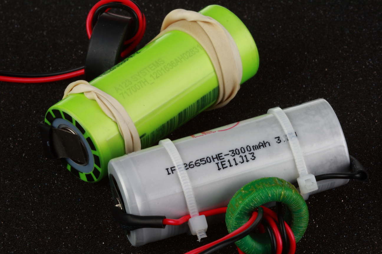

LifePO4 Battery, genuine A123 and third party
I thought there was no big difference between LifePO4 batteries, genuine A123 and third party ones. But it seems I was wrong.
A couple of weeks ago, I got an A123 26650 battery cell from a friend of mine, I did some test on both Dual XO and Si570 clock board. The genuine A123 battery was really better. The audible difference was that the genuine A123 sounds more stable than the third party ones. However, A123 was discontinued, that’s really a bad news.
Same chemical, I can’t explain.

Do you have any idea about the reason?

same material, different, nanocarbon substrate.

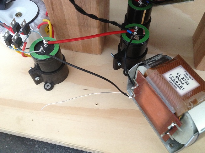

Nice choke
How much in difference with and without the choke?
Have you get choke compare with a resistor?

It's a pretty big difference, I've compared to a 2,2 ohm resistor and a 16 awg, 0,75 ohm 3,4mH (jantzen wax) speakercoil. The Jantzen waxcoil actually sounds the worse of all 3, it even sounds worse then simply paralleling the 2 47.000 uF caps. The resistor seems to make a small change for the better. The 460mH/3,4 ohm lundahl is an entirely different animal.

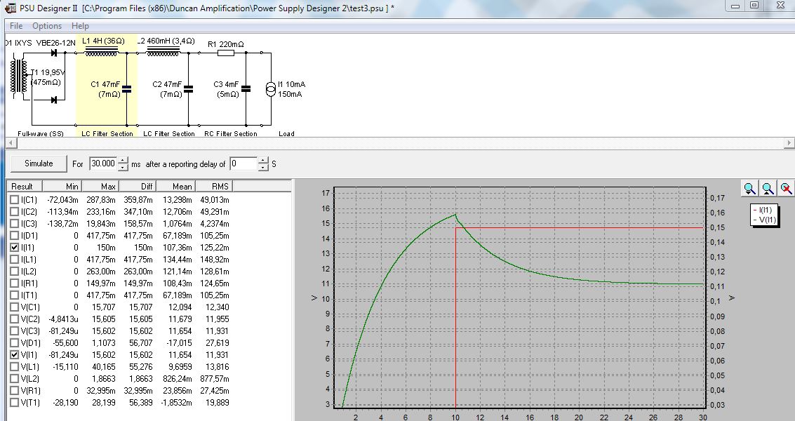

Currently considering building the attached psu, everything including the 0,22R in a seperate chassis, last C + superreg + fifo in its own enclosure.
Any comments are welcome

if the PSU means you have to put the fifo into another enclosure and make the clock lines longer, you have your priorities all wrong; its counter-productive
No clock lines will be the same, I will put the fifo + waveio + hypex dlcp + regulators in a single enclosure, all powersupplies in a second enclosure.

I ran another test.
On the waveio supply I can hear a slight difference with or without the choke but cant say which of the 2 is better. So that would be C only vs CLC before the voltage reg.
On the fifo the difference is again rather large. Same supply, C vs CLC before regulator. Without the choke the highs are "sharper/more agressive/shouty", however on a really dark sounding system people may interpret this as having more bite? Hard to imagine as it also seems "more airy". Midrange purity seems improved with the choke. But the biggest difference is bass impact, I can feel it hitting in my couch.
I'm far from an expert on all of this but wonder why. Can it be additional energy storage/availability from the choke? Or just less jitter? And if so how, additonal filtering? Cant be a lower ripple thing can it with the voltage reg following it? I'm just having a hard time understanding why the difference is so pronounced on just the i2s->spdif converter. I would expect these effects more from powersupplies feeding analogue stages.

Some things are obviously hard to explain. Your observations are very close to what i feel is the audible effect of chokes in analogue power supplies. Why should it sound the same way in a purely digital system is a bit of a mystery.
Otoh, it is the same system ground which is also shared by the analogue stages, right?
Well through the spdif ground then?
