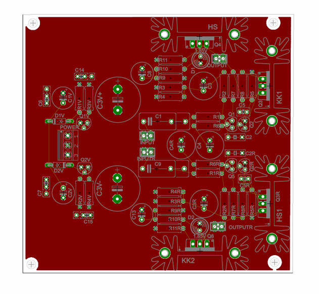

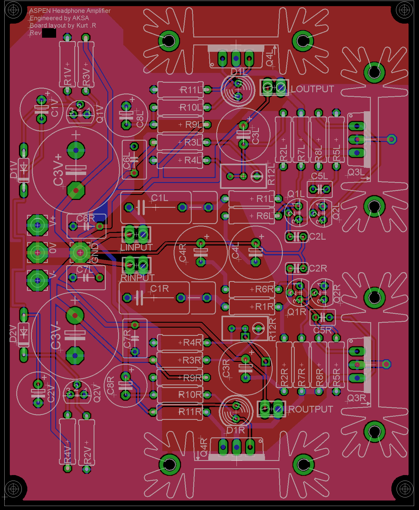

I finally had some time to work on the layout, It's much better now...
Comments?

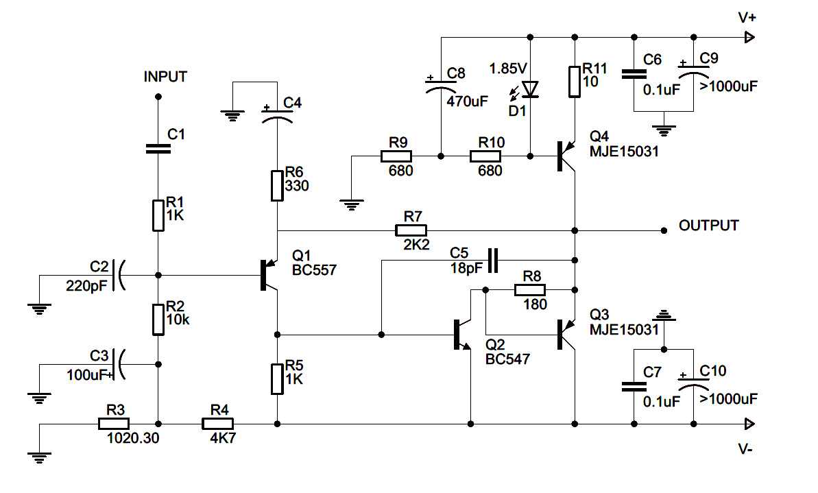

Since I can't really send attachments though PM's so I'll leave the schematic I was using (the schematic and the boardlayout is linked, changes that happen to the schematic happen on the board). I'll make a later identical layout with values, unless someone else would like to.

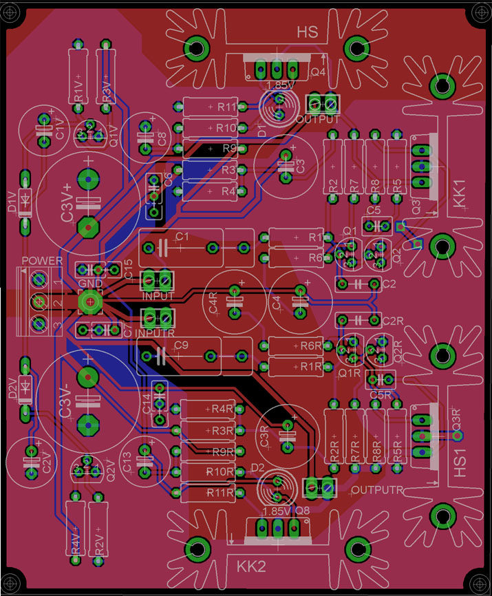

Currently, the board layout doesn't have any traces, I hid all the lines that had gone to 0V or V+/V-. I need to adjust the layout of the PS section before I do any routing.
I think this should be a small milestone, Just need to rename a bunch of parts, tweak one or two traces and create a professional looking schematic, could anyone recommend a nice program for creating nice looking schematics?
I feel like I've finally accomplished something significant
I'd like to know if anyone would be interested in distributing? or who might be able to organize the GB.

P-A,
Why do you avoid angles less than 90 degrees? Would 45 degrees be OK? My boards use lots of small angles, and curves, too, am I doing it all wrong?

Knight, I'll suggest tjat most if the tracks are located at the component side since à whole groundplane is desired. Normally I had put the groundplane at the component side (looks nicer) but since you have heatsinks it's better with the groundplane on the solderside.
I believe I can remove the ground plane underneath the heat sinks...
Does anyone know how much Q3 and Q4 dissipate?
The connection between C1V/C2V and D1V/D2V is unnessary. The schematic symbol is also wrong since the parts are LED's
Any part ending with a V is a optional component for people who want to use a virtual ground and a duel rail powersupply, The correct LED's are there, check post #1085... That's the current schematic I'm using (which is linked to the board layout)
A couple more things that I should note, the headphone out for both channels is paired with a test point, they should not be used for headphone ground. The main star ground via should be used if a TRS style jack is used. This should allow me to make the ground wires a little less messy.

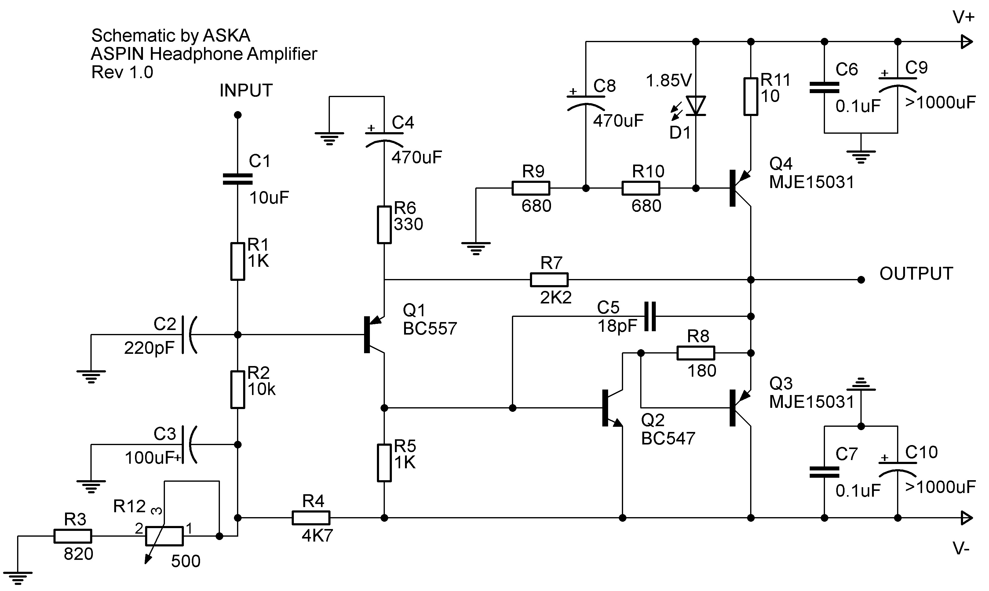

This is the schematic that will be used for a building aid... Just needs a little added ownership
and the BOM is almost done, just needs some more parts and final touches.

R3 would be 820R and a 500R pot in series.... this permits trimming the output offset to zero, very, very important for a headphone amp.

One important thing is forgotten. The output should have a 120 ohm resistor in series. This will create the standard output impedance eventhough I prefer to be able to short this resistor. You can check out my QRV09 design for inspiration.
The gain is nearly 20 dB which is too much in many cases. The design should be tested for gains down to 6 dB.
