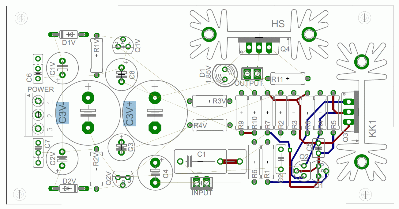

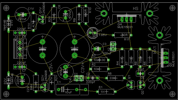

Eagle has been my choice of PCB software lately and I greatly enjoy the using the software to make PCB layouts. Which brings me back to this amplifier. I believe that there hasn't been a PCB made for it yet, and I offered a while back to make a layout, but i was discouraged because of the confusing schematic. Things make a lot more sense now.
If i could get someone much more knowledgeable to let me know if i recreated the schematic correctly within eagle, I could begin on both a one sided layout and a double sided with silk etc. For a possible group buy PCB.
Would a companion PSU be favored also?

Does this virtual ground look good? Disregard C1 and C2 values.
R3: what does mean 1020.30 mean?
I assumed that was the value of the R3 resistor since that's what it appears to be on post #1037.

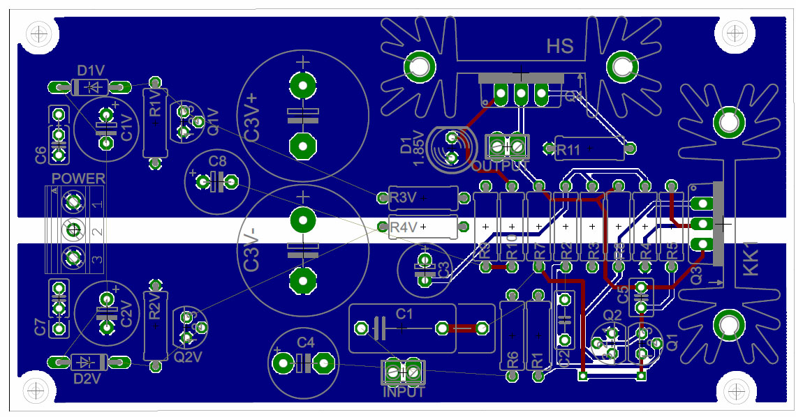

I'm glad some interest is returning. The more I work on the PCB, the more fun it is, playing with this and that. Are power planes OK?
C1V & C2V reversed cf. the other 5 electrolytics.
Reversed cf? Direction?
Can extra pin pitch options be added to all capacitor locations? C2 & C5.
Are you asking me to put extra vias to allow for different diameters of capacitors? I haven't processed a BOM, so most of the components are relatively "eyeballed" based on the value of the component.

Yoyo KofA, I have a question:
One channel per board? I like it, I'm all for dual-mono, but this'll make any tone control a little harder, and implementing the crossfeed will mean bringing both of these boards back to some 3rd common board before output. Most people's headphones will have a common ground in their jack anyway, so would a stereo board not avoid ground loop issues too? EQ and crossfeed are not such big issues for me but I think that we want our phones to come back to a star ground which would best be on a stereo board.
I don't mean to put you off the effort, you're a champion for doing this for us ;P

Yes, echo that dwf - and maybe extra options for all the caps, not just the electros.
Hi KoA, it's coming together nicely.
I don't know if your program allows for it but having the plane so close to the donuts and those thin tracks is a nightmare if you want to make changes to the cct, or just add components like parallel resistors, caps, etc - can this small clearance be increased so a good gap is between and increase the width of the tracks?
A suggestion: It seems you have used the gnd plane as a common 0Volt "point" - suggest discrete tracks to create a "centre star" instead, to control individual 0volt return paths - might need to move some of the bottom/lower level tracks to the top.
... just my 2 cents
For the record, I'm willing to take the time out of my school, and out of my life to make this what it needs to be, and no less. I need to do the absolute necessary to build this board layout into what is absolute necessary, So please keep the suggestion coming. They won't ever offend me as long as they bring and a maintain constructive environment around this project. And for future reference, please call me kurt
@derwhalfisch: When i first started building the actual board layout in diptrace, I had two channels on one board, I first found it over whelming, but that was a while ago. I'll put two channels on one board so set up a proper star ground of sorts to simplify the wiring layout, and I understand how important that is. I'm glad i took a bit of a breather to spend sometime working on my dynalo, and I learned some excellent lessons (although the dynalo still doesn't work, but that's beside the point), on proper board layouts. Mostly wiring schemes and powersupplys. So yes I'll incoperate the proper star ground for TRS style jacks. Also note that the two blue planes are power-planes and not ground-planes
@jameshillj: Like I said above, the two blue planes are infact powerplanes, I've hidden the ground plane in the top layer for the pictures, but otherwise it's only there to simplify the ratsnest of hell that the extra traces that I shouldn't be worrying about at the moment. The finalized boardlayout will have a ground plane in the top layer, but it will be connected to a one separate point, rather then being connected to all. I can adjust the clearance for the planes, and i might end up adding quite a bit of clearance for the traces, having such a small gap tends to add to errors in the manufacturing processes. I'll also change the width of most of the traces on board to be on par with the schematic. I could try and add additional vias for modding a CCT a easier job, creating something modular seems to be popular in DIY.
