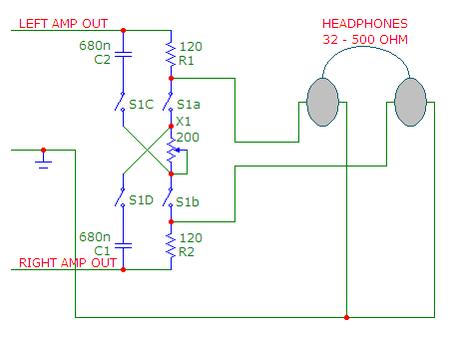

Here is the links to all the Haksa circuits.
Some changes could happen on some of those schematics.
Bye
Gaetan
The amp; diyAudio
The same amp with a CCS; diyAudio

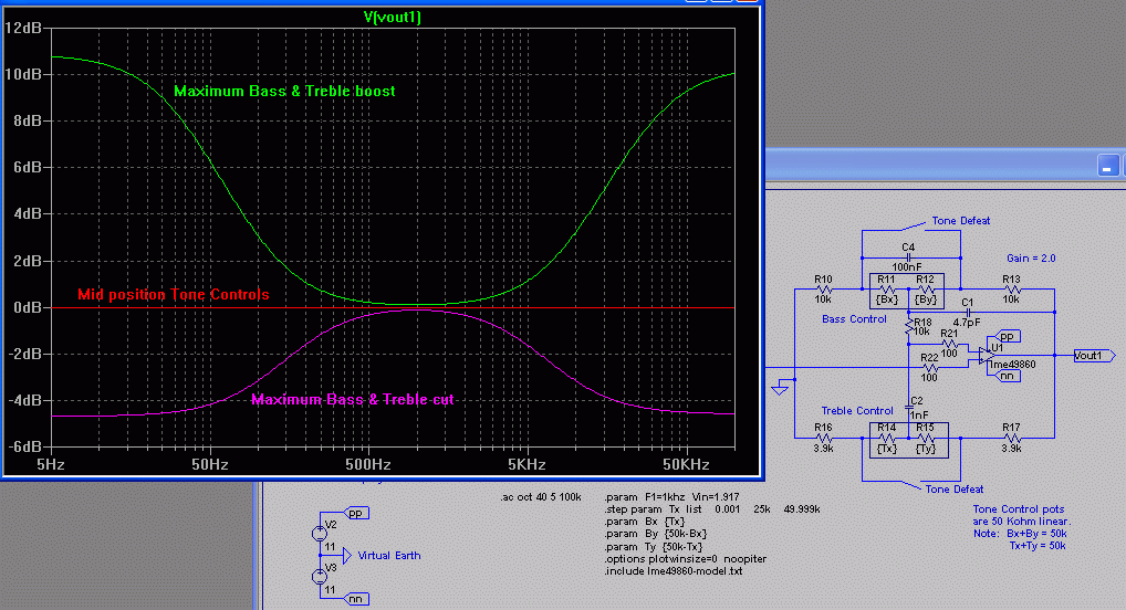

The first tone controls showing volume and balance controls; diyAudio
The same tone controls with minor corrections, without the volume and balance controls; diyAudio
The crossfeed, maby not final schematic;diyAudio
The power supply (not final schematic, may change); diyAudio
