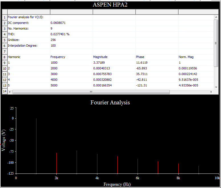

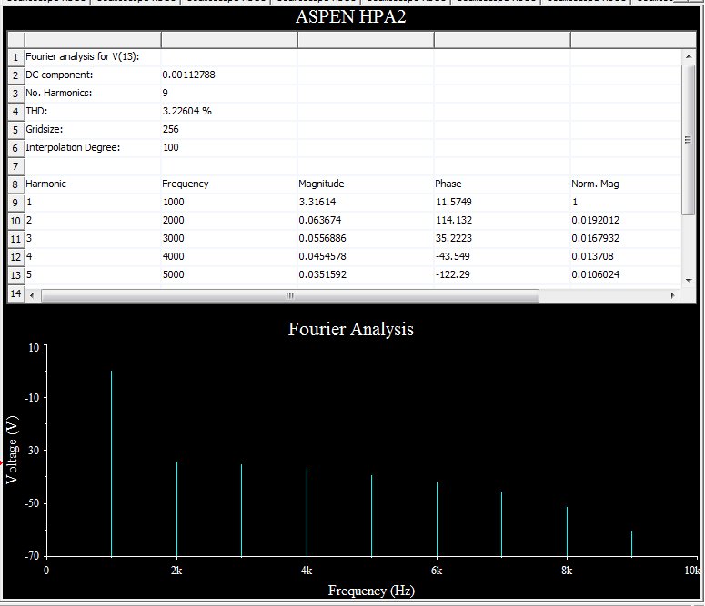

I did this, using a 91 ohm resistor and saw a huge increase in THD in the simulation over the CCS. Why is that?
John,
You are talking of gross clipping, at around 6Vp due to current limiting!! This is an SE amp, of course this is a problem - Andrew points this out earlier. It is, like all topology, a compromise..... but most people will not be listening at 3.07Vp on a 24R can. High Z cans are no problem to about 10Vp, in fact.
My comment about distortion obviously relates to the rated 1Vrms, the 0dB standard, where you get a distortion profile hardly any different to the CCS loaded one. Obviously the CCS confers flexibility for all sorts of cans, and that is the purpose. I have attached the distortion profile for a 91R resistively loaded output at 20KHz signal into 24 + 10 ohm load at 1Vrms, which is 1.414Vp.
I thought you said you were leaving?
I come and I go,
I'm pleasant and I'm nasty,
And apparently I'm smart and I'm stupid...
You are right, of course, I didn't even bother to check if it was clipping - just assumed that it wasn't and ran the FFT.

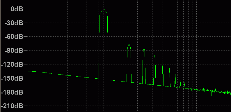

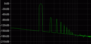

That's one of the things I've seen - too much stock put into the simulated spectrum. It has been my experience that the raw THD figure (0.045% for example) is relatively accurate, but the spectrum has not been confirmed and it's accuracy I strongly doubt - it will change, sometimes radically, with a different device model (could be the same device, different manufacturer model).
At best I think it can give a "hint" as to what the spectrum may be if you manage to use accurate models and can get similar results with similarly accurate models on a second simulation run.

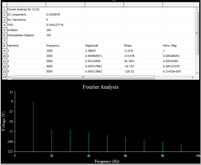

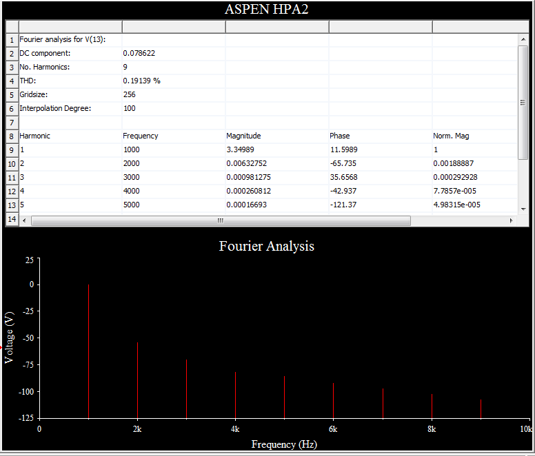

Here's an example. I used the same circuit but changed one device, in this case the output in Hugh's circuit. I used the MJE350 that was in the Multisim library (I'm not sure where it originated) and I used the MJE350 model from Fairchild.
The MS model:
The Fairchild model:
Quite a difference, even in the raw THD number when there really shouldn't be - same circuit, same condition, radically different results.
With that said, Hugh's circuit is a good one for testing the consistency of these models and I believe the harmonic spectrum is fairly accurate, as I have been randomly "plugging in" various known good models and getting nearly the same result. It should be a very good sounding amp.

A glance at the models used in LTSpice reveals all parameters are at 6 significant figures. For example, here is the MJE15031 taken from the library with Notepad:
.MODEL MJE15031 pnp IS=7.17489e-11 BF=457.169 NF=1.11376 VAF=6.01557 IKF=0.345808 ISE=1e-08 NE=2.18567 BR=0.247882 NR=1.39549 VAR=60.1557 IKR=0.0263893 ISC=1e-16 NC=2.89486 RB=2.29208 IRB=0.0114006 RBM=0.000102795 RE=0.00815557 RC=0.0407779 XTB=0.1 XTI=0.1 EG=1.05 CJE=1.64037e-09 VJE=0.819491 MJE=0.537987 TF=1.60991e-09 XTF=180.82 VTF=1.16561 ITF=6.50499 CJC=4.82516e-10 VJC=0.4 MJC=0.374287 XCJC=0.786653 FC=0.712788 CJS=0 VJS=0.75 MJS=0.5 TR=3.32795e-08 PTF=0 KF=0 AF=1
What is in doubt is the veracity of these models. I am not skilled in this area, but I'm told there are some glaring inadequacies, for example the Early effect is not prescribed, and behaviour of beta at very low Vce is not accounted for. The expert in this area, a mathematician, is Andy_C, also on this forum. Neither is the Berkeley spice engine transparent; we cannot know if all aspects of transistor operation are incorporated in the computation of THD.
However, my thoughts are that the basic device parameters are accurate and this is useful for back of the envelope scratching during the early stages of design. It enables viability of a topology to be quickly tested and operating points refined. Assuming the distortion artefacts are fully accurate is probably foolish, but in the absence of an AP it's better than nothing, and certainly tells you quite a bit about distortion profile; whether artefacts are same magnitude, or monotonically decreasing, for example. (One might even ruefully consider the stunning correlation, or lack of it, between THD and sound quality, but that is a separate issue!) Since these are essentially command line programs, there is a learning curve not unlike Unix, and some will have very sophisticated analysis techniques, which can lead to a variety of answers, trending simulation towards interpretation rather than unarguable, objective fact. I have also seen quite different results between LTSpice and MicroCap, for example, an outstanding, commercial program used here by Nico, and this would indicate that for thoroughness one should always examine circuits in detail with two different programs, one preferably fully commercial, and therefore very costly. You need the proper tools; you don't go to war in a Fiat Uno.
The real issue is stability. The Bode plot looks pretty good on LTSpice, but figuring the very low value stability capacitors is best done empirically, particularly as it so affects sound quality.
