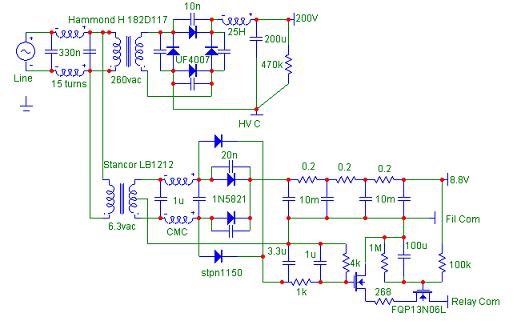

Here's an automatic way to do it (although there may be better ways).
The bottom half of this figure is a filament supply and automated mute switch. The 8.8V output is just a regular filtered DC. Substitute the rail supply for this.
Now look at the two FET's. These are in series and both must be on in order to open the mute relay (not shown in this diagram). The relay coil is connected from the 8.8V output to the relay common.
The gate of one FET is powered by the two diodes that are outboard of the diodes for the 8.8V supply. It's done this way so that as soon as the power is switched off, this FET stops conducting immediately. You can change the timing by adjusting the relevant resistors and capacitor.
The other FET gate is powered by the 8.8V supply, through the 100k resistor. It must charge up the 100u cap before the FET will conduct.
So, upon turn on, the mute relay doesn't open until the amp output has had time to stabilize. But the relay closes upon power off, before the main supply droops low enough to create a transient at the output.

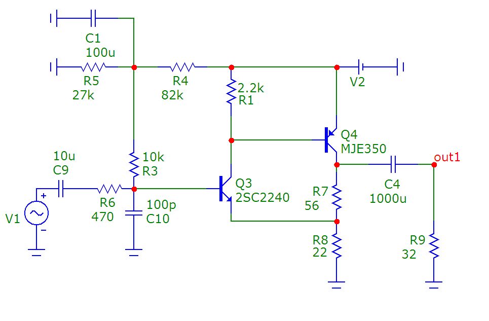

V4 is a means to assess the loop gain of the amplifier (Middlebrook analysis) and I1 is current source, which could be an LM317, or a DN2540 mosfet, or a two transistor 'ring of two' .
That was a long time ago, 8 years, I'd forgotten about that! It is two stages of my NAKSA power amplifier, in fact, and because it was single ended, sounds very, very good. You may reduce the CCS 150mA down to 40mA and drive high Z cans more than 150R, saving a lot of dissipation, only 520mW total.
Hugh

Here is another of Hugh's concoctions at about the same time 2007/8 that sounds superb. I have been using it for about 10 years now since Hugh and I searched for the most simplistic class A headphone amps.
My philosophy is the simpler a class A amp the better it sounds, my best take was three transistors, Hugh used only two. I don't even think he recalls this.
