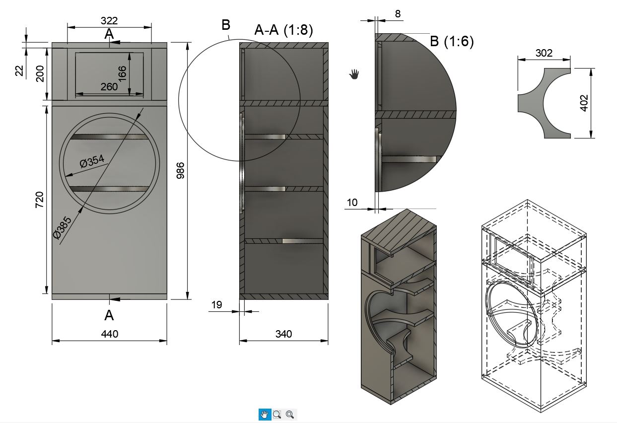

The internal volume of the woofer's champer is (H x W x D) 720 x 402 x 302 = 87.410 L.
Would it be okay to change the size to say (H x W x D) 720 x 397 x 306 = 87.460 L.
If is, that's because i will use black MDF (HDF) sheet for the front only, and i can have one with the size of 800 x 1200 mm... If size is reduzed a bit i can get along buying only one sheet that is 🙂
Jesper.
Of course, the 5mm are no problem at all. But then your front is between the side boards. Is that what you want? The total width of the Asathor is 440mm.
Another tip:
It is best to measure the woofer and horn before making the cutouts. According to the data sheet, the horn is only 319mm wide, but for me it was more like 320.5mm and so that the paint still has some space, I specified 322mm in the plan. If you are veneering, the cutout could be a bit too big.
Another tip:
Another tip:
Cool...
Yes i will have the front between the sides, and having the sides verneered is the way the original JBL is looking.
The size of W 397mm. is when my sawblade is eating 3mm., maybee it will eat a bit more, compensating a little bit more on the deept to keep the same amount of L. inside the box... I can figure this out NP!
Thank's for the tip's regarding the actual woofersize. Very usefull info.
Jesper.
Mark is right. But it doesn't matter, as long as all parts are the same width.
It doesn't matter whether the volume is 87.4L, 92L or 83L. Closed boxes are not that sensitive. So you don't necessarily have to adjust the depth.

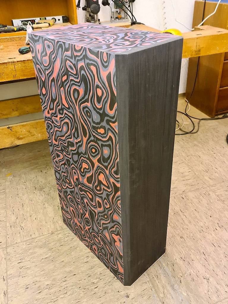

@prarieboy some of the nicest veneers don't have paper backing. If you want to make sure and veneer for the ages, first saturate the wood veneers on both sides with diluted glue to stabalize it, then press it flat between shrink wrap with boards. Then use the iron. Last and super important if you want long lasting veneers is using a veneering hammer to pull/push out any air bubles and excessive glue, giving it consistent adhesion to the speaker. These air bubbles and irregularities with movement of the wood cause the cracking. Sand and then apply your prefered finish.
How it is done right on a cracked, damaged, warped and dried out veneer
Hammer Veneering Part One - YouTube
This should hold many decades. You can also get a veneer scraper instead of a hammer (around 10€, but you need to apply more force) that will remove excess glue and airbubbles, it is all very easy and if you use expensive veneers spend the extra time it will save you heartache. I have also done shortcuts and had "issues" and wasted a lot of money.
Paper backed will be less prone and is pre stabalized (still need to avoid air bubbles) but if you want some very fancy veneers, or less expensive, that is not always an option. It's really easy and has been done with the hammer for centuries for the centuries😉
Of course have a very smooth sanded and spackled surface, especially if you use plywood this is crucial. Plywood preferably veneered perpendicular to grain for additional strength.
Good luck on the build
I have worked with, and still work with some pretty 'regulsr' exotic veneers. I've done book matched seams with veneer pins and paper veneer tape so I'm not a novice at this.
I would never use diluted glue to stabilize - there's an easy to make glycerine based mixture that does work. However, usually, moisturizing with water and pressing flat, repeating over several days, works.
A better substrate than plywood, unless using Baltic Birch, is MDF. Typically I just use PVA (white) glue and clamp between MDF sheets. Ironed on non-paper backed veneer will start out looking good, but it will crack and split in time. Just sayin' ....
