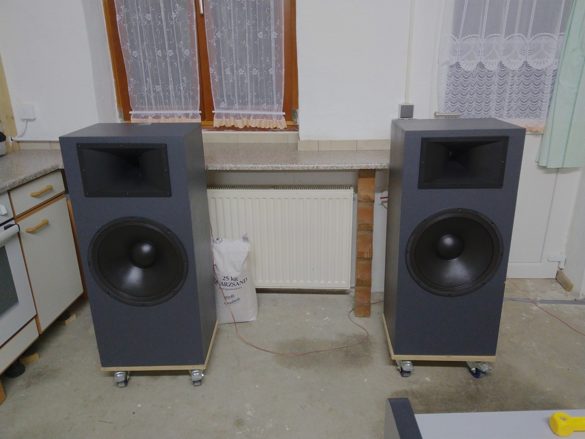

Hello Tubeglow,
you are right, I wanted to use the LaVoce WSF152.02 first because it works a little better in the closed box. Unfortunately, it was not available at the time of construction.
The differences are very small, however, the WSF152.50 has the slightly larger coil and can handle a bit more power.
I haven't tested the .02, so I can't recommend it, even if the woofers are very similar. Risking an uncertain result to save 28 € is not a very good idea I think.
Both drivers and the horn are very cheap at TLHP in France:
Compression driver Peerless DFM-2535R00-08, 8 ohm, 1-inch throat
Speaker Lavoce WSF152.50, 8 ohm, 15 inch
Horn Celestion H1-9040P, throat diameter 1 inch
So you should be able to stay below € 500 without any problems.

In terms of sound, I am very surprised by the LaVoce. I honestly didn't expect him to play that well. It was originally planned to make a version with a better woofer, but the 152.50 plays so well that I don't see any need for it.

Hello Rese,
of course for those just building the speaker along your plans switching the 02 for the 50 would be very, very counterproductive, unless you really know what you are doing. 😉 Not trying to save 30€ here, just that the nephew of my GF for/with whom I might build that is running low watt tubes.
If you have some time maybe you could ask the German distributor to loan you a second pair of WSF152.02. The Moving mass of the 02 is 69.2g vs the 90,3g that is what stikes me. That is 30% more mass! That would probably make a lot of difference in dynamics, PRAT and how well it plays bass with lower wattage amps. By asking the wholesaler you could have a version with the 02 best suitable for tube and Class A SS amps, such as the First Watts with 25W and less. Also likely with a senistivity closer to 94db/2.83, where you get into the magic of high efficiency speakers with class A. And then you could have the version with the 50 for those that run heavy SS, class D or AB, hypex, purifi, etc. that through sheer power will have a iron grip and where the powerhandling of the 50 would be really good on 100W plus and get the magic of efficiency plus a lot of power, plus more Xmax.
This would result in more sales of the LaVoce for the reseller since he would sell more chasis overall because your speaker would have an even larger audience since the Asathor in two versions would be better adaptable to various amps.
Seeing the Qts, higher sensitivity, Fs, lower mass, hmn I think in a closed configuration this 02 Asathor could very likely rival the Calpamos with the vented 15pr400 in mid/bass. Maybe better low midrange and bass speed and dynamics, obviously not min frequency and low end character😉 But also with less size and a fith of the price those a tradeoffs a lot of people might make. Not heard the Timphany horn, but it got good responses here.
Obviously Tony at Humble Hifi has a assembled kit, and as is well known is quite good in crossovers and mixing and matching caps, coils and resistors to tune the sound to best integrate the drivers (I know you do not believe😉)
Just my 02 cents, but it would likely literally be swapping the woofer and tweeking the crossover if the volume is similar. If not for too much volume either add some boards internally or borrow some extra space from the horn chamber . I think its always best the original designer gets to do this instead of someone else running with your design and you cannot take the credit. Keep up the good work.

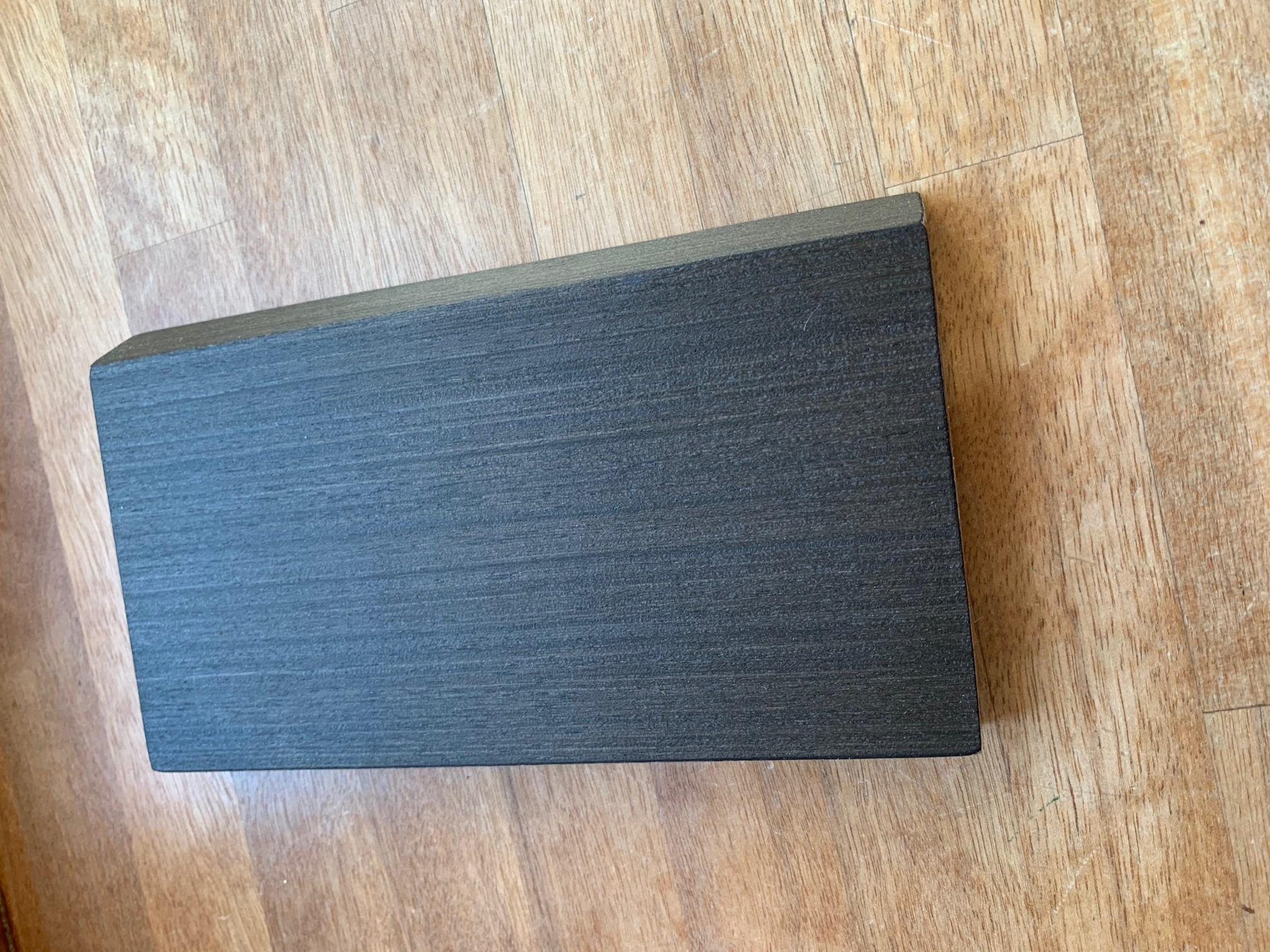

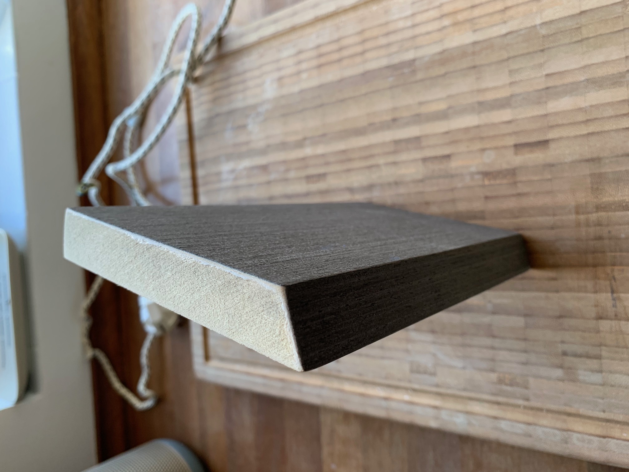

Hi all here 🙂
While this seem's offtopic within the driver vs. spl going on right now, just wanna tell that i have all part's on hand, building slowly this AsaThor spk.
I'am trying to make the finish look as close as possible to the original Jbl, with
oblique some ~30 degrees on the corners. I bought some veneer in Germany to try with some samples using the Ms. iron along with glue method, seem's to be doable (never ever tried it before)
A snip translated from German to English ::
Just to tell... Rgds; Jesper.

How can you iron on veneers?
By coating both parts (veneer + carrier) with white glue, letting them dry for about 15-20 minutes, and then ironing them on with a lot of pressure with the iron!
If you're using the iron on method and are using real wood veneers, they must be the paper backed type. Traditional wood veneers won't work with the iron on method. Yes, they'll stick and initially look good, but the veneers will split in time. (Don't ask how I know this)
It is like that, and only 0.45mm. thickness!
Jesper.
