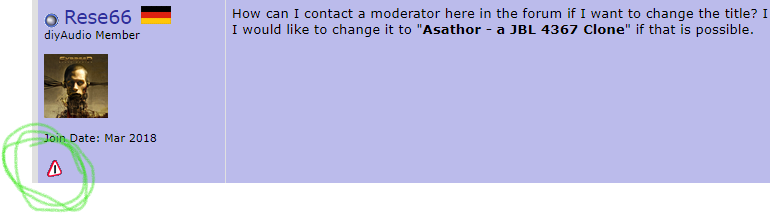

How can I contact a moderator here in the forum if I want to change the title? I can't send a private message to Dave (planet10) either?!?
I would like to change it to "Asathor - a JBL 4367 Clone" if that is possible.

Click the little alert sign in the bottom left of any post in this thread ( I've circled it in green ) and then add your request into the newly opened dialogue.

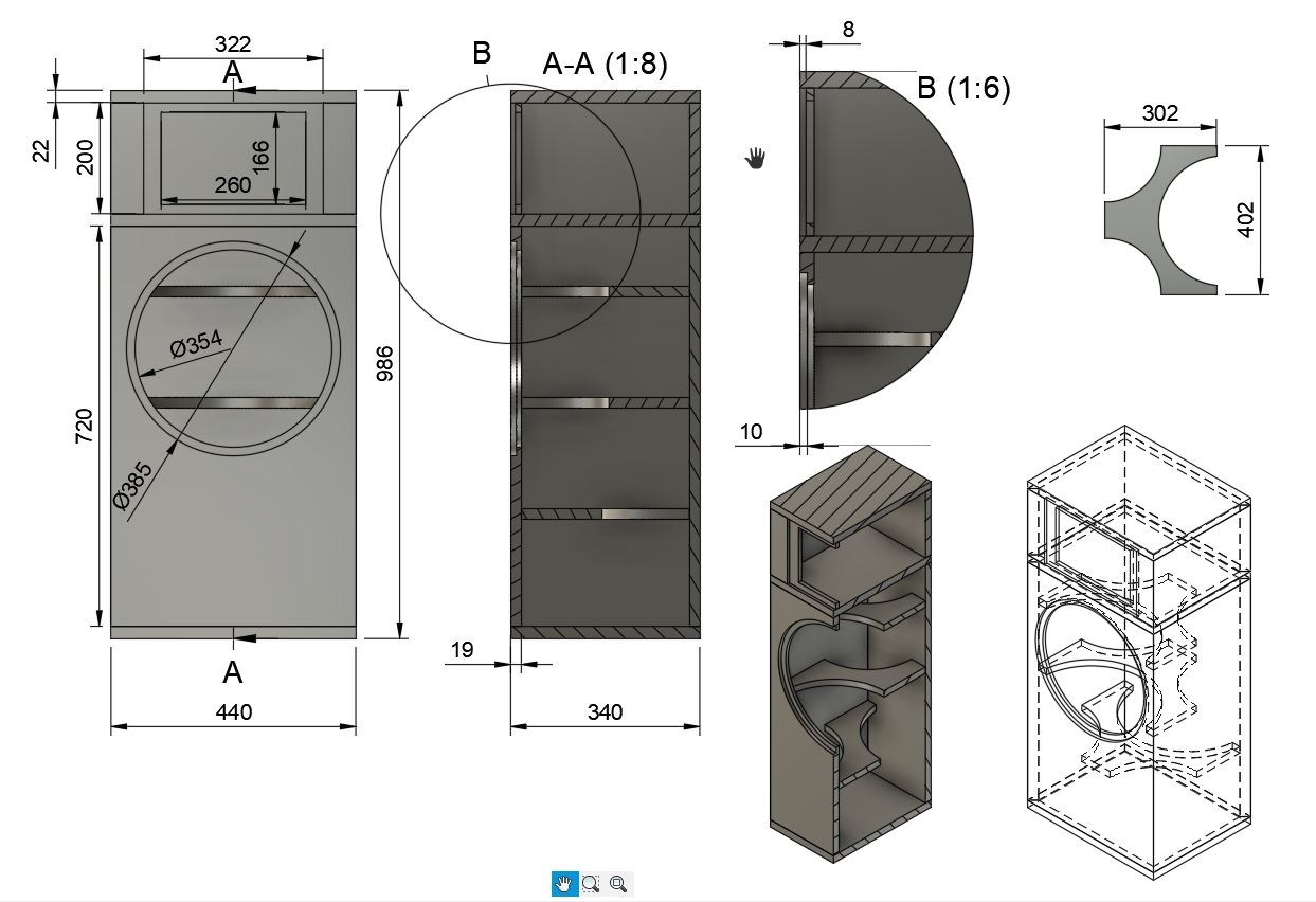

Would it be possible that you post the drawing's / stuffing of them speaker's along with the parts used for the horn, etc...

If something is not clear, I am happy to help. I will also make a drawing in Fusion360 soon.

I glued in small blocks in the area of the screws behind the woofer. Otherwise the wall thickness is too small for wood screws. With machine screws (unfortunately I don't know the English name) that's no problem.
The braces are only suggestions and can also be simple crosses made from scraps of wood.
Oh, and I think the Celetion Horn is only 320mm wide - I may have made it a little to big on the Plan.
