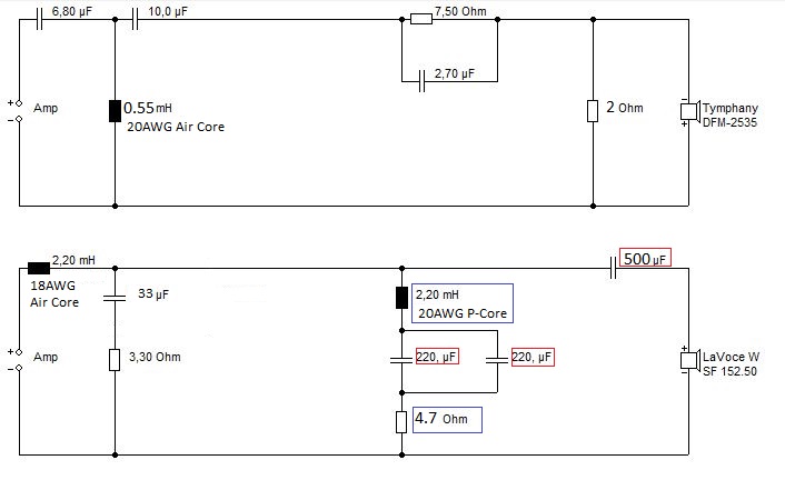

Raven made me aware that not all x-over parts are available in US. I have therefore adapted the x-over plan, taking into account the parts available at parts express.
For the coils I have given the AWG and type. Caps are foils such as these from Dayton:
Dayton Audio DMPC-6.8 6.8uF 250V Polypropylene Capacitor
Except for the caps, which I marked in red. These are electrolytic caps like this one:
500uF 100V Electrolytic Non-Polarized Crossover Capacitor
Resistors all with at least 10 watts.
The x-over components are unfortunately relatively expensive in the US. Maybe there are cheaper parts in other shops. Then please make sure that the coil and resistor, which I have marked in blue, together have a resistance of 5 ohms (+ -0.5 ohms).
In the example of my plan, the coil is 0.4 ohms and the resistor is 4.7 ohms. All together 5.1 ohms - fits. If you find a cheaper coil with e.g. 1.4 ohms, then please adjust the resistance accordingly to 3.7 or 3.3 ohms.

Rese66...
Do we have to invert the polarity on the tweeter (DFM-2535) as shown on the crossover?
Thank's; Jesper.
Yes, that is very important, otherwise the signals from the tweeter and woofer will be out of phase. The result would be a deep dip on the x-over frequency.
