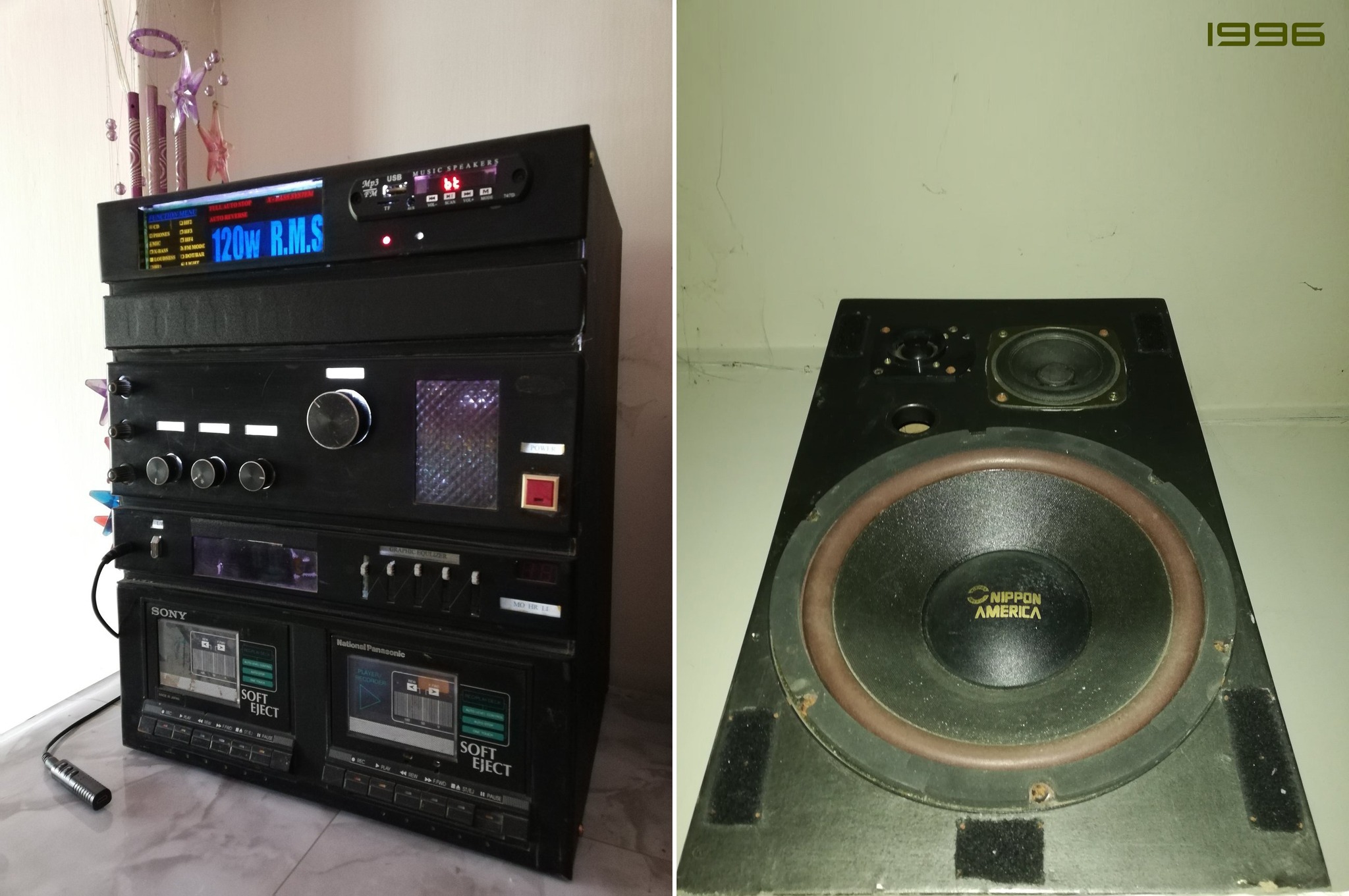

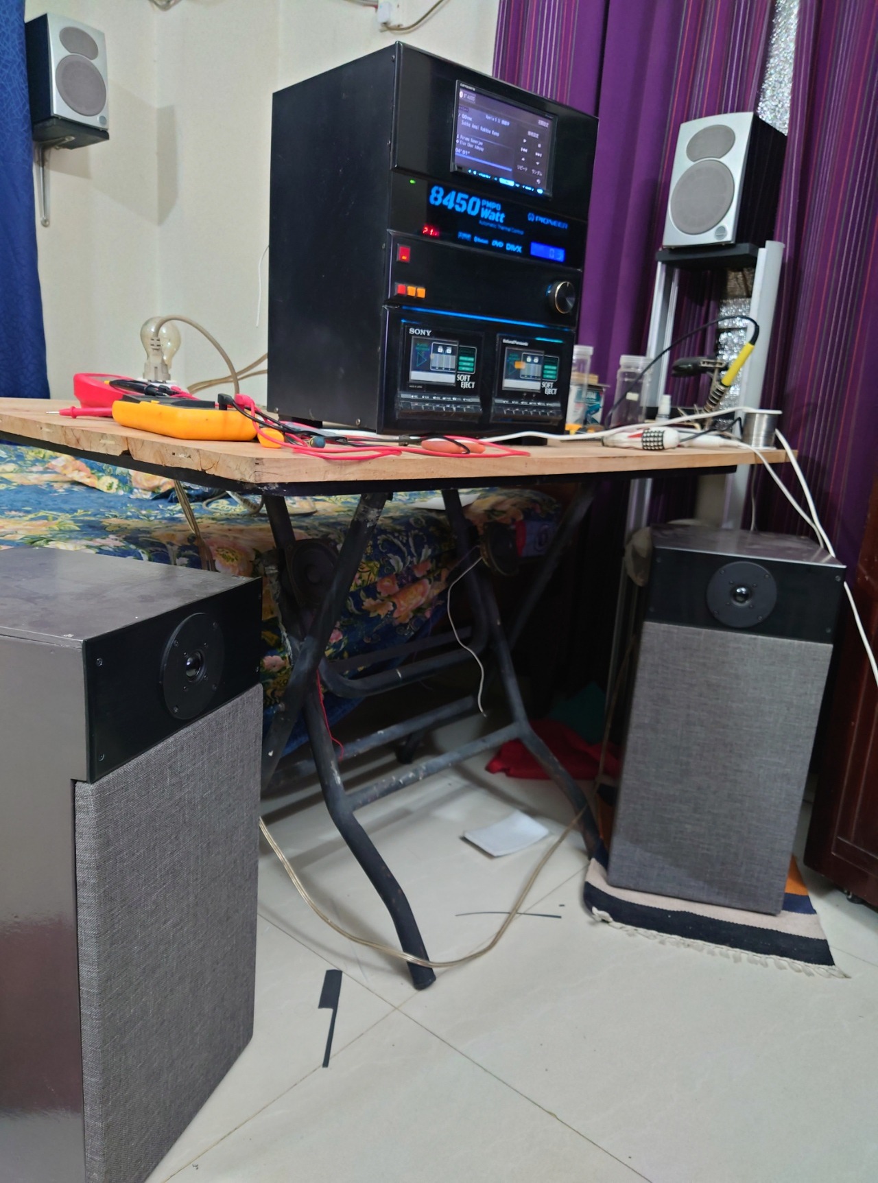

When I was in school, my friend and I used to visit music stores to purchase cassettes or record songs from LPs.
When we heard music from the deck set, we were ecstatic. and we assumed that only wealthy people could use that equipment.
When I was a college student in the 1990s, I took the initiative to build a Hi-Fi! I was told by my other friend that there is a man in Pabna City (150Km away from my home) who makes these kinds of chassis, so I went to his house to build the amp chassis, and I made it.
I moved away from home in 1999 to pursue a job and further my education in Dhaka (Capital of Bangladesh),
and as time went on, the sound system developed rust and dust accumulation, leading to malfunctions! Twenty years later,

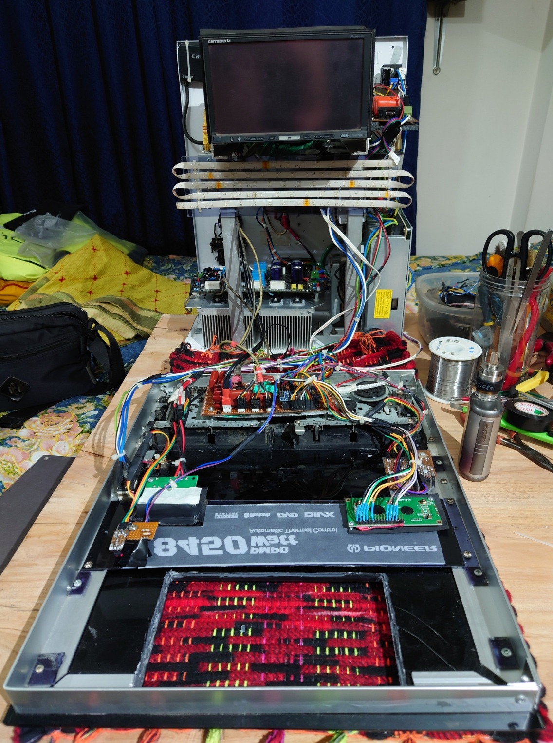

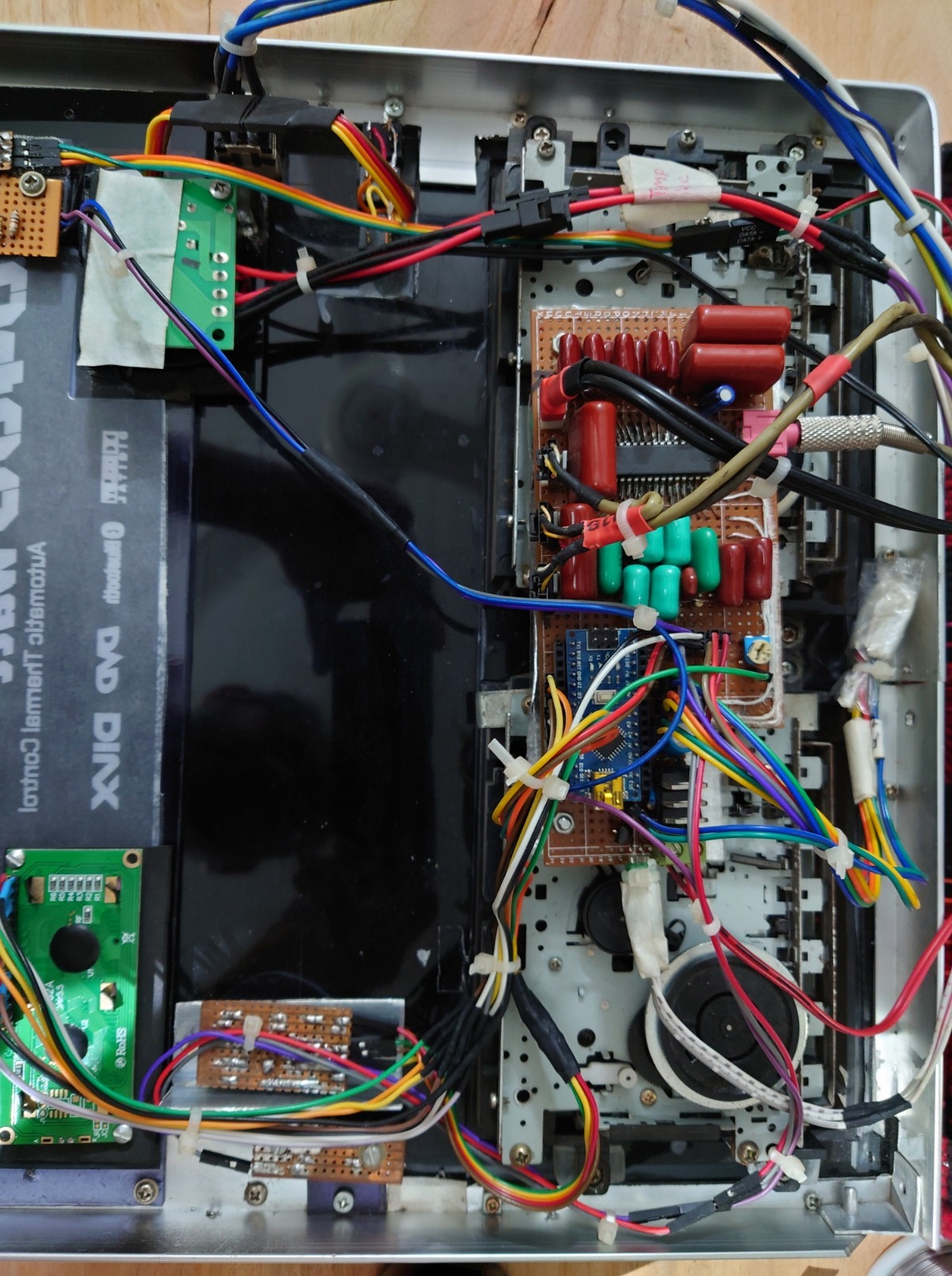

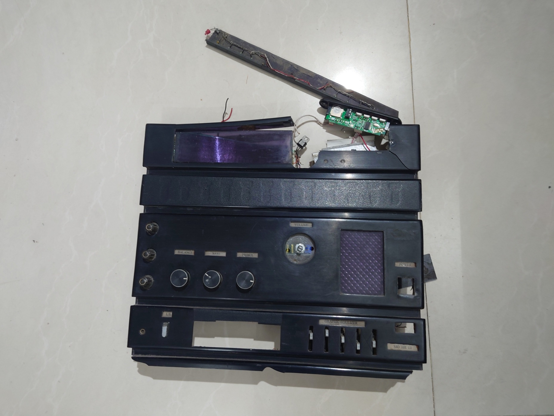

I decided to update the system. Last August, I transported the system from Rajshahi (My home Town) to Dhaka by courier service;
they broke the front panel. then I have taken a different approach, and this is it.
The cassette player is broken. I only keep it as a reminder of the 90s.

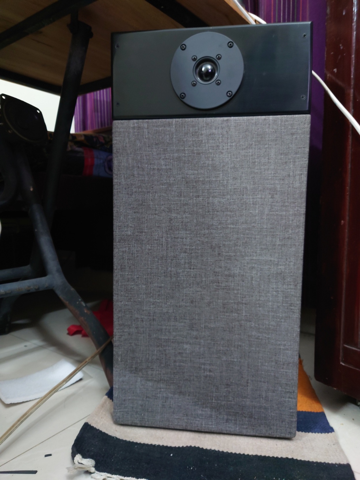

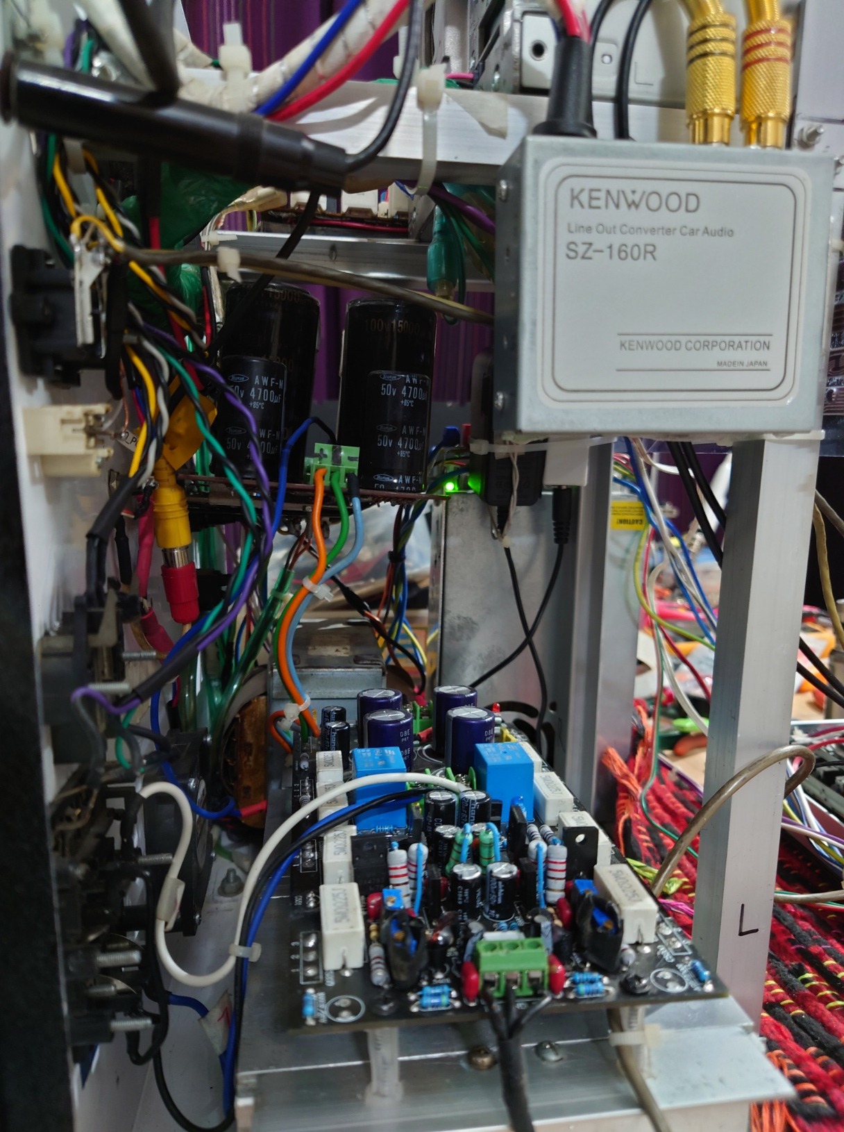

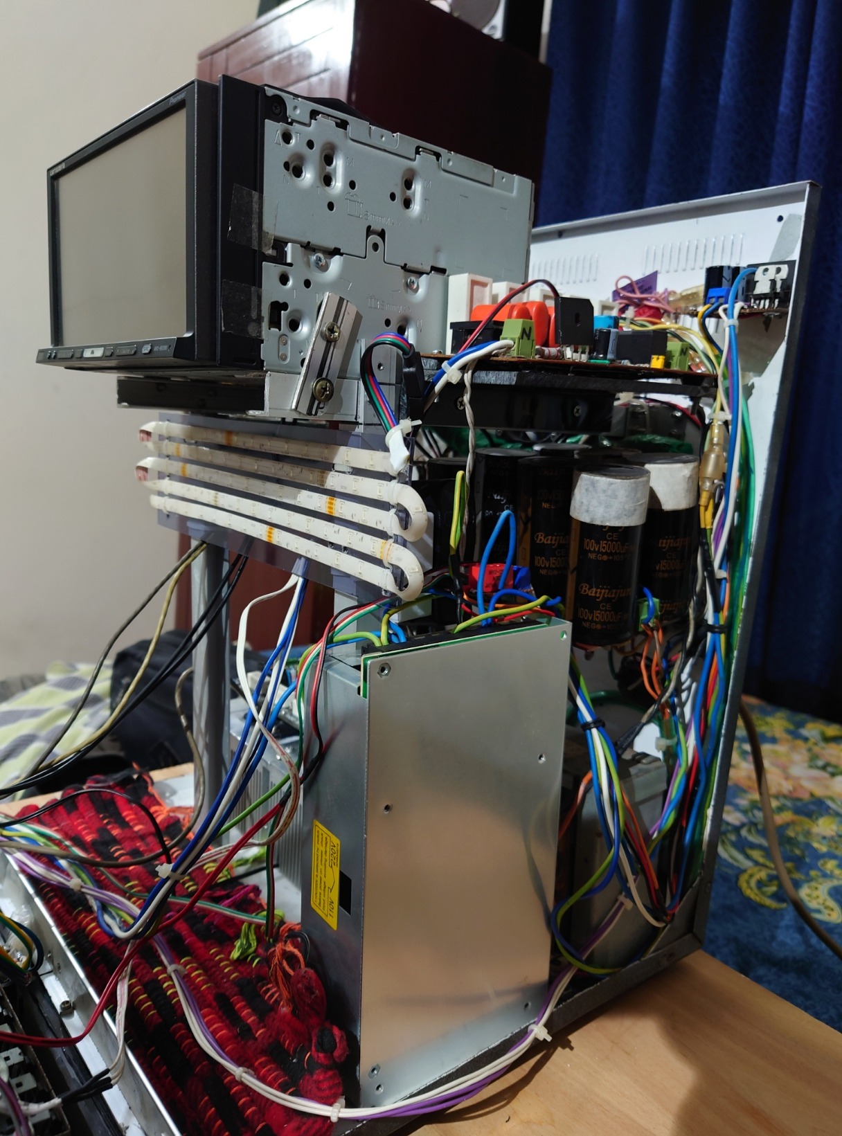

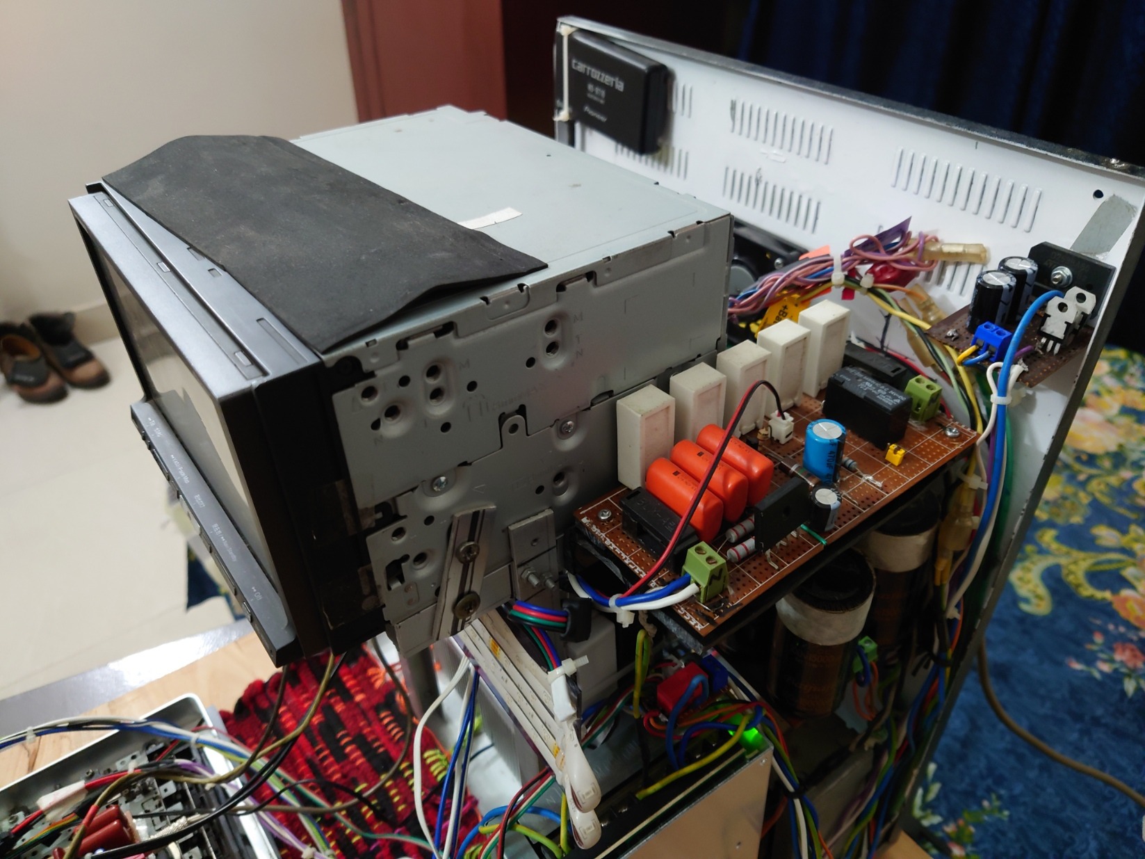

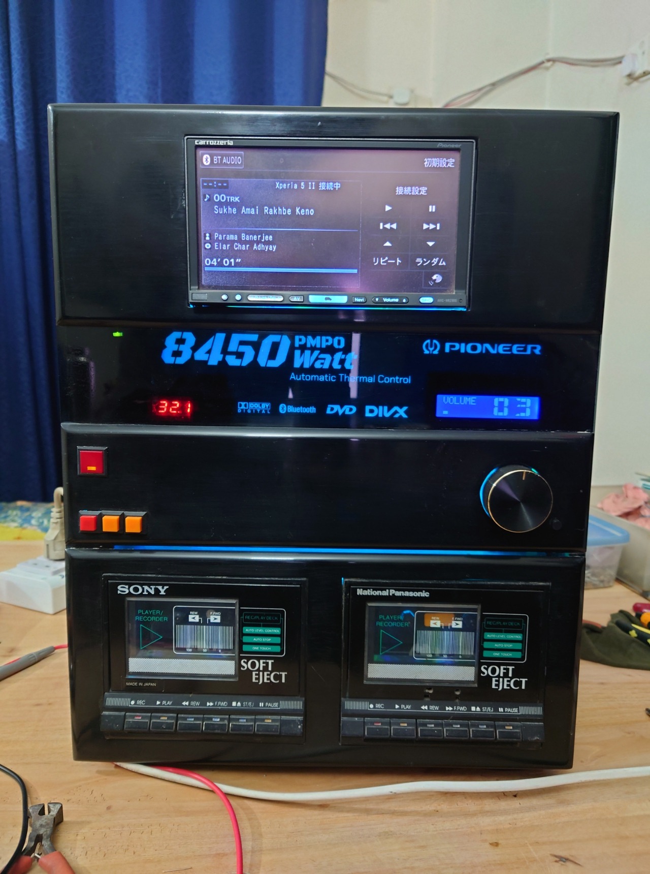

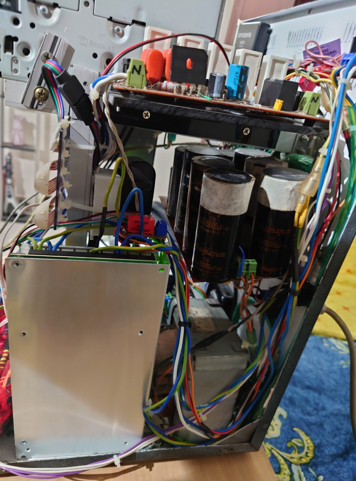

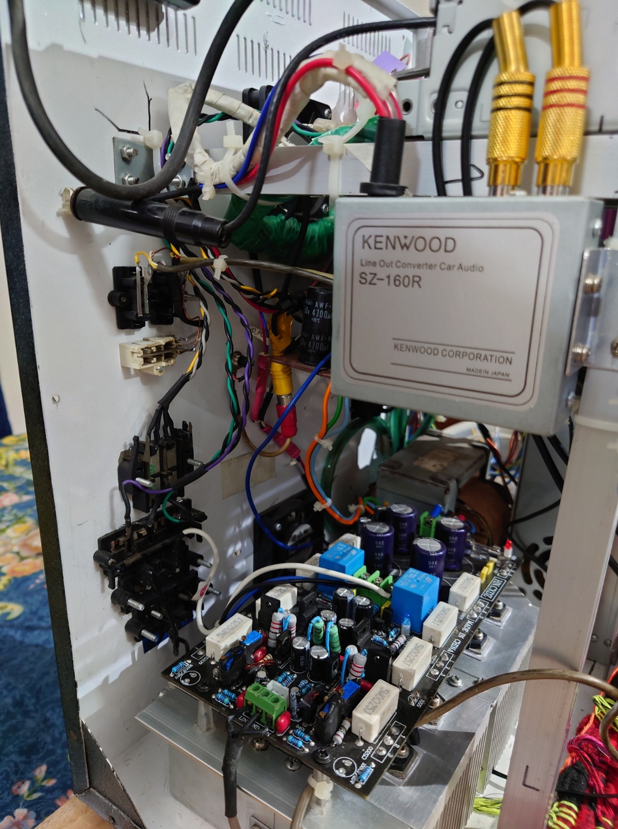

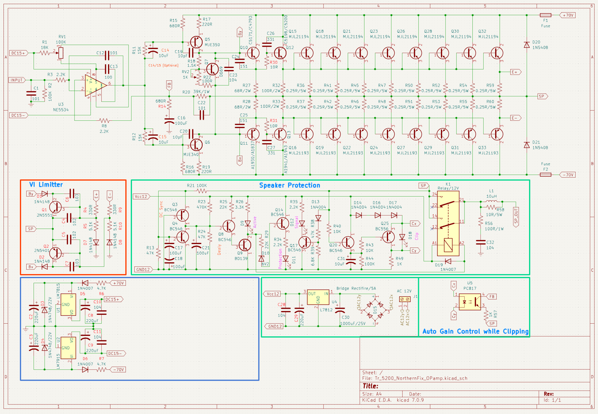

Hi everyone, I have changed the entire audio stage and replaced it with an op-amp [NE5534] and removed all base stopper resistors. I guess that will help to reduce PCB layout complexity. and I have not to bother for the DC offset. What is your opinion about that? Will it work?

That looks like the old BGW circuit, with a 5534 instead of the old LM318. Base to supply resistors on Q7 and Q8 are missing. VAS will go into limit. Compensation will need to be played with (C22 lead capacitor is too large and it will oscillate).
C14 and 15 are a risk item. When initially uncharged, they will cause high current in the VAS during turn on, and with it excessive bias in the output stage. The old hometaxial 2N6259’s used in the original design could take it. Not sure the modern ones will Indefinitely. And when you do it this way, you need to swap the + and - inputs on the op amp because of the phase reversal. Eventually even BGW added the normal level shift stage which eliminates both issues.

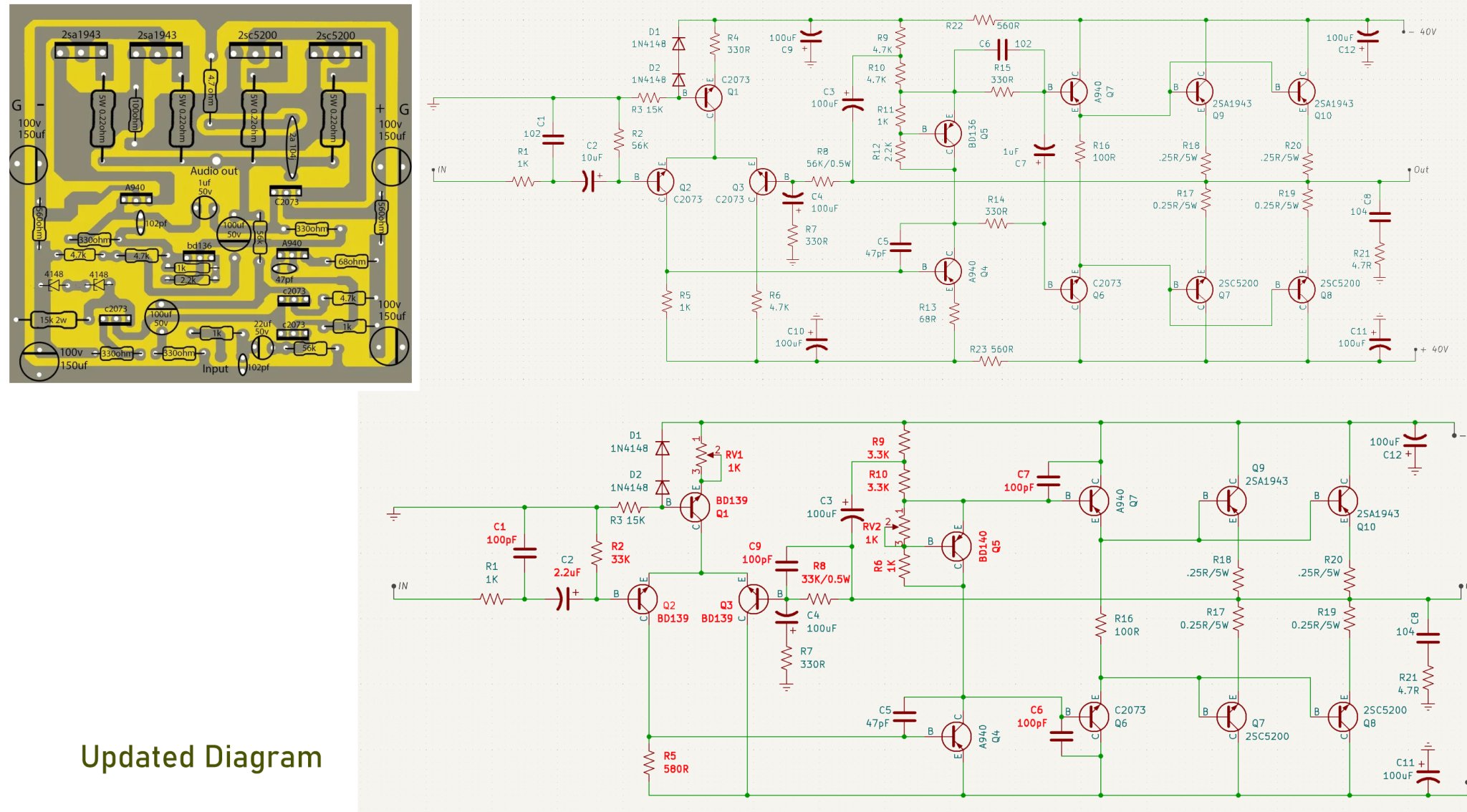

ok... then I will replace 2705/1145 pair(s) with bd139/bd140 or MJE340/350 that will be more simple. inv.input will be Input and noninv.inupt will be feedback right?

Sigh ... You really need to study the basics.
The input stage for the 5534 is messed up.
For the output stage, as the maximum output swing of 5534 is +/-13V (typ.) on +/-15V rail, one pair of 200W transistors would be enough to drive a 4 or 8 ohm speakers. No need for +/-70V rail nor 8 pairs of 200W transistors. Actually, you would want to avoid using +/-70V, as the timing of the turn on/off sequence of the +/-70V rails and +/-15V rails would be critical not to fry 5534.
It's not easy for opamps to drive uF range of capacitance. You will most likely need a series resistance at the output of 5534.
The values of the resistors for the input and feedback loop are too high for 5534 for the best S/N. Pick a JFET input opamp if you want to keep those values.
The gain is too high, as the maximum input voltage would be 0.15Vrms, that's kind a low.
There are many good designs for the Opamp + Output stage configuration on this forum. My sincere advice is to start by copying of one of them. One recent impressive example is:

The "gain control" by opto isolator looks super sketchy to me. I haven't analyzed the circuit in detail, so it's possible that I'm missing something, but it looks to me like you're planning to drastically reduce the gain of the amp when the amp is clipping. Are you confident that the amp will be stable at both the nominal gain and at the "clipping gain"? How much performance are you leaving on the table with this feature?
An easy way to turn this from a very expensive project and big boom on startup is to only populate one pair of output devices (Q32, Q33). Put a 10 Ω, 0.25 W resistor in series with each high-voltage rail. Often the resistors will smoke if the amplifier misbehaves.

Safer way to do the clip limiting is simply to attenuate the input signal upon loss of feedback. An LED/LDR type optocoupler is often used, as it introduces a minimum of distortion. An OTA can be used as a variable resistor, also in shunt with the input to do similar attenuation. Faster response, only a little more distortion, but unfortunately higher noise.
Populating only one output pair initially, and driving 20 to 30 ohms is the proper way to test any amplifier like this - new design, new build with proven design, or repair. Get the bugs out first. It’s a good use for the oddball transistors that don’t match. You are going to want to do at least crude matching of the parallel outputs if you want any sort of reliability. To get the best SOUND you want 3 mV Vbe match and 10% on hFE, at operating current. And between NPN and PNP banks, if you can swing it.

First, it helps to set the goal. Your first post is not clear.
Are you building 1000 watts PA amplifier? Number of outputs suggests that.
If PA, why not classD?
If not PA, do you really need 1000 watts?
Do you care about power or quality?
Wouldn't it make more sense first build kit? Have satisfaction from successful build?
If you however, want to design your own amplifiers, shouldn't you first read some books? Gather some theoretical knowledge? You either get knowledge by building, or by studying. Or both.
If you want to design your own circuit, copy- paste is not the best way. Simulation software is better approach. Designing 3-5 watt amplifiers first, before ten pairs of outputs on +/_70 volts is way to go. The way you are starting is not going to work, sorry.

@adason
Thanks. You have caught my intention.
** Yes, I am trying to make a PA.
** Power is an important issue. The PA can handle a 15-inch passive 2-way speaker system.
** Due to component availability in our local market, Class D will be quite challenging to build. almost 0% chances
Now the question is, why am I taking this step to build a PA?!! There is blank space in the market to locally produce entry level PA; that can perform a 50–100-person event or indoor program. The market will accept me or not; that does not matter. The matter is that I'm trying to build a PA that can comply with at least 80% of the standard parameters. locally designed or copied PCBs are junk. How they got those circuit diagrams and who gave it to them, only God knows. I have attached some locally made PCB.
I hope you get my point. and I'm guessing you are quite a bit confused!! Actually, it's quite hard for you to assume that how third-world countries like Bangladesh run. Our social and economic parameters are different, which reflects on our work. though we are trying to overcome this.

- As I create my first amplifier diagram, I eagerly await your feedback
