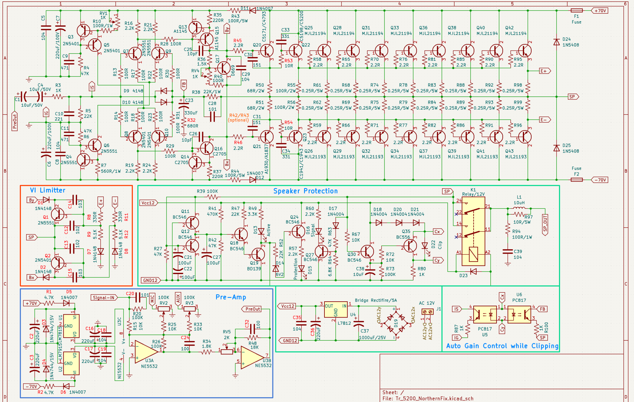

As I create my first amplifier diagram, I eagerly await your feedback
Amplifiers with that many power transistors are not easy to make PCBs for. Making everything align properly on the heat sink and fit into the chassis will make you go through multiple “generations” before everything FITS TOGETHER properly enough to actually be able to build it. Unless you’re going to get all those parts custom manufactured and machined from CAD drawings. And pay thousands of dollars to get it done.
Then it has to work electrically, as you intended it to. Following Selfs 11 cardinal rules concerning EM compatibility get exponentially harder with each pair you add.
It has to be designed together, electrically, mechanically and thermally as a system. Physical construction needs to be worked out, long before a schematic is finalized. I don’t see anything “wrong” with the design, and other than some minor optimization, will WORK, and work safely/reliably if the physical construction is up to snuff.

R52 and R53 I would move to 1 ohm
These are driver / outputs you may overload them before the others kick in .
The design here lends itself to 4 1n4148's as the VAS bias circuit with 1 ohm driver resistors.
Your preamp won't pass any signal the first 5532 has no resistor in its feedback 2 *27k would work. Your volume pot is in wrong spot. Reverse position with 10k feedback resistor.
220 ohm amp feedback to 1k.

R25, R26, D11, and D12 are in the wrong place. See Leach's schematic.
The abundance of 100 ohm resistors tells me that the designer did not know how to calculate the values, or whether the resistor was necessary. The amplifier probably works, but not very well.

Transistors 2SD669, 2SC5171, 2SA1930, 2SC4793, 2SA1837, 2SC2705, 2SA1145 are all obsolete and hard to obtain. I strongly advise not to use any of those you can buy on eBay or Aliexpress. Those are all fake. There may be some that are genuine, but the chance of getting them is slim. In the place of 2SC5171/2SA1930, you can use TTC011B/TTA006B pair. Others may have suggestions for the substitute for 2SC2705/2SA1145 pair.
MJL21193G and MJL21194G have limited fT at 4MHz. Why not use 2SC5200/2SA1941 (or current models, TTC5200/TTA1941) instead since you are already using them?
By using lateral MOSFET (like ECW20P20 / ECW20N20 pair from Exicon, 200V, 16A, 250W parts), you can worry less about the thermal management of the output stage. Since this is your first project, you may want to reduce some issues that are dependent on execution of the design, like where and how to mount the transistors for the thermal compenstation of the output stage.
I would make the input stage transistors cascoded at this voltage.
As others have mentioned, you may want to consider the value and neccesities of some 100 ohm resistors. Some are not required and some should be in different values.

There is nothing wrong with 4 MHz output transistors if you are using them in a triple EF with sustained beta high fT parts in both of the other positions. It will likely give you less trouble with stability with that many spread out all over the place. Fast parts don’t like long distributed buses with lots of inductance that you cannot remove. Keep the base stoppers on the outputs, but drop them to 1 or 2 Ohms. You need something, but not much. Bump the Rbe to between 5 and 20 ohms to increase the current in the C5200 (or C5242, Fairchild’s easier to find version of C5198) drivers. That will also improve switch off time in the 4 MHz outputs.

Hi there, The schematic could not be completed without your help. Many thanks.
I attempted to include your suggestions into the diagram (Attachment).
I think the Q13/15 & Q14/16 are a darlington pair. Should I keep these two or swap them out for 2SC517 & 2SA1930?

I use discrete darlingtons in VAS. With the first collector tied to ground and with Rbe set to force about 2 mA in the first transistor. If you do that you can use beefy second transistors and not worry about a 25 or 30 pF Cob ruining things.
With due respect, that is not design but a mishmash of bits and pieces copypasted from all over the world.
I can not kludge together a Ferrari transmission, a Trabant chassis, 4 various sized wheels, a carburetor, a Diesel engine, and say: "hey, look at the car I designed", even if all those are car parts and work fine in their original designs.
Errors here and there, some gross, such as the zero gain input buffer (meaning NO signal will get through), the potentially infinite gain (or at least open loop) following next stage, the 100 ohm input impedance, etc.
As suggested above, start studying the basics, then go step by step.
As in there are some 15-20 steps to reach this level of complexity.
