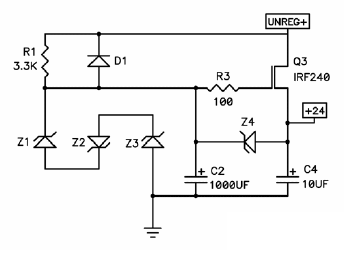

May be somebody with a bit experience in PCB layout could add a buffer? I would assume it is possible to move the existing buffer to the left and add one for the inverted signal without too much trouble?
There will be a new GB for the PCBs soon... perfect opportunity to upgrade to balanced/buffered if we have a layout. 😀

Are you referring to a 20 ohm pot in the buffer?
I should rephrase my question. As part of startup/final adjustments what do I need to think about with the 20K pot on the input buffer?
Dan 😕

He is reminding you that it's a 20 Ohm not 20,000 Ohms.
As for adjusting it. Just make sure the wiper is at 0 volts when the amps is warmed up and running. 🙂
The 20K pot that's part of the buffer adjusts the dc offset at the output?
Dan 😕
The optional Jfet 'buffer' you are talking about feeds the input of the transformer. It is a 20 ohm pot, it needs to be adjusted for 0 dc on OUTPUT of BUFFER, not output of amplifier!
Having 0 dc on the buffer output keeps dc from the input windings of the transformer which would saturate the transformer and limit bass response, I think.
If you are using the buffer, you need one for each balanced input. For RCA input you only need one buffer.
Whoooops!! Significant brain fart! I did do 20K instead of 20!

you can directly feed xformer with balanced signal , in floating mode
if you need buffer prior to xformer - it is SE on the board , so only SE input
for balanced buffered , then you need balanced buffer , which is two SE buffers in fact ....... and you're not having that on board
completely other approach is using stereo F6 in bridged ........ in which case one channel is fed from XLR positive (pin 2) , other from XLR negative (pin 3) , and outputs are taken from channel's hots ........
