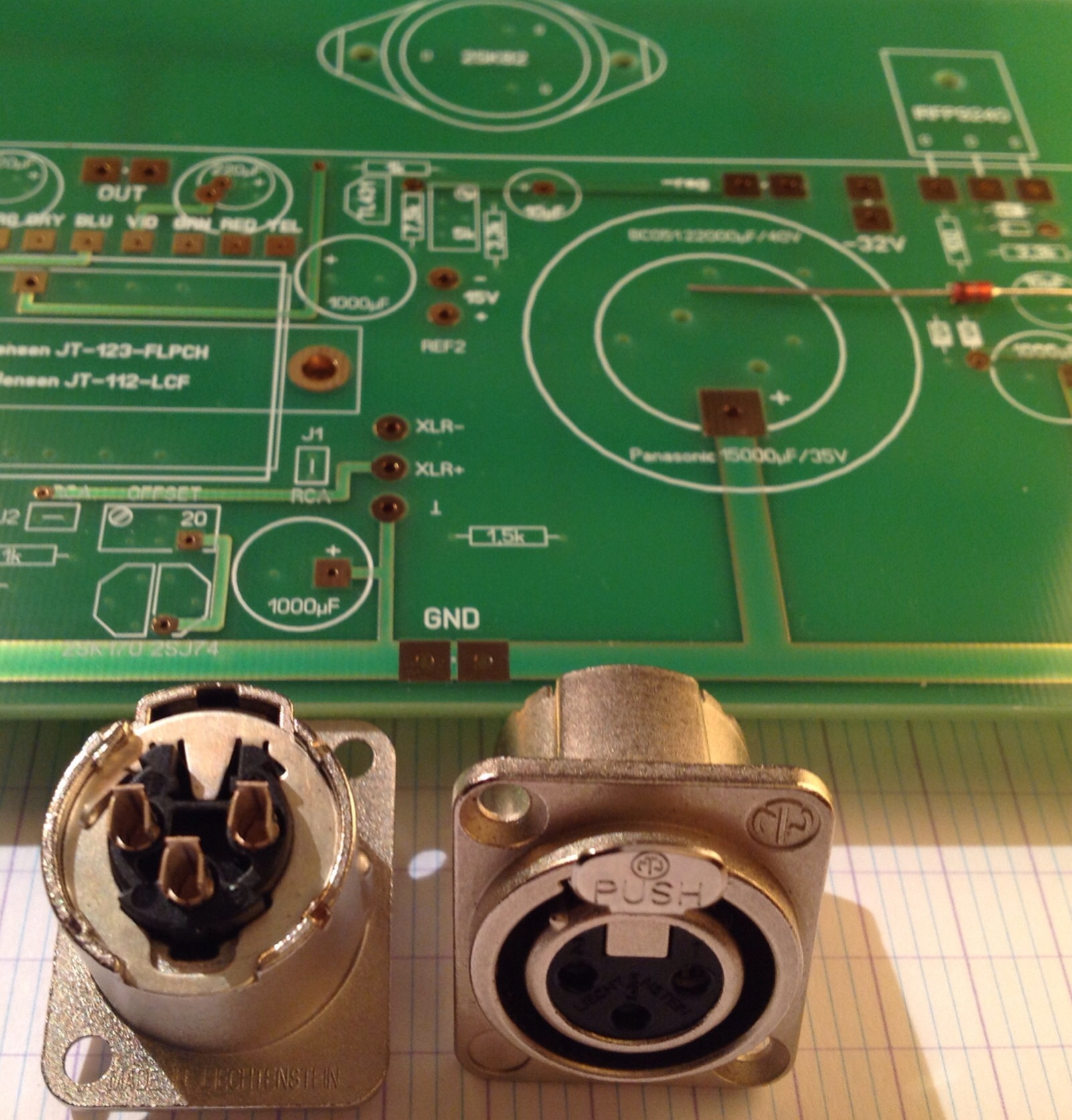

Probably a very silly question but anyway - if the amplifier based on Georgs PCBs is run via XLR, doesn't the buffer buffer only the positive signal?

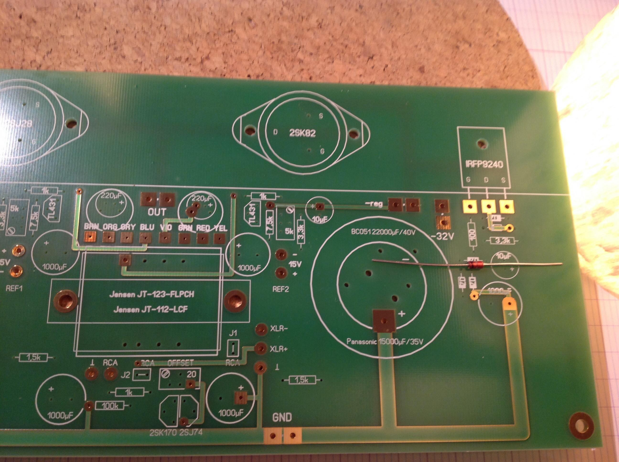

that is interesting! I downloaded a Gerber viewer and inverted the bottom side and made a scan of my still unpopulated bottom side pcb and found
yes you are right two longer lines i painted red on the original picture are gone…..
but 🙂 there are instead two small connections in the new layout in the red circles that seem to substitute the long lines….
Please more eyes!
Makes sense Gerd...although i don't like sharp corners in PCB tracks....but maybe that's just aesthetics......

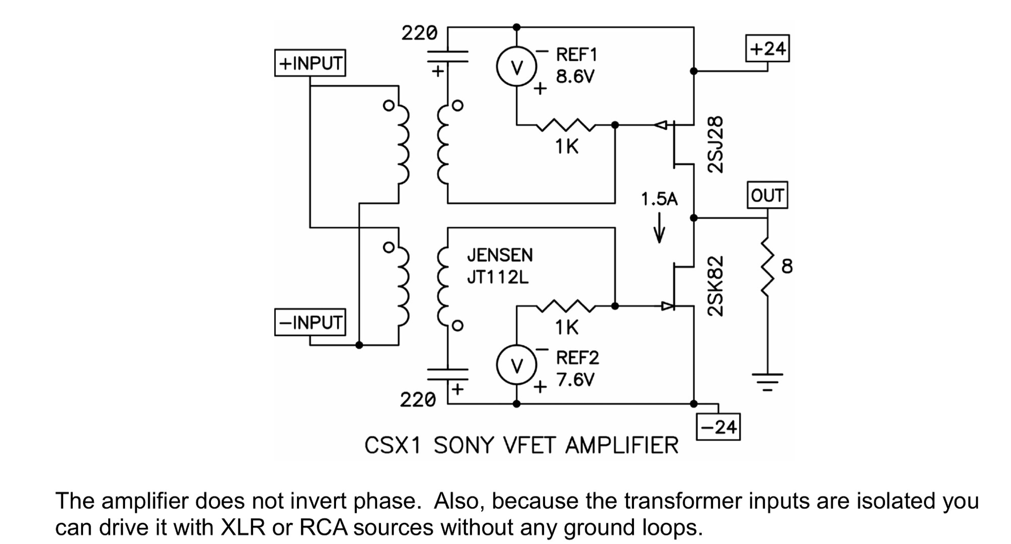

GreatIf I recall, the amplifier's input is simply an isolated transformer primary -
you can connect it any way you like.

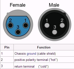

From balanced audio source they are (+) phase (-) phase and shield who go to CSX 1 transformer xlr(+) and xlr(-) input.Probably a very silly question but anyway - if the amplifier based on Georgs PCBs is run via XLR, doesn't the buffer buffer only the positive signal?An externally hosted image should be here but it was not working when we last tested it.

Ps. Pcb holes for zeners 9,1V 0,5 watt are to small i must redrill them.
With higher diameter can easyer life after next pcb's run 🙂

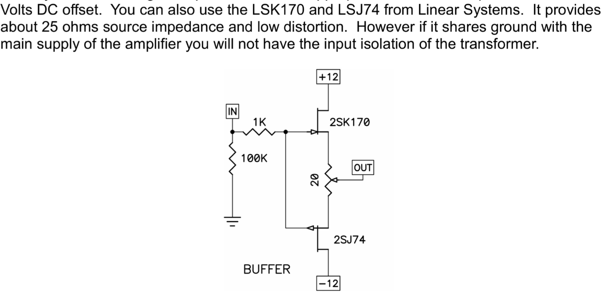

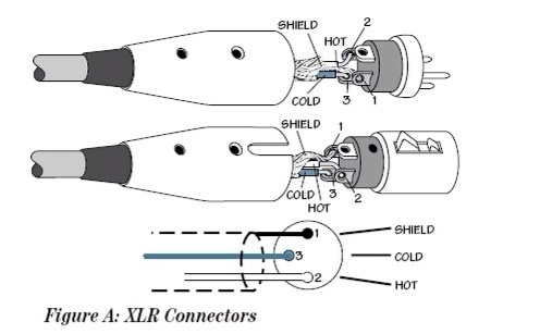

@Soundhappy: Yes I have understood what I need to do in order to use the PCB with balanced inputs. My question was - when I look at the PCB the buffer seems to "touch" only the positive signal? What about the negative?
You are correct that the buffer only 'touches one side of the signal', the buffer itself is single ended. The XLR connections go directly to the xformer and do not pass through the buffer at all.
It is not possible to use the single ended buffer with balanced input as is - in a balanced signal the positive and negative are referenced to each other - not to ground/earth. You cannot connect just the positive because there is nothing then to reference against (and hence no voltage difference to amplify). You cannot connect the negative because there is nowhere to put it - it can never go to ground.
So the options are to not use the buffer and go direct to the xformer, use a balanced buffer on another pcb board if you need a buffer and take the balanced output from that buffer direct to the xformer on Georg's board or use a balanced to single ended transformer at the input of the amp to get a single-ended signal and then feed that into the buffer on the PCB.
If your balanced source has low enough impedance then bypassing the buffer and just going direct to the CSX1 transformer is likely the best option. If not then it may be worth looking for a balanced buffer schematic/kit that you could use.

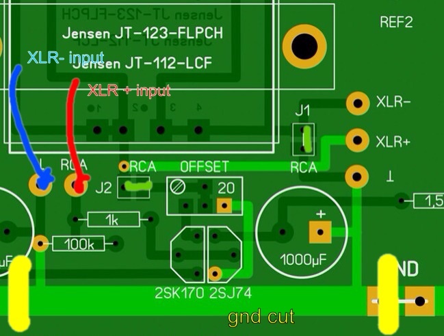

I have today look at on buffer schematic & corespondance with pcb
and for rca input all is connected if jumpers J1 , J2 are close on pcb tracks.
Xlr are not connected at all to the buffer !
J1, J2 is in open pcb tracks position if xlr is used.
I was confused with J2 happily the are smart guys to clarify the things.

Ian, I re-read your post and I'm not sure if you are completely right about the balanced signal? In my opinion the positive and negative signals do have a voltage against ground. It would be an option to just use the positive half, however that would of course defeat the purpose of the balanced signal.
Is it possible to add another buffer to the PCB for the "negative" signal? Anybody up for it? 🙂

Hi Sven,
After reading some more literature it looks like I was wrong to say that they are only differential to each other.
It is possible to connect the positive to the single ended input.
There is still a question of what to do with the negative - apparently this depends on the output stage of the pre-amp. In many cases this can be tied to ground, but in some cases it cannot and should be left floating.
Ian
Hi Diyers
Could with this modifications it work good ?
Jumpers close pcb tracks and gnd is separated from the buffer circuit.
Greetings
Greetings
Chris

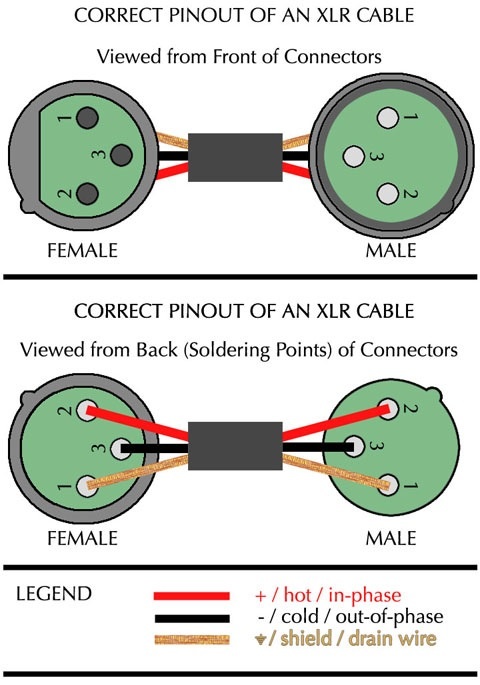

you can directly feed xformer with balanced signal , in floating mode
if you need buffer prior to xformer - it is SE on the board , so only SE input
for balanced buffered , then you need balanced buffer , which is two SE buffers in fact ....... and you're not having that on board
completely other approach is using stereo F6 in bridged ........ in which case one channel is fed from XLR positive (pin 2) , other from XLR negative (pin 3) , and outputs are taken from channel's hots ........

To make this board work for either RCA or XLR input, could you use a DPST switch for J1 and J2? I currently use XLR balanced out of my pre-amp, but that could change one day. On my DIY Aleph J I have a switch to ground the pins, but it's not that simple with this board.
