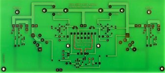

Already posted over in the GB thread, try my luck here too:
Has anybody 2 PCBs I could buy? Has anybody the knowhow/time to create eagle files from the pictures of the 240mmX107 PCB?
Many Thanks
Sven
I'm on it. None of us German friends of Georg (Permaneder) has his original design, but I'm recreating the PCB layout and gerbers. I'll make them available in the near future.

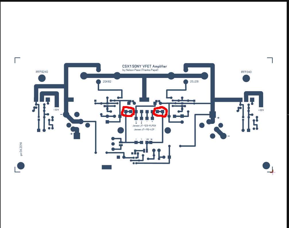

Tadaaaa ! 😀
Here are the Gerbers from Georg - from 3rd June 2014.
I am offering to do one production-run with the PCB manufacturer selected by Georg. They're making high quality PCBs, based in Europe.
However, I don't have the time to run a GB. If someone volunteers, I'll take care of production and would be willing to ship out one package with PCBs per region. Will write more in the original GB thread.
View attachment CSX_SONY_VFET-140530.ZIP
-Oliver
Tadaaaa ! 😀
-Oliver

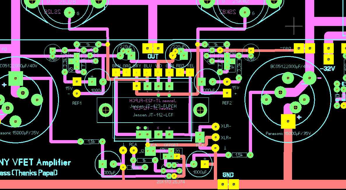

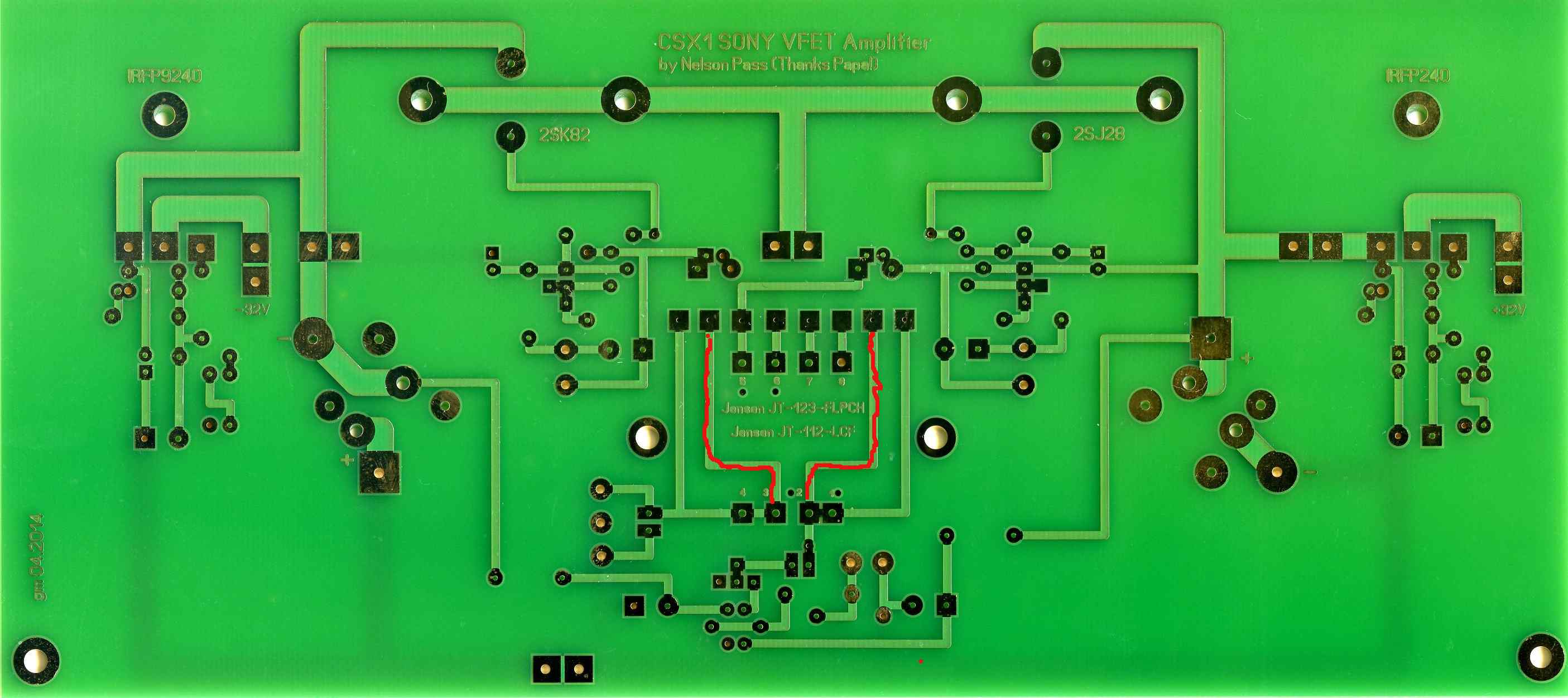

hi dsdjoy,
thanks for share the files...
btw are you sure it is the latest version?
i think there are some missing track compared to the latest one.
missing line at the jensen transformer.
is that OK..?

hi dsdjoy,
is that OK..?
O.K.
that is interesting! I downloaded a Gerber viewer and inverted the bottom side and made a scan of my still unpopulated bottom side pcb and found
yes you are right two longer lines i painted red on the original picture are gone…..
but 🙂 there are instead two small connections in the new layout in the red circles that seem to substitute the long lines….
Please more eyes!

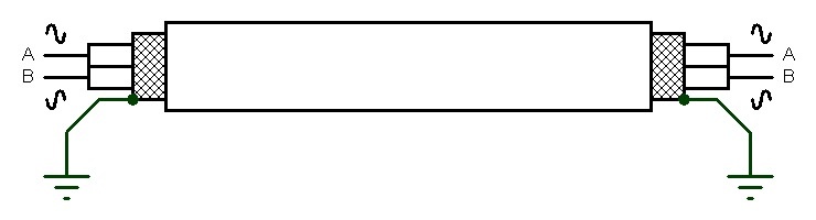

Hi Diyers
Today audio music sources are with XLR outputs ex :
DAC's, audio cards , digital music servers and hi standard cd players etc....
That way CSX1 amp input with symmetric xlr cables give most supression of noise floor
artefacts by cancelation in opposite phase -60dB.
In theory is work but something new to me most time i am rca user
so next interesting modification for rediscover music albums collection 🙂
On picture mono symetric cable for balanced input like in CSX1 Vfet amp.
What Yours experience ?

If I recall, the amplifier's input is simply an isolated transformer primary -
you can connect it any way you like.
