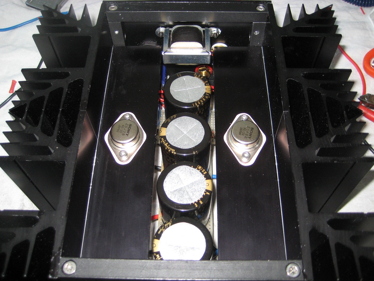

It's quit hot here in Holland, my room temperature is reaching 24C 😛
And my VFET transistors reach about 72C on top, is that long term OK?
I can listen few hours to it without problems, but I want to be sure that I'm not slowly destroying my VFETs. ( and probably my speaker woofer).
I have been thinking about reducing the temperature by putting an extra SK88 in between, it can be done quit easily with using the same backpanels and frontpanels.
Or is 72C just fine?

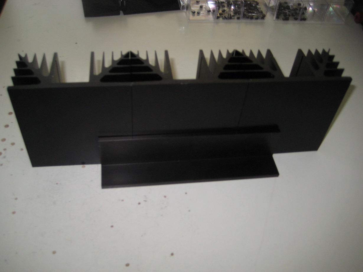

I know..... but L one thicker than 40 x 40 x 5mm is very hard to find.
But I hope someone can answer with arguments, if 72C is acceptable for the VFET.... or not🙁
WINKEL | ALUMINIUM | alu-verkauf.de GmbH
yes, I have searched similar shops in Holland, but in 40 x 40 it is max. 5mm.
For thicker I have to take a 50 x 50 x 8, but that's not gone work in my little monoblock:
Hi WalterW. You maybe the one who will answer the question regarding continuous operation at 72 Celsius; clearly with a potential risk to the health of the VFETs. Do you keep your system on all day or turn it on only to listen to it, and if so for how long? During its idle time if any, may consider a standby mode whereby the power rails are intentionally decreased for example to +/-15V by using a VARIAC; if that is a viable option.
I've used reuseable cold packs [hermetically sealed from CVS Pharmacy] on small heat sink fins to protect high dissipating semis. It was an effective and quiet bandaid remedy; but with regular trips to the cold box of the refrigerator to fetch other refreshing cold packs. You'll be able to profile the impact of this cooling method since you already measure temperature. And will also temporarily allay you fears.

I would say no at running the case (Tc) @ 72C. What is the bias, 1.2A? 1.2A@24v Drain-Source is almost 30W dissipation.
I have no idea what the thermal resistance is from junction to case but would guess about 1K/W form a rather old device like this.
This means that your VFET/SIT die would be at 102C (if Tj-Tc is 1K/W) as an estimate. I would not run a semiconductor at that temp for any long time. No 24/7 if you want it to last long and be reliable imo.
These are 90 watt parts, probably with an internal thermal resistance of 1.5
deg/watt, and a 150+ deg junction rating.
At 72 deg on the case, the max dissipation would be about 40 watts.
Read the article a little more in detail and see that Id is 1.5a at 24v Drain-Source, so 36W dissipation then. If Tj-Tc is ~1.5 K/W that makes the die temperature at estimate 126C if the SIT case is at 72C.
I don't know but the datasheet says Tj max is 120C. I would not sleep happy even if the datasheet said Tj max = 150C if the die temp was ~126C.
But it would be nice to know how long the SIT would work @ 126C Tj in a setup running 24/7 🙂

what I meant - make L heat spreader long as heatsinks ; 40x40x5 is , say , good enough
then , if needed , make baby-sitter for amps , if temp is still higher then 50C on heatsink
yup - 70C is too much , be it on TO3 case ......... or heatsink (even worse)
About the L bracket what about using 2 of the 40 X 5 connected back to back to make a T shaped bracket this would also spread the heat on the heatsink a lot more. True it would take a lot of heatsink compound .....
