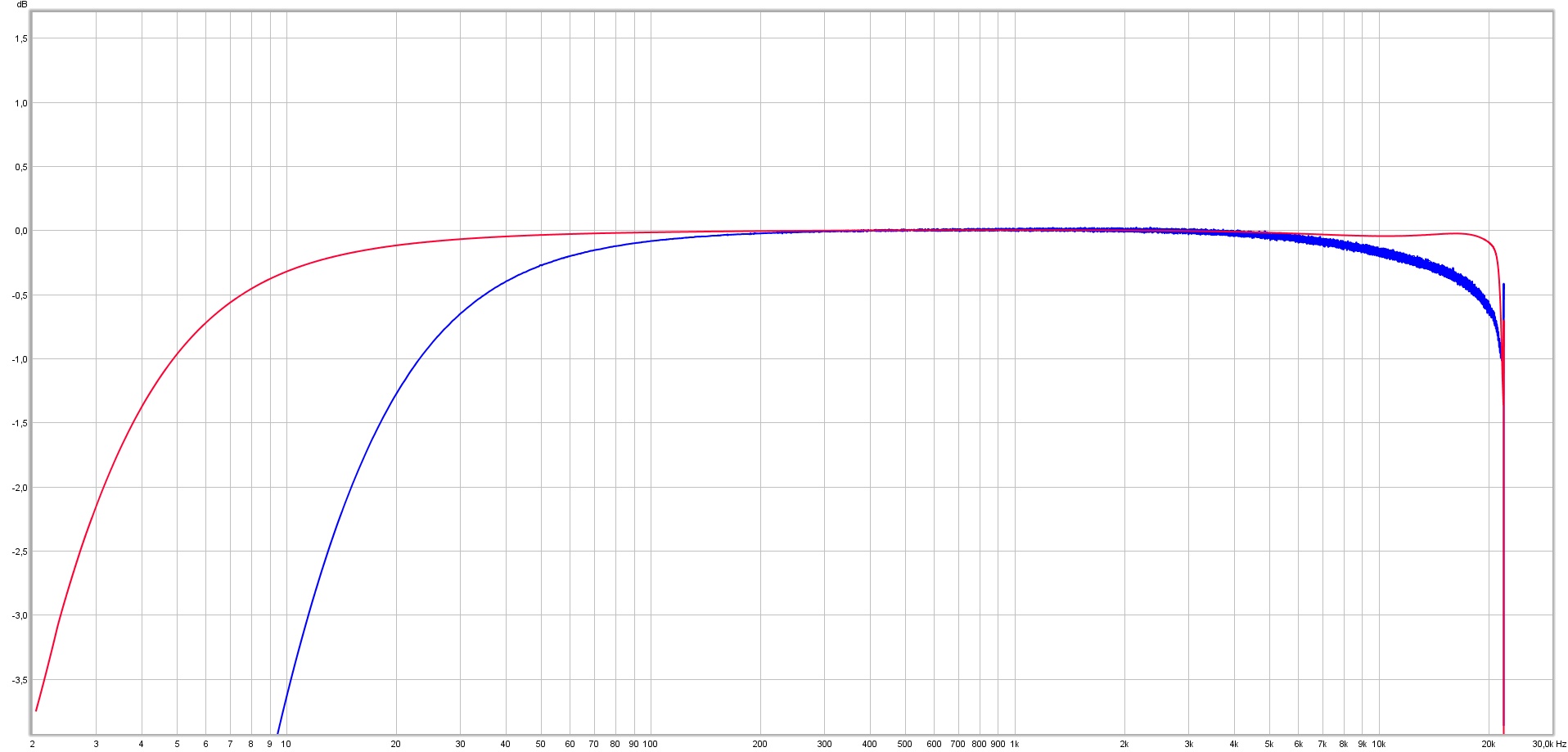

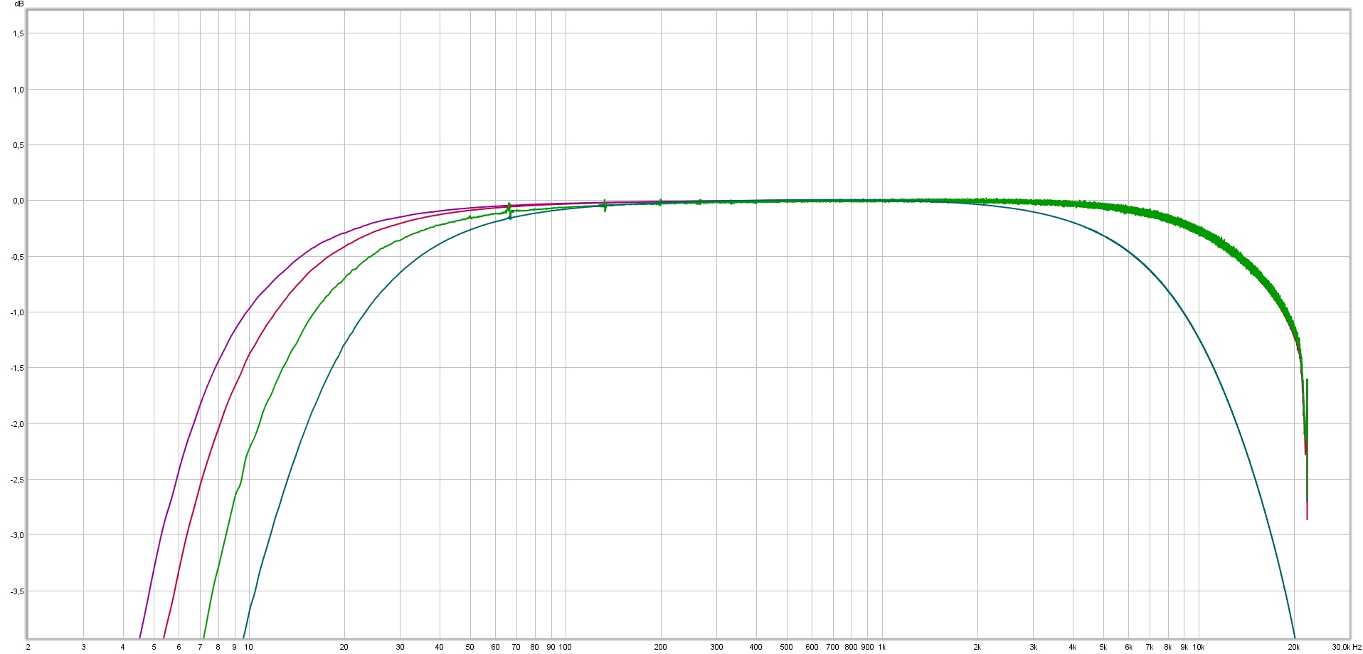

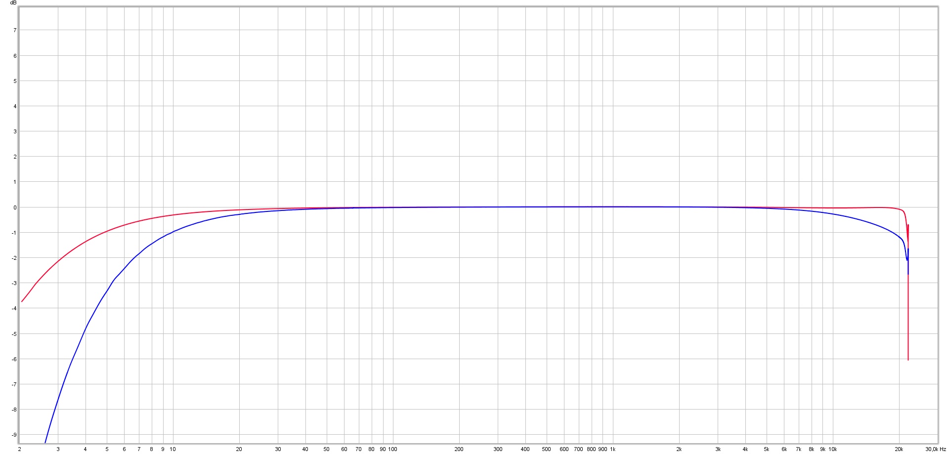

I noticed a difference when playing with the two volume controls on the Steinberg UR22 and Focusrite 2i2. They were very sensitive to where the knops where turned. I have seen it with other cheap sound cards too. Can someone explain this? I see some variation with my more expensive Sound Devices USBPre-2 as well, but far less.
Here's the Steinberg with different volume settings:
attachment.php
Here's the Focusrite with different volume settings:
attachment.php
If I remember correctly, this was the best I achieved with both.

As you see result in single channel mode is almost excellent. What happens in dual channel mode. There are several possible source of errors:
1) in loopback mode (in unbalanced connection) we have ground loop (that is why I decouple I/O ground with 1k resistor in ARTA measurement box)
2) soundcard input channels have large crosscoupling
3) reference signal has high distortion
4) sometimes bad contacts also make problems
Hi Ivo,
Wouldn't those factors also apply for the dual channel PN measurement?
I had in mind another potential contribution when I suggested trying single channel mode, the decreasing LF content in the reference channel as frequency approaches zero and the difficulty of (in effect) dividing one ever smaller level by another, with noise becoming increasingly dominant, plus the additional complication of the input and reference channels almost certainly having slightly different LF rolloff points due to component tolerance. Are those not factors?

I do not have ur22 or 2i2 shematics, but it seems they are coming from the same outsourcing development.
What you have measured can probably be explained with some capacitor in potentiometer path.

In one my paper I suggest the use of single channel mode with soundcards that has high low frequency cuttoff. In case of dual channel measurements then it happens what you were noticed, plus effect of difference in cutoff frequency. In practice I have noticed that this effect are acceptable in acoustical dual channel measurements if system has cutoff bellow 5Hz.
So, we always have to pay some price: in dual channel we get proper phase response but with some errors (ripple) on low frequencies. In practice this ripple is lower in audio band (20-2000Hz) than frequency response bias obtained with single channel mode.

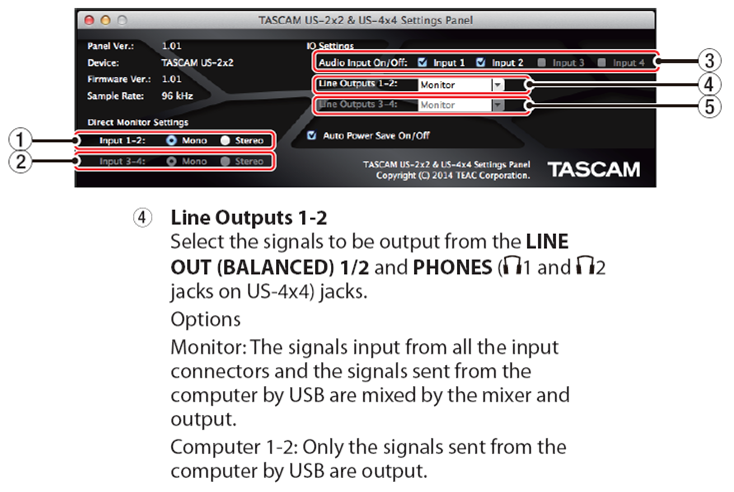

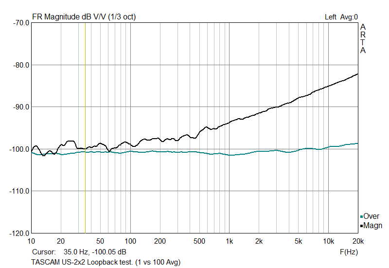

Had you tested the TASCAM US-2x2 yet? I have access to one for a bit and would be happy to run some tests if you let me know what you are interested in.
Attached is a quick sample of the TASCAM noise floor with and without 100x averaging.
One nice thing I noticed was that there is an option in the driver setting panel to use the digital signal directly for the output rather than the monitor signal which may have some residual from the inputs remaining. I couldn't find a similar setting for the UR22 which always uses the mixed monitor output.
Oh, also a service manual is readily available for the TASCAM.
If interested in seeing schematics, send me PM with contact info.

Bolster,
I did not wanted to make list of good card manufacturers, certainly many other firms make good sound cards. TASCAM is very good firm as it has own development and it makes good sound cards. I had US122 but now there is no driver for it. It had very good line input converters, but microphone amplifier had slightly large distortion. As I see in this new affordable series they made better microphone amplifier.
I would recommend ARTA users to buy cards from manufacturers that has their own development of sound cards, as it is some kind of garant for updating firmware and driver.
In manual I show testing done on line inputs (not on microphone inputs), with gain set to receive full scale -3dB signal (if possible).
Your example show how averaging greatly enlarge dynamic range (wow, 100dB of dynamic range over all audio banwidth was before few years dream even for most expensive Fourier analyzers).
