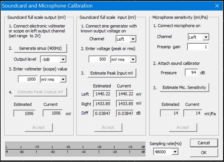

So Basic setup to start with. I calibrated the outputs from my E-mu 0404 RMS against three medium trustable measurements - a Fluke 77, an UT61E and about 2VPP on my scope. Good enough? If not please point out that there is a flaw in my thinking.
I put in 1464mV(rms) for right and 1463mV(rms) for the left channel. At first I used them as input for the E-mu 0404 which of course clipped every time after I decreased it some 10's of mV. So for the input I took my old PM5109 and started from the bottom whilst pressing the "Estimate Peak Input mV" and found that my Inputs can handle about 0.96mV(rms) before clipping. So loopback with max output was a waste of time - it could never work without overdriving the inputs. I repeated the finding b lowering the output until it worked and got the same mv(rms) as with the external oscillator.

Hi Turbon,
let me explain the problem of calibration.
Almost all soundcards have no calibrated volume controls, especially those that has hardware potentiometers. It means that we can calibrate voltage readings (dBV) or ratio to full scale sensitivity (dBFS) of soundcards only for one fixed position of potentiometer.
And this makes process of calibration complicated.
ARTA allows calibration for that fixed position of volume controls.
Input calibration value is voltage that is needed for exciting full input range.
Output signal level is not important, but we can use soundcard output signal to make calibration of input.
How we do that?
We first measure voltage of signal that ARTA generate by external voltmeter. Before that measurement it is important that we monitor spectrum of generated sine signal in loopback connection and set output level that do no push input into the clipping. A reasonable value is level that is 3dB (or more) bellow clipping (0dB).
In calibration of both input channel, in loopback connection, we use level that was measured with electronic voltmeter. We enter that value in edit box and ARTA makes further calculation of input voltage sensitivity (voltage that will fully excite input for fixed level of volume control or potentiometer).
After we make calibration we are able to monitor signal that has voltage lower than input sensitivity. The scalling of spectrum can be chosen to show dBFS, dBV of power spectrum density (dBV/sqrt(Hz)).

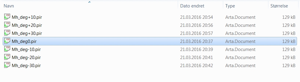

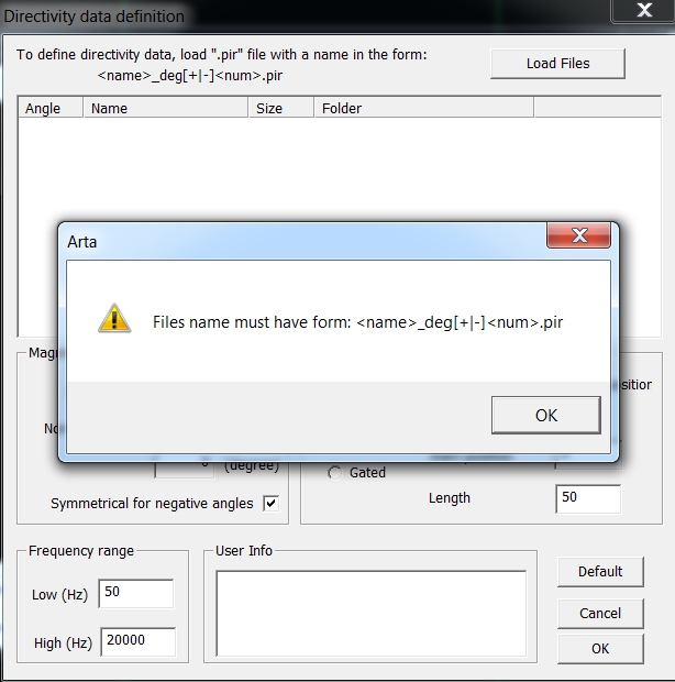

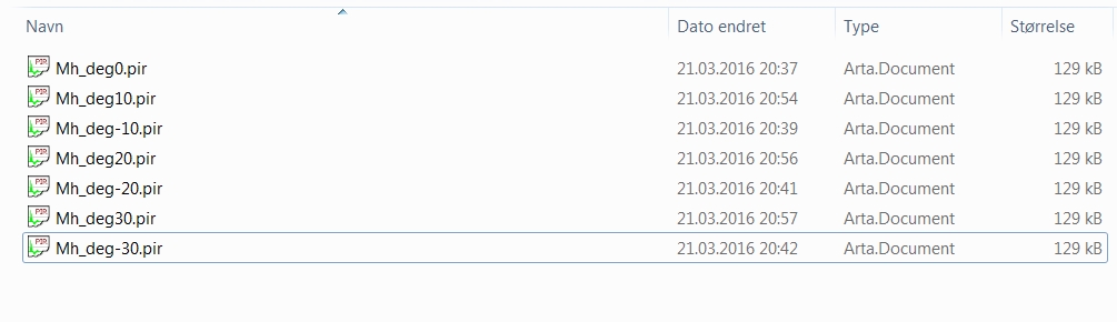

Hi guys. I've done some polar measuring but right now I can't get ARTA to create polar plots. It worked last time I tried, I can't see what's wrong my with my name files.
Does anyone see anything wrong with mye files? I tried adding + as well, but made no difference. Still get the error message. Need some other eyes!

I don't see anything wrong with the files names.
I tried renaming some of my *.pir files with your file names and they worked just fine.
Can you post a *.zip file containing the 7 *.pir files to see if others get the same error message when selecting them?
I sent Ivo some of my files and he was able to create a polar with them. Using the exact same files I sent him and trying on two different computers, I still get the error message. 😕
Also tried to uninstall ARTA and reinstall it on one computer but with no success. This is really weird. Could it be a conflict with another program?
I've attached the files.
Ok. I get the same error as you do.

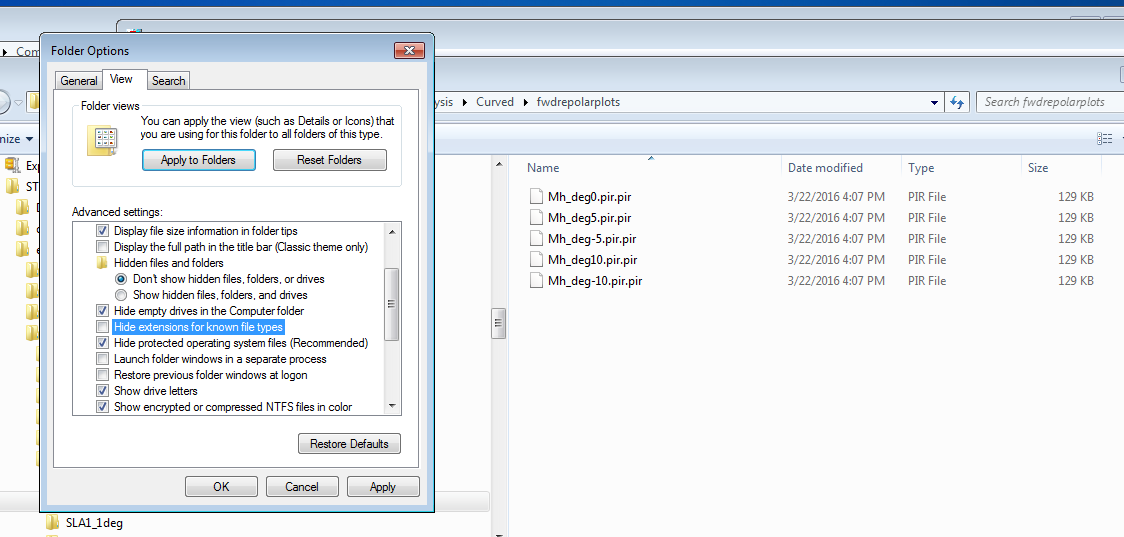

Looking at the pic I attached you can see that when I turned off file browser option to hide file extensions, you can see that the files names have an extra ".pir" in the file name. I'm guessing you must have the "hide file extension" option selected so the *.pir extension wasn't showing up so you added another one in by hand.
Removing the extra ".pir" and the files work fine. 🙂

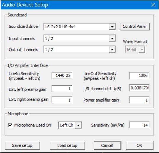

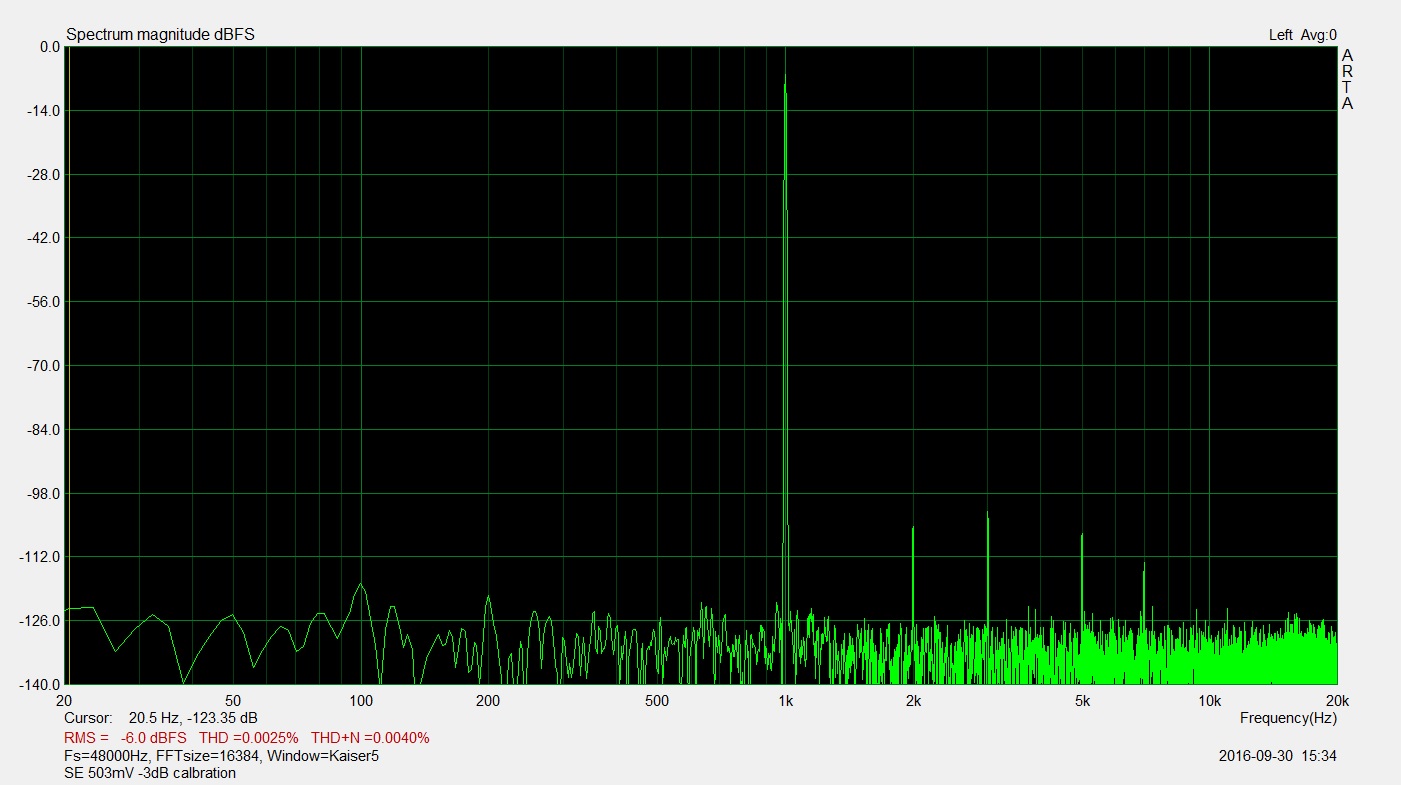

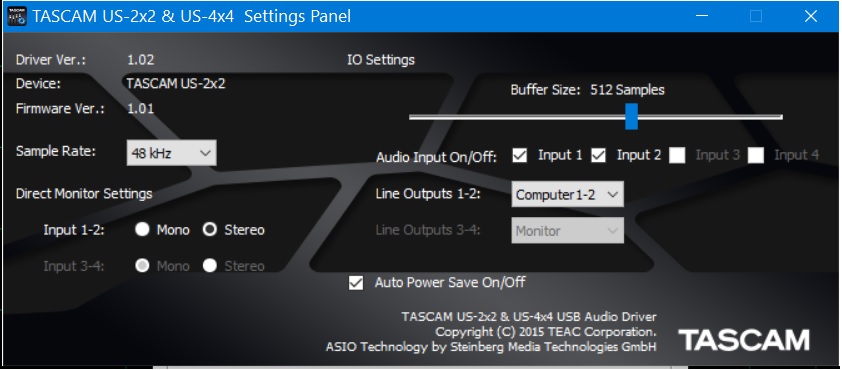

Meanwhile, I now have a Tascam US-2x2 and a microphone, and have been trying to get it all set up and calibrated 🙂
At the moment I have the Tascam output calibrated with the Line Out volume set at 12 o'clock, which gives a signal of 500mVrms. This gives the lowest THD in ARTA Spectrum Magnitude self testing. I am using single ended jack cables (TRS plug with no-contact on Ring), but have also tried with balanced cable, which gave about the same results, but with slightly lower THD due to 2nd harmonics cancelling out. So far so good.

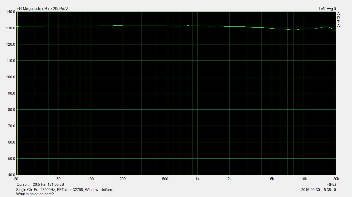

Next step is the Frequency response self test (loop back on both channels), and here the problems begin: The FR plot looks very strange to me, not anything like I have seen posted around here. I get the same results with both FR1 and FR2. Level just over 130dB, pretty flat but with some variance towards the high end of the spectrum. I have tried a bunch of different settings, but to no avail. I would really appreciate some help here 😕
Please see attached screenshots of Spectrum, FR and my current settings for Arta and Asio.
