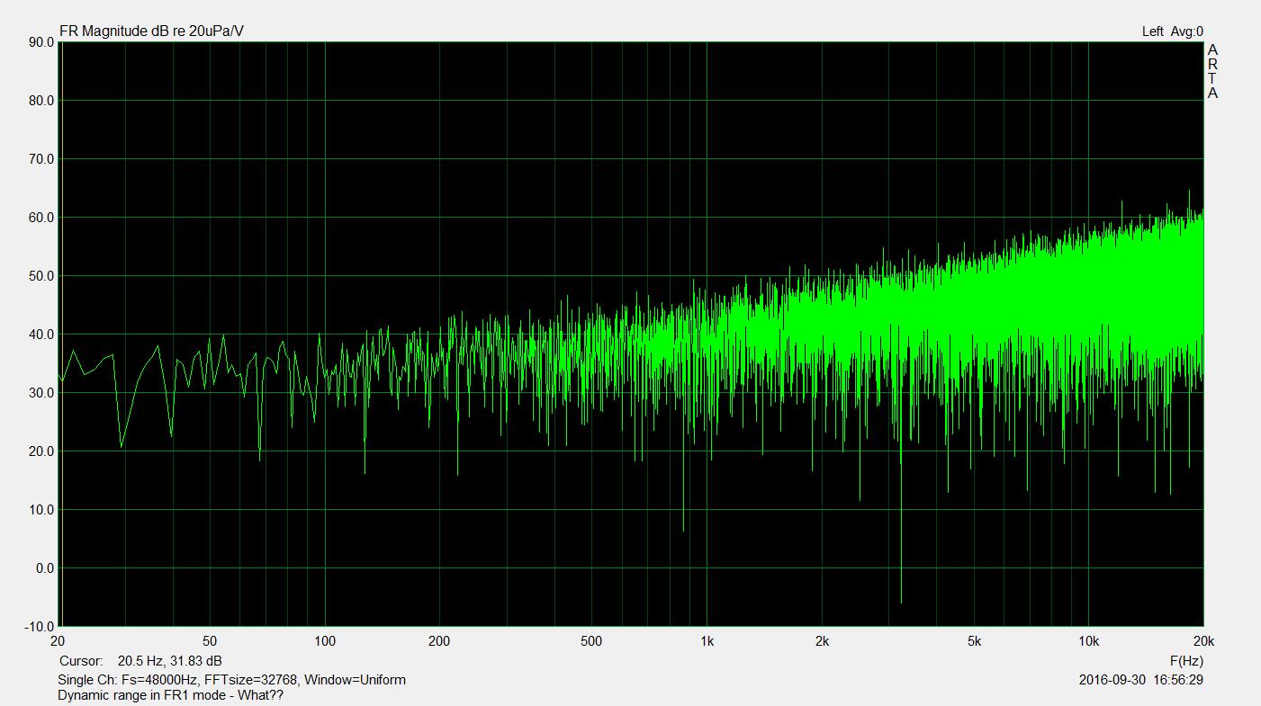

Hi Dave, yes you are right! That was the reason for the shape of the curve.
When I disable the mic cal, I get a flat curve. But I still don't understand why the level is around 130dB, and not at zero dB as shown in Arta manual page 59 (and elsewhere).
And when I disconnect the loopback, to measure noise floor, it looks wrong as well (see attached). I was expecting something like shown in this post: http://www.diyaudio.com/forums/multi-way/76977-arta-44.html#post4468748

Hello Ivo, thanks for stopping by 🙂
Yes that fixed the level! 0 dB FR results now, and the noise floor test moved down to around -90 to -100dB. So one step forward 🙂
But the results from the noise floor measurements still look like the picture in post 481, and not a line curve like on page 60 in the Arta manual. Why is that?

Noise floor measurement
For noise floor measurement manual shows results with 1/n octave smoothing and averaging.
Please, click right mouse button in FR window and set Frequency axis type to Octave smoothing and resolution to 1/3 octave.
Use at least 16 averaging.
License key has bee sent.

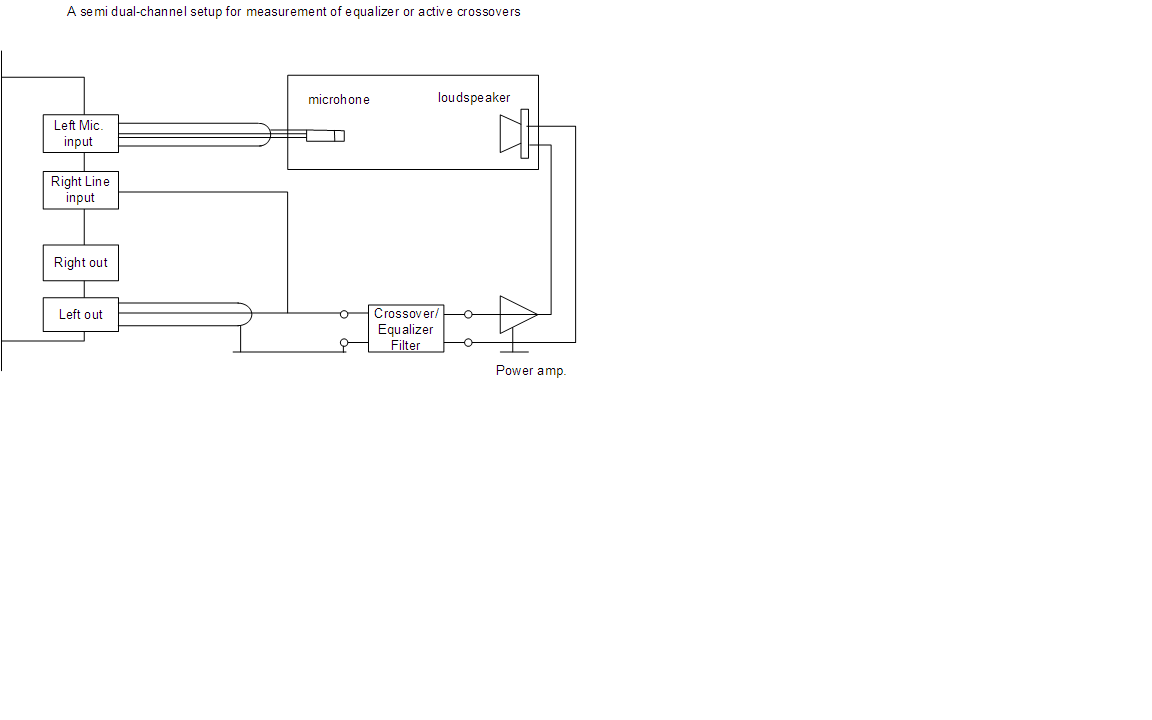

Hi Ivo,
I have the following question. We have done anechoic decay measurements on a speaker with a FIR filter that can be switched in or out to turn back the phase shift caused by a first IIR stage with LR4 filtering. The measurements were made with the FIR filter out of the loop.
Now, the feedback we got is that because we did the CSD measurement in minimum phase mode, the decay is longer than it would have been in linear phase mode.
Of course, the pulse is stretched out in minimum phase, so this might conceivably be the cause of a longer measured decay, but I just don't know the guts of your program well enough so I am just guessing. Can I please ask what your take is on this?
Measurement with equaliser/active crossover
Hi Vacuphile,
in attachment I give you shematic of measurement setup when you want to include response of active crossover/equalizer filter in the loudspeaker response.
If you make filters in digital domain, than you may expect large delay especially if you use FIR filters.
If I've understood You tried to compensate delay of IIR filter with FIR filter, so delay is very large. Also, long pre-ringing of FIR filter is hard to catch in CSD response.

Ivo,
This type of (extra) delay in the measurement loop highlights the issue I noted back near Post 308.
When inputting a relative delay in FR2 mode, that delay is implemented in the wrong leg of the measurement.
Even assuming a user was using a FIR filter with long delay, the displayed response could still be reduced to minimum-phase with an concurrent delay in the reference channel.
Dave.
That said, and for vacuphile's benefit, there is a psuedo work around to this issue.
Just reverse your input leads and make the measurement channel the reference channel (and vice-versa) and then input an appropriate delay (in milliseconds) into the Measurement Config box. That will allow you "back out" any latency in the DUT.
Dave.
