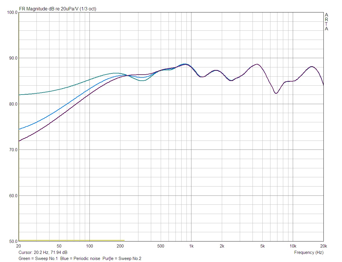

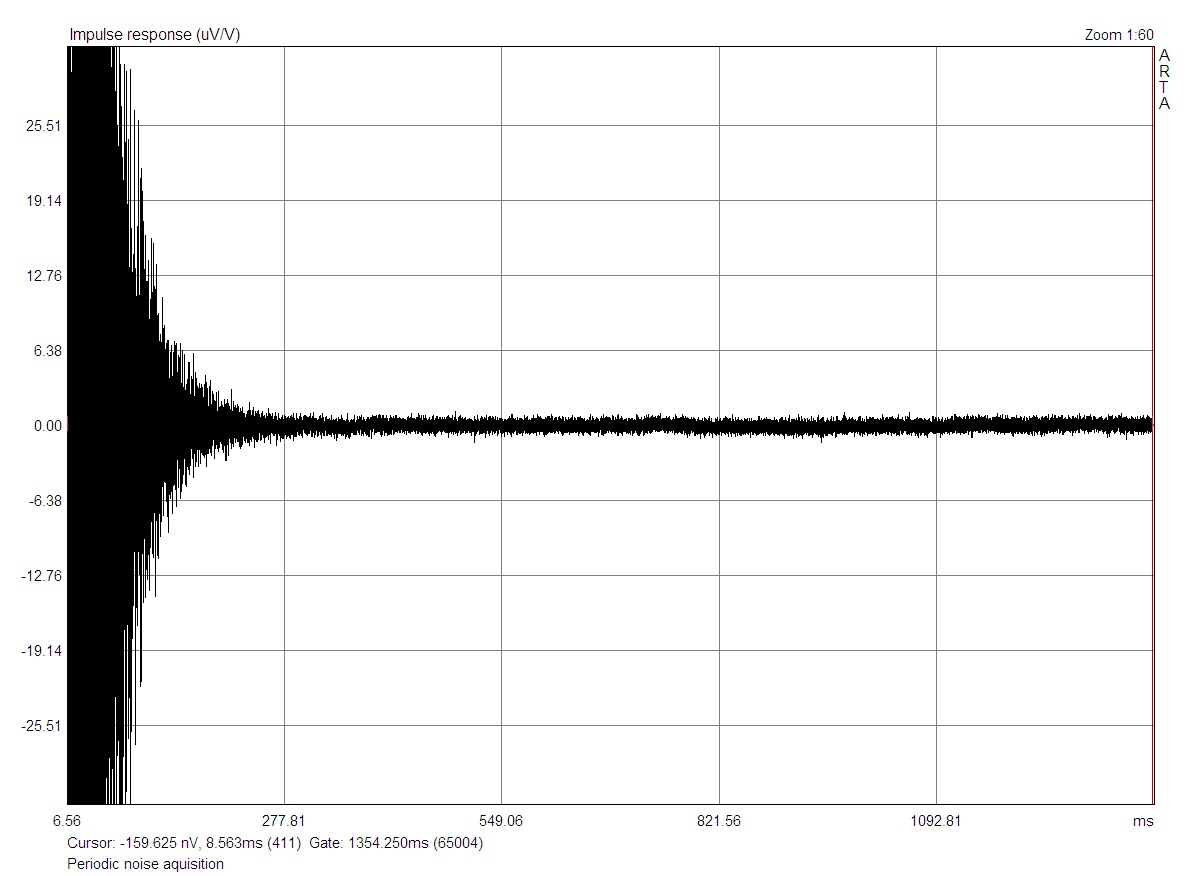

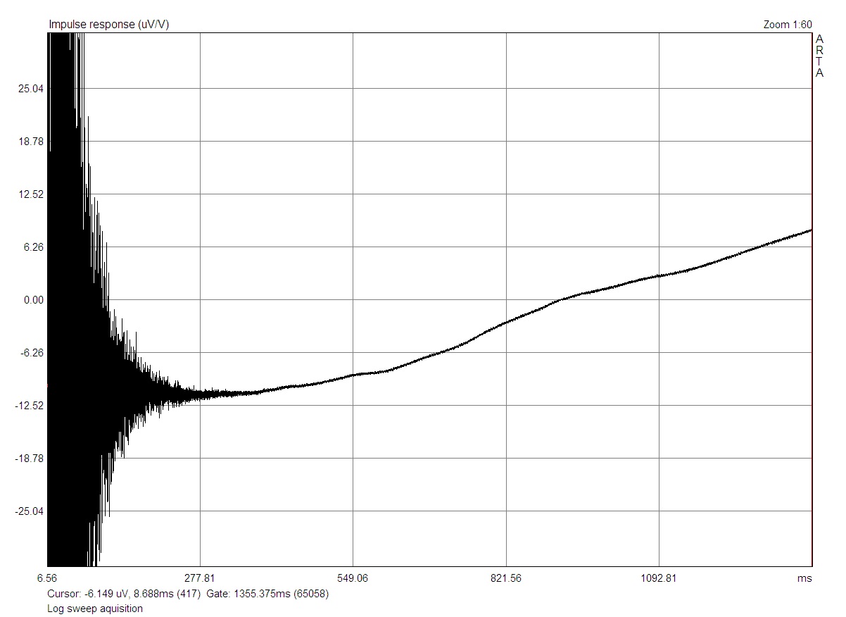

Hi Ivo,
I have a problem that I hope you can shed some light on. In Fig. 1 attached, you can see 3 frequency responses that I made on an old two way loudspeaker. The Blue curve was measured using Periodic Noise and regardless of how many times I repeat this measurement with this signal source I always get precisely the same response at low frequencies.
However, when I change the signal to Log Sweep, I get inconsistent results at low frequencies as you can see from the Purple and Green curves.
All 3 measurements were made with 4 averages.
If I expand the magnitude of the impulse response to maximum as in Fig. 2, the response (using Periodic Noise) appears normal over the time period from 300mS to 1354mS, but the corresponding response using Log Sweep appears vastly different as shown in Fig.3.
All these responses were made using an M-Audio Audiophile 192 PCI sound card.
In an attempt to locate the cause of the problem I decided to purchase a new ESI Juli@ PCI sound card, only to find that this card also showed the same problem.
After I confirmed that this new sound card still exhibited this problem, I made a different test to see what the noise floor was by shorting the left channel input with results shown in Fig. 4. The Red, Green and Blue curves were made with the Log Sweep and the other curves with the Periodic Noise source. Hope you can help shed some light on what may be the cause of this problem.

Resolution of IR measurements
Peter,
I am very glad that you have noticed this behavior. It is actually the reason why I applied different types of excitation signals in ARTA (MLS; Swept sine and periodic noise).
I have always suggested:
1) Use noise excitation and averaging especially if you are working with large impulsive noise or with very low level signals.
2) Use swept sine without averaging and assure that you have large level of acquired signal, and low level of impulsive noise.
Problem with swept sine becomes aparent with low level signals. For good results we need to satisfiy at least 12 bit resolution. If you have lower level of acquired signal the result become biased.
So, to conclude:
for testing of soundcard resolution (noise floor) please do not use swept sine signal as resulting IR signal will be biased with an "close to DC" component.
Best regards,
Ivo
