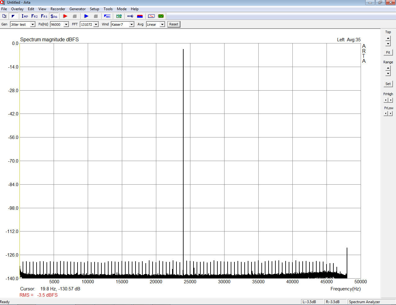

Get into the Spa mode and over at the left in the "Gen" field select "Jitter test." (It will scale the J-Test signal frequency based on the Fs that you have selected.)
The signal will then output on your soundcard directly or you can save it to a .wav file using that selection on the Generator drop-down menu.

You bet.Thanks, Davey!
I think the J-test signal was added at a later date by Ivo. It's not really referenced in the manual, so some of these terrific features seem to go unnoticed occasionally.
Check page 26 of this thread for a short mention.
