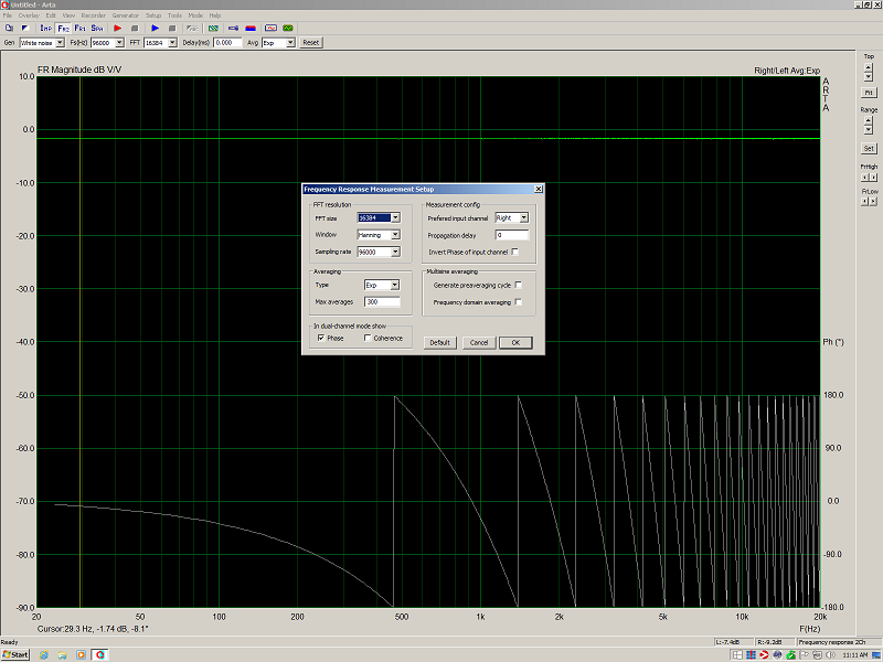

So I'm trying to make sense of the "Propagation delay" setting with an FR2 measurement.
For the first measurement I have a DUT (in the right channel) that has a 1.07mS delay and you can see the appropriate phase response.

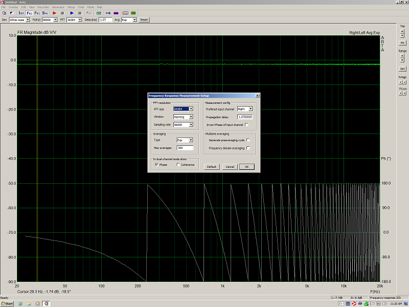

For the second measurement I input 1.07mS delay and I expected the phase response to level out. But it's having the opposite effect.
Obviously my objective here is to "zero out" inherent latency of the DUT and allow to evaluate the phase response of other parameters once programmed.
I must be missing a basic setup parameter somewhere?

Setting of propagation delay
Although you have set up "propagation delay", you still do not get proper phase response probably because you did not put cursor at zero delay sample position, which is sample position 300. - It is most common mistake in measurement of phase response.
ARTA forces shift of "zero time" position to sample position 300 just to allow incorporate pre-ringing response of FIR filtering

Ivo,
I am in the FR2 mode and have no ability to place the cursor at any position.
Are you saying that ARTA is incapable of compensating for a pure time delay in one channel of a measurement in the FR2 mode??

It was my bad explanation. I gave explanation for dual channel IR measurement, not for Fr2 mode, where you cant make adjustment by cursor. Sorry, to confuse you.
The propagation delay is just the way to enter time difference in measurement channels. It can be positive or negative value, depending on which channel is used as reference channel. One way to estimate propagation delay, if it exists, is by command 'Record->Crosscorelation/Time delay'.

Ivo,
Thank you. Yes, I understand the operation of the dual channel IR measurement.
For the FR2 mode, I did try to enter a negative value into the "Propagation delay" field but receive the error "Enter a number between 0 and 1000."
With either left/right or right/left reference configuration it still seems impossible to characterize a single-channel time delay in the FR2 mode in this way.

Ivo,
Thanks for checking.
I hope I'm being clear on my issue.
What I'm saying is that when performing a transfer function measurement of this type, if the DUT has an inherent delay (and you want to compensate for it) then the compensation for that delay should be placed in the reference channel and not the measurement channel.
This is just a minor detail and not a show-stopper for me. I can easily switch to an alternate program (like SpectraPlus) to perform this type of measurement. All-in-all, ARTA is a terrific measurement suite.

Hi Dave,
you are clear now. The problem is compensation of delay in reference channel. To allow that in next version I will allow propagation delay to be positive and negative value.
