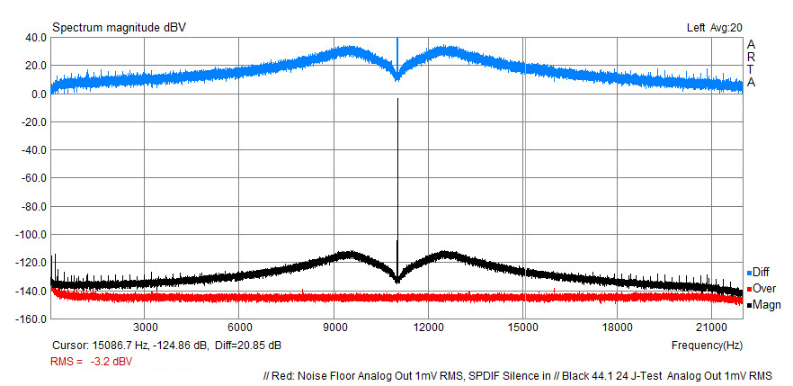

Hi Ivo,
I had a look at Audio Precision Technote 23.
On page 10 the relationship between double jitter sidebands and rms jitter in ns is given by Julian Dunn:
"For convenience, the formula can be modified by
summing the levels in both sidebands to give a total error,
and using rms jitter levels, Jn , in nanoseconds and
frequency, fi, in kHz:
Rdsb = 20 log10 (Jn * fi) - 104 dB. (9)"
As I understand it e.g. for a jitter frequency of 10khz with an rms jitter of 1ns, the summing of both sidebands gives a level of -84dB.
But this is only for the two side bands.
I am asking myself how I get the the total jitter if I record a noise spectrum of the DUT with a J-Test excitation (I know the spectrum contains also normal noise of the DUT, noise of the sound card, ADC jitter of the soundcard,.... But it is an upper limit.)

Hi Ivo
that is very pragmatic. And I believe for "typical jitter spectra" it will work well.
But how would I deal with a jitter spectrum as in the picture?
Red = Spectrum with "silence" SPDIF input; Black = Spectrum with J-Test 24-44.1 SPDIF input; Blue = Difference
Best regards,
Uwe

The point is that J-test signal is not signal for measurement of jitter. It is the signal that shows maximal sensitivity to jitter and we can use it just to see the effect of jitter on spectrum of sine wave.
You can make estimation of spectrum degradation but it is not the measure of jitter in second.
Ivo

If you want use more calculation here is report:
http://www.iet.ntnu.no/courses/fe8114/files/Report_audiodac.pdf
that refer to simple calculation of jitter if we assume wideband jitter excitation (not single sine as in Dunn paper).
For time being I do not intend to apply it in ARTA.
Ivo

You will get it fast, as procedure on page 8 is similar to yours - with important change that you must sum squared rms jitter value and at the end get square root of that value. Do not integrate values that are close to normal noise level.
Ivo
