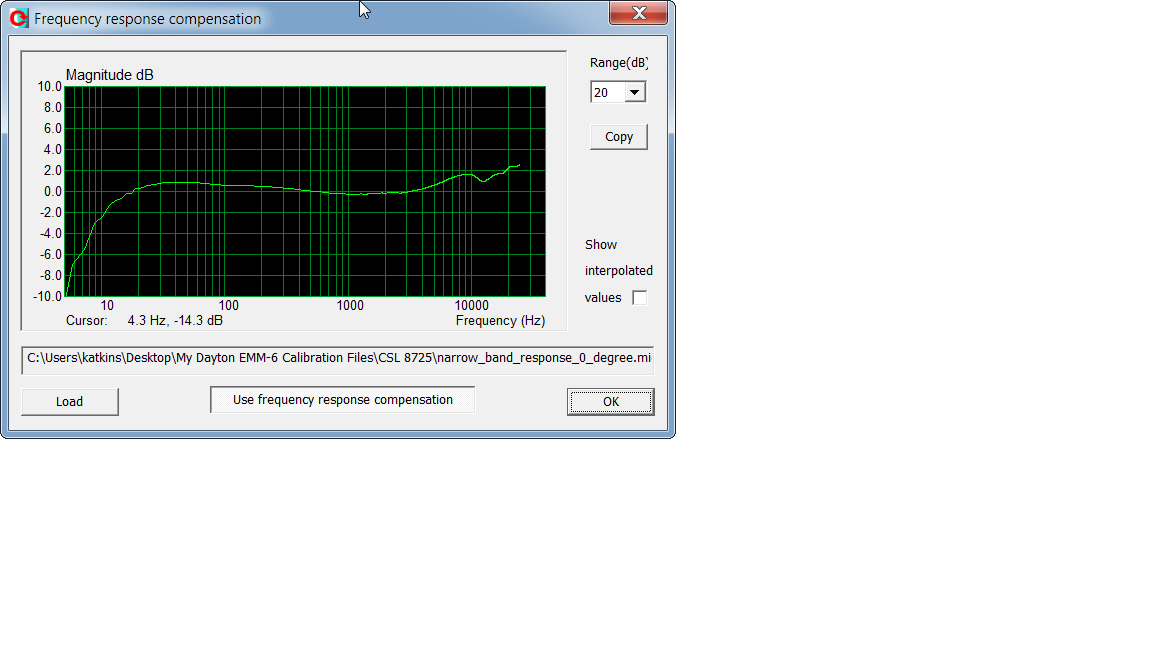

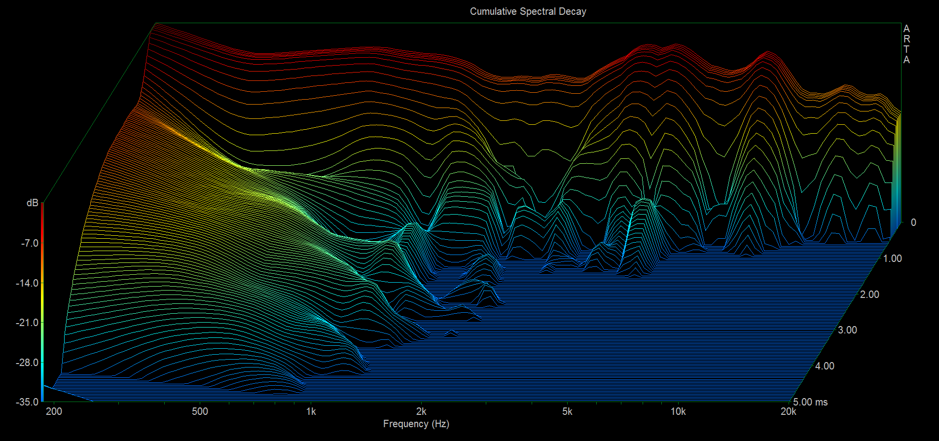

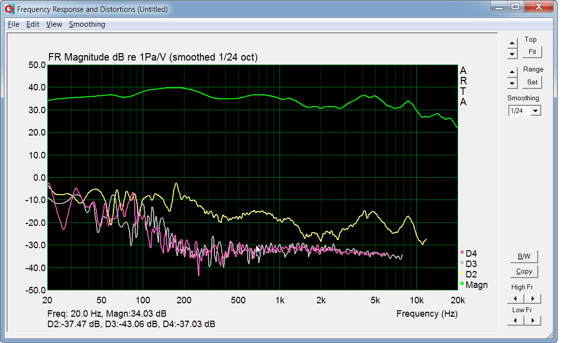

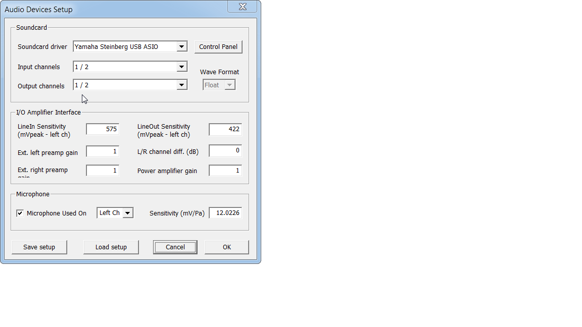

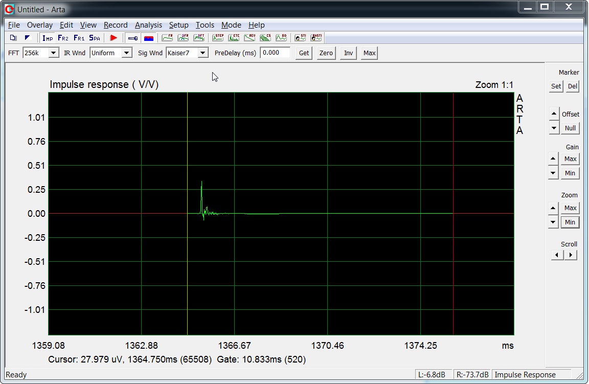

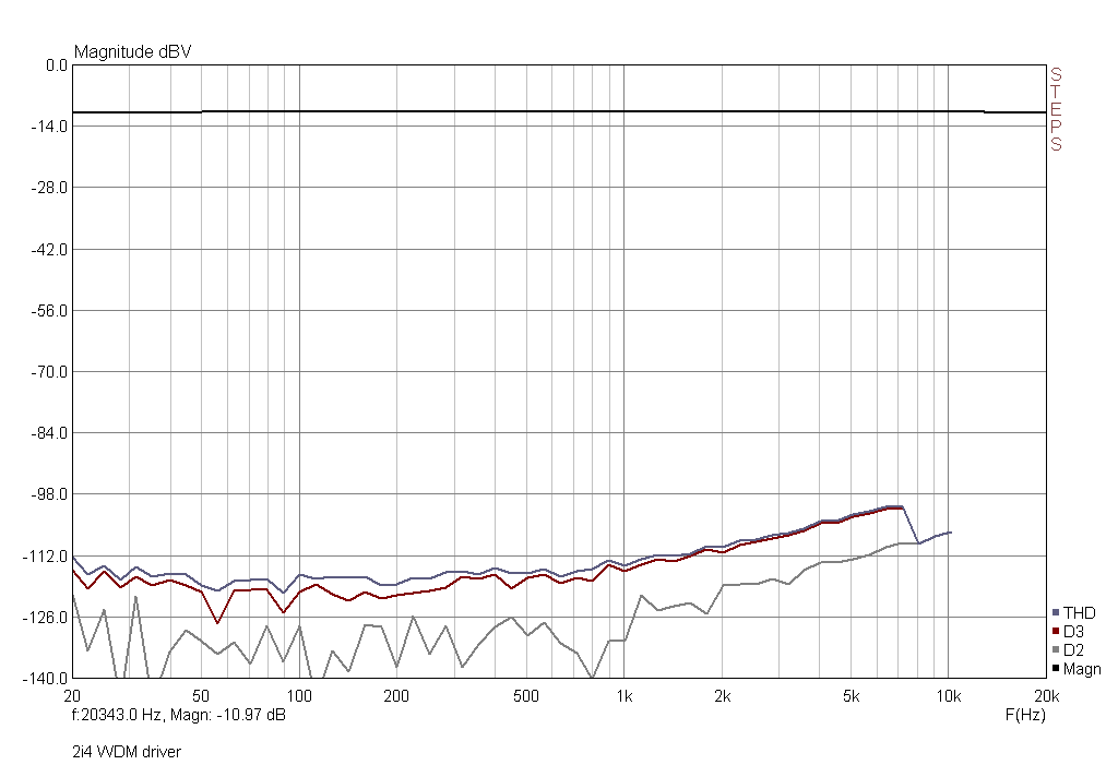

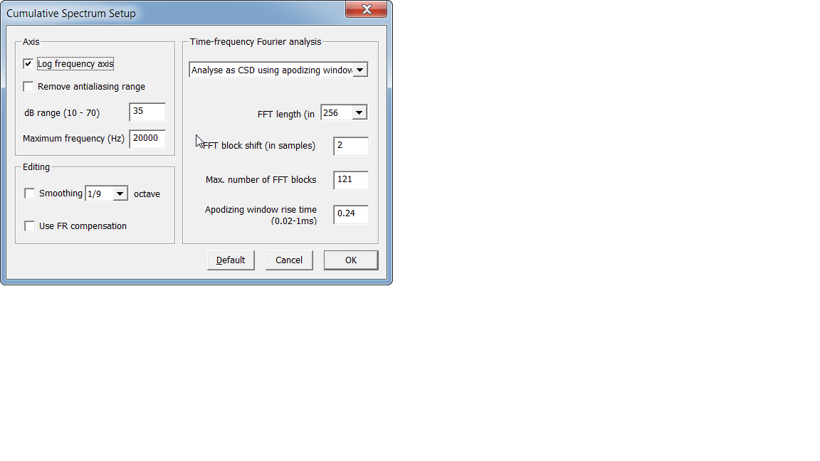

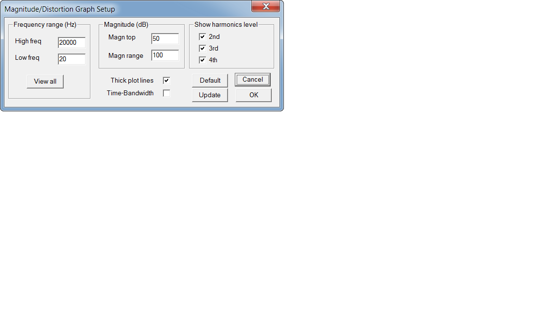

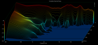

ARTA Setup Questions
Hi Everyone,
I'm a new user of ARTA. I purchased the full version and I've been working for 4 weeks to get it setup properly. I searched this thread but came up empty handed. If I missed anything, I apologize for my oversight.
I've successfully calibrated my sound card and mic. I can generate FR / Distortion graphs and CSDs. I have a few questions, though, about setup.
If anyone can help, I'll be most appreciative.
1. How to configure ARTA to display FR Magnitude / Distortion as: FR Magitude dB V/V instead of one of the 3 available to choose from: dB re 20uPa/V, dB re 20uPa/2.83 V, dB re 1Pa/V
2. How to adjust CSDs to display FR less than 200 Hz: say, 20 Hz to 20 kHz
3. How to adjust FR / Distortion graphs to a relative 0 dB baseline rather than 30 dB which seems to be the closest I can get
4. The effects of changing Gate 1 and Gate 2 settings

Hi Everyone,
Gear Chain:
PC / Windows 7 / ARTA > Steinberg UR-22 USB Interface > Line Out > Centrance Dacmini (Amp) > Headphone on DIY Dummy Head > Dayton EMM-6 Mic calibrated by Cross Spectrum Labs / DIY Dummy Head > Steinberg UR-22 > PC / ARTA
Magnitude_Distortion Graph Setup for FR Magnitude and Distortions Graph (1).png32.2 KB · Views: 160
