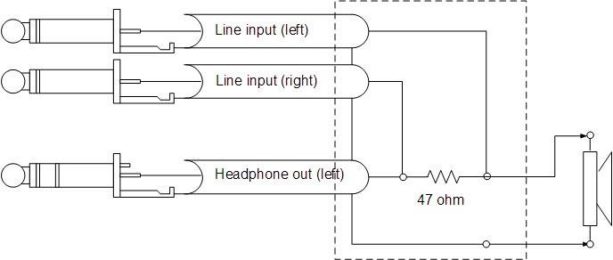

I have some questions about ARTA I hope someone can light me up:
1- ARTA manual says it need an amplifier from 10 - 50 watts. will ARTA calibrate itself with amplifier power? is amplifier sonic performance (linearity,...) important here? what class of amplifier is good to be used for ARTA? D?A?
2- do we need an extra box for measuring T/S? is there any schematic for a newbie?
3- can I make a box and put amplifier + USB card + phantom power + impedance switch box and all connections needed in it?
If sound card has headphone output channel, which is the case for all pro sound cards you do not need special hardware.
Attached picture shows simple cabling if you have professional sound card.
