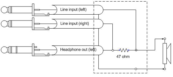

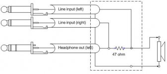

Hello, it's first time I'm setting ARTA up. I hope someone will light me up.
What I have:
M-Audio Fast Track pro USB sound card with Phantom power Dayton UMM-6 and Dayton EMM-6 which one is better to use?
I've read the manual and I think I need following:
1- an amplifier from 10 to 50 watts. is this a good choice? link
2- for measuring T/S I will need a jig with some resistors I can build. right?
what else do I need?
Use EMM-6 with phantom powering.
For most measurements on loudspeaker response it is better to work with low power amplifier - 10-25 W.
You dont need special jig for impedance measurement. Use headphone output, resistor 47 ohms and make cabling as shown in attached picture.
