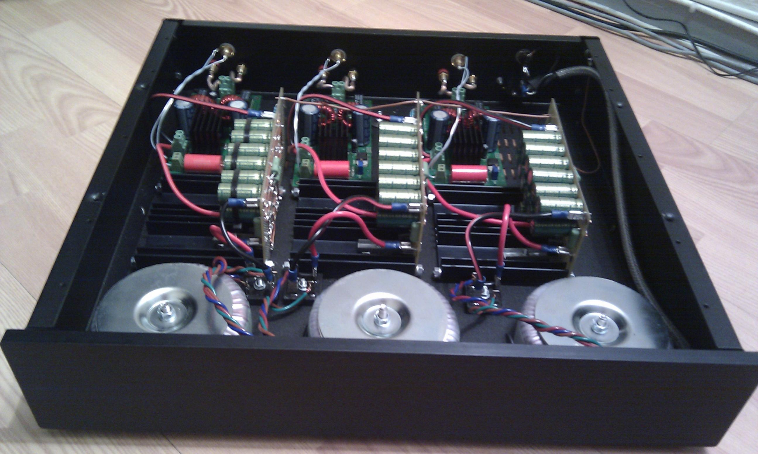

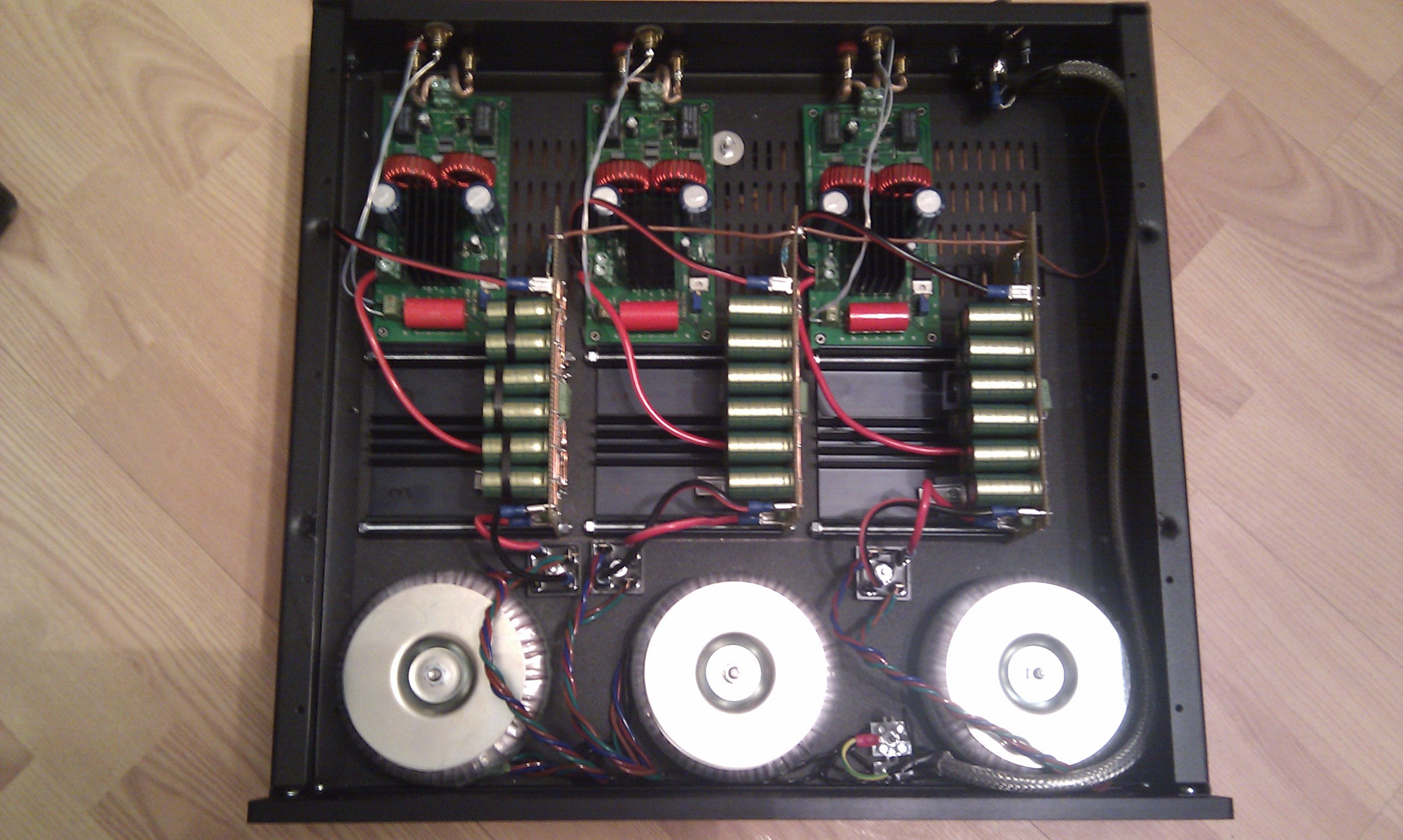

Thanks. I used shematic from this link: Roman Black's gainclone amp with som minor modification to match the voltage. The toroids are 22VAC. 12x2200uF Low impedance caps.
I will be running this in a 4-way active setup with pc xo and eq, but with a more powerfull amp for the bass.
