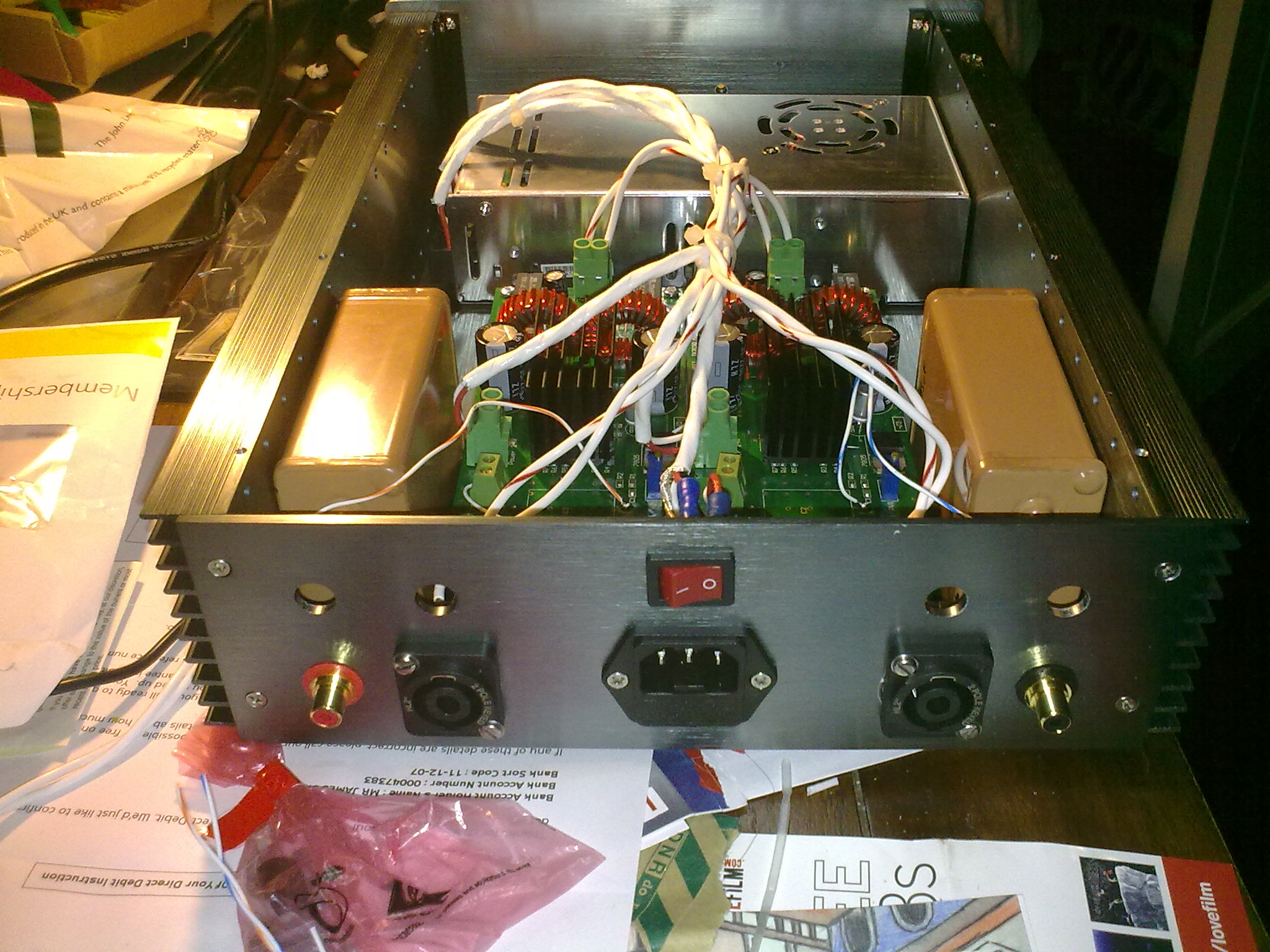

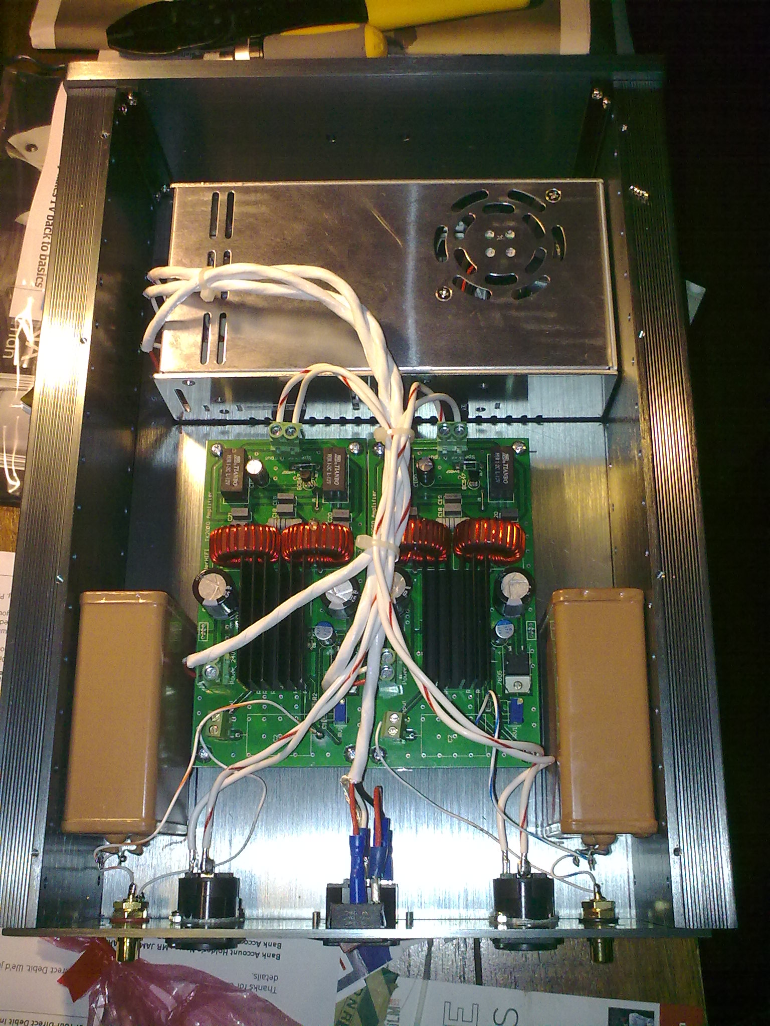

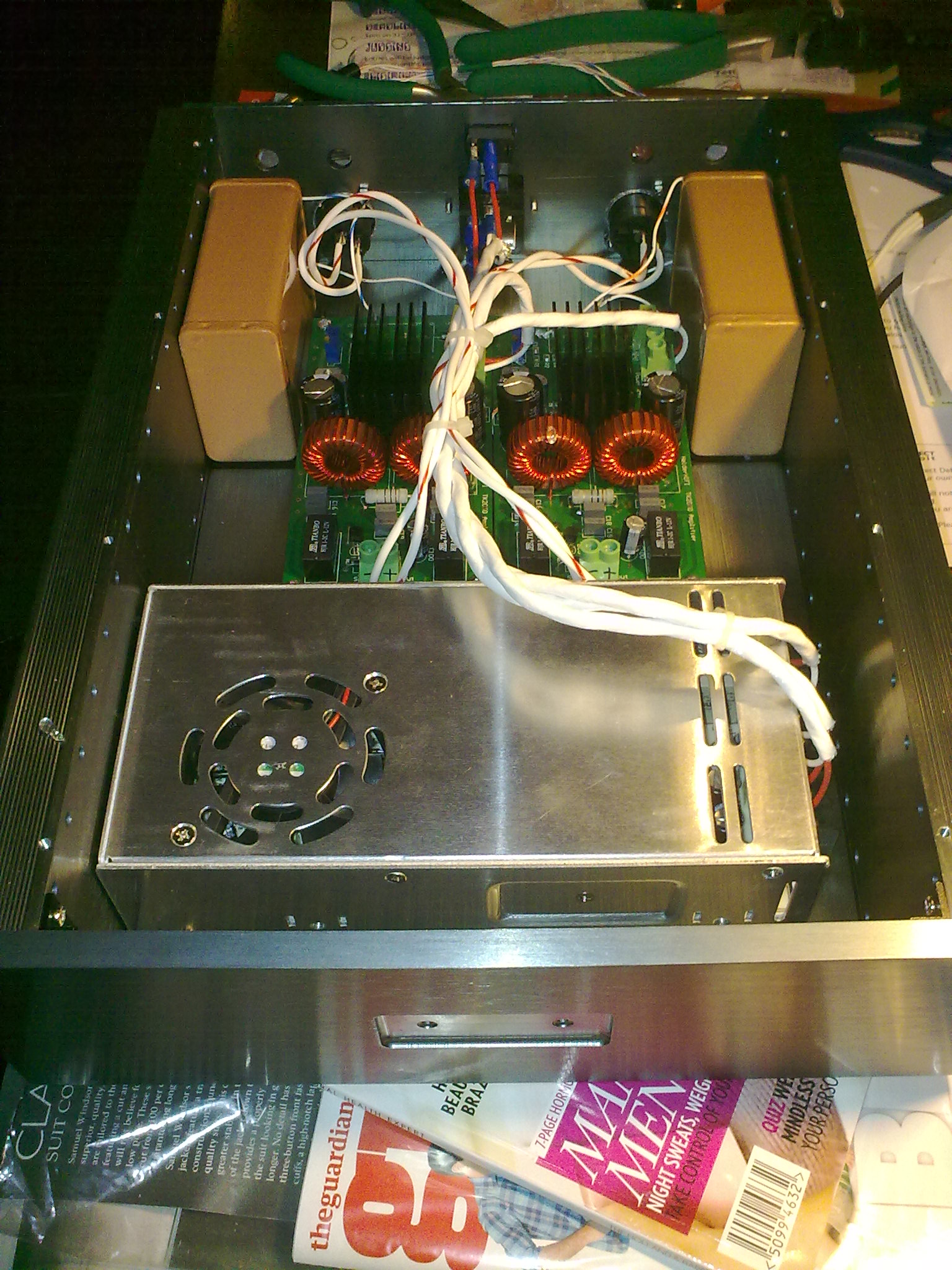

Received my two mono boards mid-week, and put the new amp together last night. I replaced all electrolytics: 4700uF Elnas replaced with 2200uF Rubycon ZLH, 220uF 16V caps after the LM7805 with 470uF 16V Nichicon conductive polymer and 100uF 50V relay caps with 220uF 35V Rubycon ZLH. I also removed the standard input coupling caps and wired in a pair of 6uF KBG-MN foil/paper/oil caps.
I had a couple of issues changing the caps over. Firstly the traces running to/from the bulk decoupling caps are extremely thin (<1mm) and two of them lifted when I gently removed the standard caps. I ended up adding thin runs of wire to double up on the problematic traces. Secondly, while changing the caps I noticed that one of the legs on one of the standard 220uF 16V caps after the LM7805 had not been soldered.
I used a Meanwell SP-200-24 switch mode PSU, which has a far higher switching frequency than the S-200/350 PSUs that others have used successfully and also active PFC. While I had replaced the bulk decoupling caps on the amp boards with 2200uF instead of 4700uF I figured that I'd get away with a smaller capacity with the SMPS.
The SMPS has an internal fan that is supposed to speed up as required. I thought that when the SMPS is cool, the fan wouldn't engage. Unfortunately the fan always runs and is quite loud. Even with the case lid attached, the noise was unnacceptable. I tried adding a series R in line with the fan to reduce the speed and noise, but the fan continued to make too much noise even with the largest series R that still allowed the fan to turn. In the end I disconnected the fan completely. The SMPS is bolted directly to the heavy heatsink amp chassis, and doesn't appear to get warm at all, so I reckon it will be ok without the fan working.
Sound wise, the amp is far warmer and fuller than I was expecting. I expected clarity and dynamics (which are there) but not the overall sense of ease this amp clearly has. Previously I had a mini Aleph installed, which appears to have a bit more body around 100-200Hz, but doesn't in any way outclass the TK2050. The tripath definitely has more HF clarity and extension, tighter bass and more dynamics. I'll let it run in for a few weeks before drawing any proper conclusions. Very very happy so far.
Definitley recommend these amps - just watch the soldering and be careful if swapping out components.
