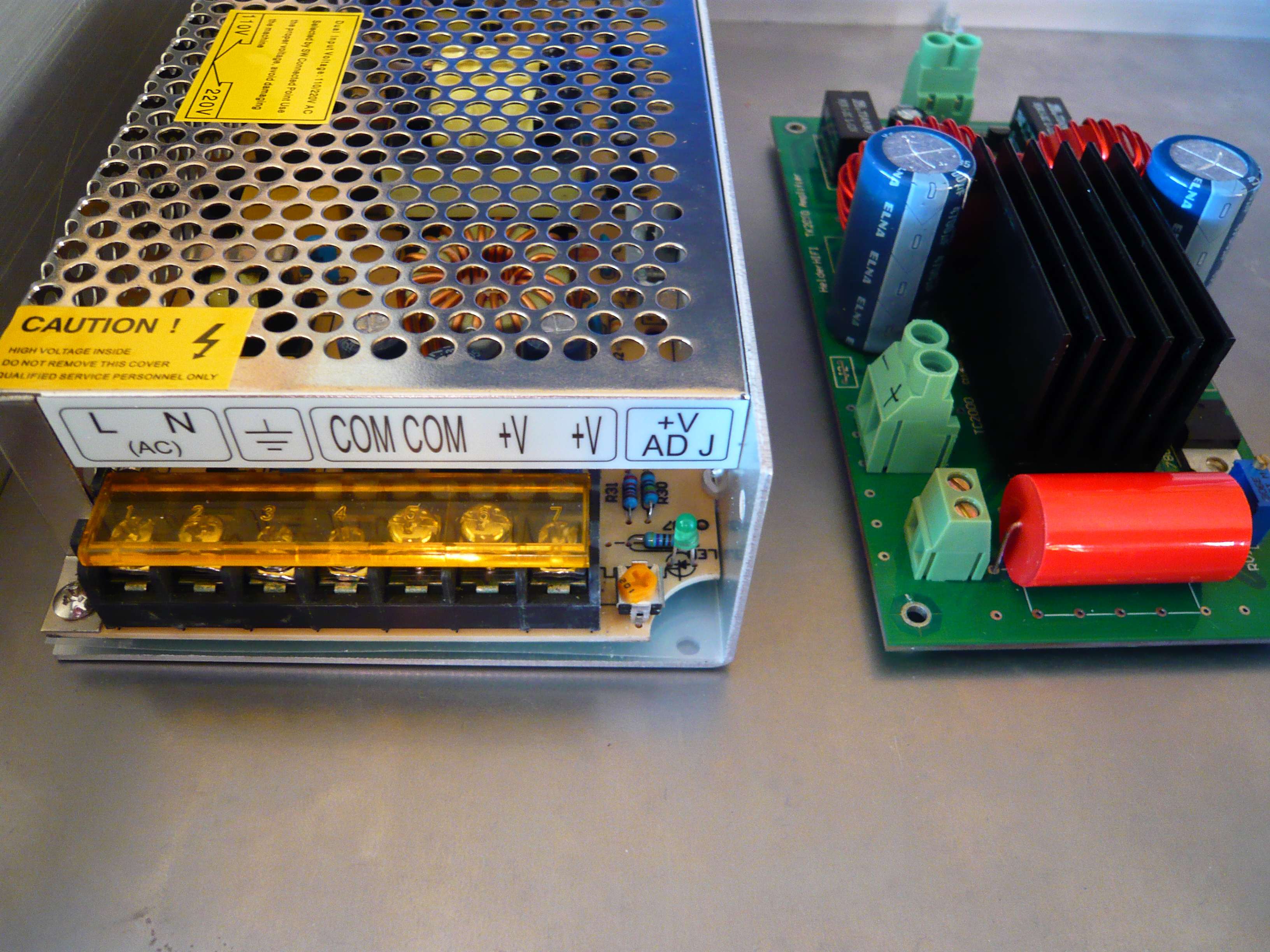

Okay for those who have been doeing these amp boards. It's very easy question, but it's the first time I do an amp like this with smps. I did the gainclone from audiosector with toroidal, and with the instructions was quite strait forward.
This is very simple aswell for many of you, but I'm not sure 100%
As you can se in the picture the smps has 7 screws wich are numbered from left to right (1, 2, 3, 4, 5, 6 and 7)
1 and 2 go to the mains, "to the plug"
3 is ground
then there is 4 and 5 wich are under "COM COM"
and finally 6 and 7 wich are under "+V +V"
I guess 4 5 6 and 7 go to the boards. So should it be 4 and 6 that would go to one board and 5 and 7 to the other?

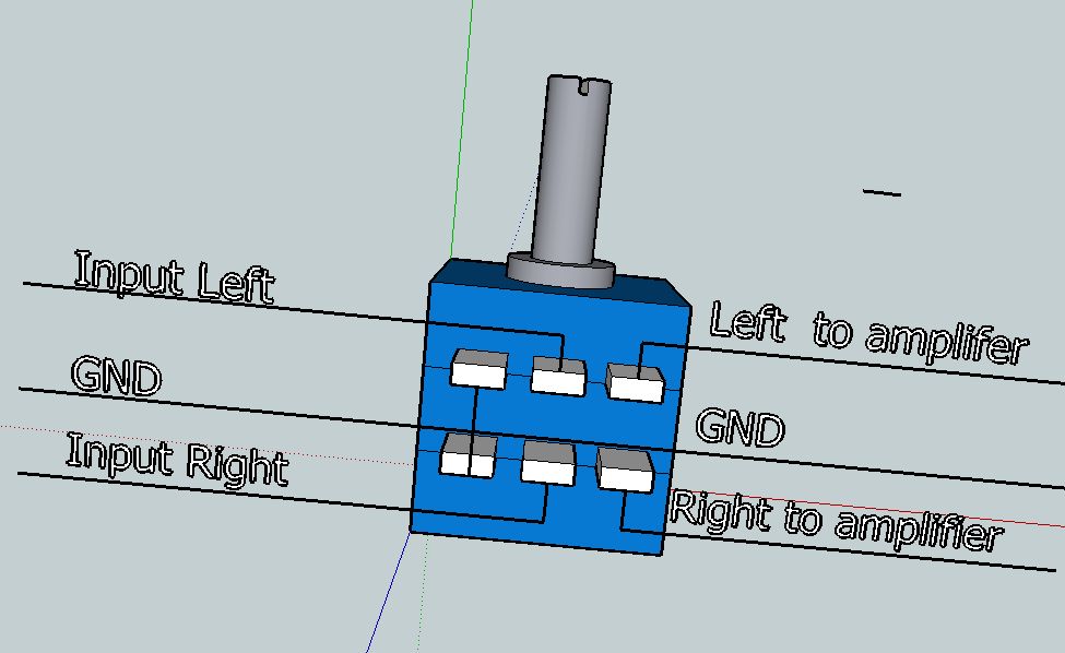

Another question would be the cableing between the boards the alps volume pot and the RCA's terminals. I'll post the picture as soon as posible.

Hi Juanito,
Get your voltmeter out, set it to DC and measure those voltages across those screws first. Adjust them using your adjustment pot to 27 volts. Make sure both read like that before you toast the amp boards. Although the boards will not come on above 35 volts or so and will work down to around 10, you want to make sure you are feeding them what Arjen recommends, if I remember it is 24-30 VDC.
This will help with the vol pot, just split out the signal to each separate monoblock:

Thanks whaleman for the picture! I remember this now when i did the gainclones with volume pot Noble.
I think that th smps came already seted from Arjen. I bought it together with boards, and the smps pack was opened to test it before shipping. I 'll ask
Arjen.
Btw, and I think is very simple, but connections from smps to boards??
You are better off figuring this out yourself, I know Arjen is very busy. All you need is 2 wires positive to positive and neg to neg from the SMPS to the connector labeled power on each board. This connector is between the blue Elna capacitor and the input connector, I think. "Power" will be written on the board at the base of this connector. It does not hurt to check your voltage even if it appears that someone set this for you, 27 volts DC is ideal.

I wanted to make sure that screws 4 and 5 are the negatives and 6 and 7 are the positives. I't looks obvious through the picture, but not sure. I don't have a voltmeter, so I don't kow.
The screws in the amp board I know wich is wich. That's okay. The screws at the SMPS 😕
I should get a voltimeter, but I've never used one.
