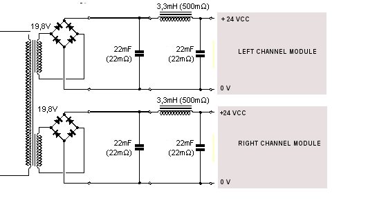

If you use 2 bridges, then do not connect the bridge grounds together, keep them both totally separate, and hopefully you have 2 sets of secondaries on your transformer, or 2 transformers to feed each bridge individually...
Yes this makes sense !
You have definitely solved my headache !
Thank you ! 🙂
That was what I was supposing but I had only seen schematics for solid state amps with positive and negative voltage.
I will try with two C-L-C filters, and probably some decoupling caps.
Simulations in PSUD2 give quite good results in noise filter, and ripple current attenuation.
So, this is the schematic I will built.
Hope this will help some other beginners like me.

That is a nice schematic, now those two capacitors are 22 uF or 22,000 uF? If 22 uF, then you are not providing additional power reserve than to what is on board already--which may be enough. But I like to have reserve power just for peace of mid that loud transients will be well supplied. Just a thought--not expert advise or anything like that.
Yes the caps are 22.000uF (22mF on the schematic 😉).

Sorry to take so long to reply, the email notifications on this thread have not been working. I used this toroidal with two 18 V secondaries at 6.94 Amps each. Your problem is finding one at 230V and not the 120 rated here. Avel Y236651 250VA 18V+18V Toroidal Transformer | Parts-Express.com
A 25V rated secondary is too high for the Helder monoblock. Mine ended up yielding over 37 DC volts (due to the 1.41 X factor for converting AC to DC).

Grounding
Confused about grounding the modules...
On the Arjen modules...
the RCA input Signal reference,
the Power input reference,
and the 4 screws for mounting the board in the chassis
... are all grounded together on the board.
So, I assume that it is a star ground on board.
Two things :
1 - As the 4 screws lead to safety ground on the chassis, it would maybe better to setup the board with nylon screws, and wire the board to safety ground in a single point of contact ?
2 - With metal screw, the 2 boards will be grounded together by the chassis safety ground. Is it the good setup ?

I get good results by not grounding anything in the traditional chassis ground way. The speaker grounds can not be shared for one. I would try to isolate the chassis from everything else, especially if you use metal screws to hold the boards down.
Been looking for those nylon screws everywhere, the mounts are even harder to find.
Hi there Whaleman,
The best thing is using the Nylon mounts, because they dont mess up the groundplane layout on the boards, i will order a bag of nylon screws here so i can add those to the boards!
