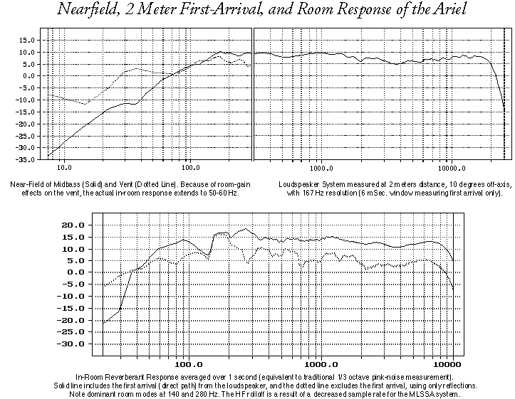

I built a pair of Ariel 6c speakers a couple of years ago using the templates that chrish made (it made the job a lot simpler!). I love the tight base and crisp highs but am disappointed with the lack of bottom end bass on some music. Before I go down the expensive path of building a pair of subwoofers I would like to try applying a bit of bass equalisation to the Ariels.
I can get a Sallen-Key filter circuit which can be configured for either a sealed (12dB/oct rolloff) or vented (24dB/oct rolloff) enclosure. However I don't know what the rolloff slope of the Ariels is. Does anybody know or has anybody measured this parameter? I also need to know the 3dB cutoff frequency.
I would measure it myself but I don't have the equipment or the knowledge to do it.

So back to my original question- does anybody know the bass rolloff slope of the Ariel 6c and the 3dB cutoff frequency?
I managed to find this freq response curve on a website belonging to a company that sells Ariel 6 kits. It gives the driver and port curves but not a combined response curve.

These are Lynn O:s curves. There are more of them on his website, but none of exactly this kind.
In his "Good Bass" section he recommends a crossover freq. around 80 Hz as a starting point.
<http://www.nutshellhifi.com/ME2txt.html#sw>
But, passing on the recommendations of a friend who has worked a long time to get the best performance with bass units for the ME2:s: these filters are room dependant. You will need to tweak both the frequency and the slope to your room. He ended up with a lower crossover frequency and a less steep slope than you would think is possible to use for the ME2:s, but it works great - in his room.

I've tried equalizing the Ariels and ME-2's low end. Bottom line, there's just not enough cone surface and X-max to get there from here.
You can get slightly more bottom end.... at the expense of the mids. You really don't want to go there.
Cyclotronguy
The list is long, often silly and frequently distinguished…complements of "The Great Pass" and his amazing inventory of common and obscure speaker drivers.
Lynn covers the issues quite well, forget the plastic cones… and don’t get too carried away with the very last ½ octave; you really need a woofer not necessarily a subwoofer.
One of the best woofers to match up with either the Ariel or ME-2 was the now impossible to find Audax HM210CO in a 9 foot TL. Another favorite is the Seas W-26 in a 2 ft^3 sealed box. Ditto for Lynn's four Vifa / Scanspeak's in twin sealed boxes.
If, you can get the woofers physically close… by all means use a pair of something, as Lynn suggested with the 180 Hz crossover point.
