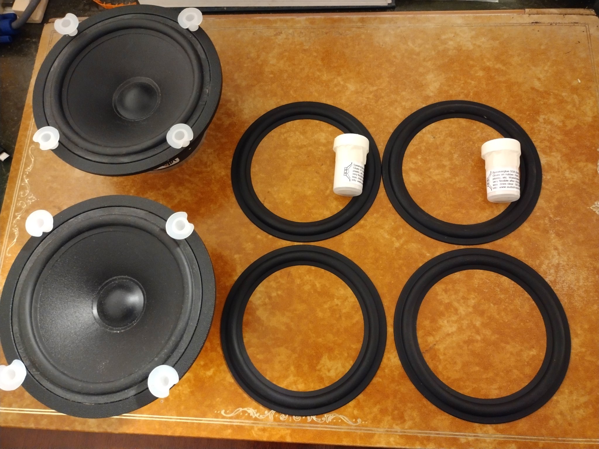

OMG! I just checked the surround, and yeah... It stiffens. Thx @nerdorama for the link. Might come handy for sure. Audiofriends has a video showing how to change the surround also. You guys are the best!
OK, I bite the bullet. I ordered the surrounds & some glue from Audiofriends. Shipping & handling are reasonable within Europe and they shipped promptly.... A bit of a pain to remove the original surrounds but can be done. A supplier in Netherlands, Audiofriends, also has OEM surrounds available. A bit spendy after shipping to US.

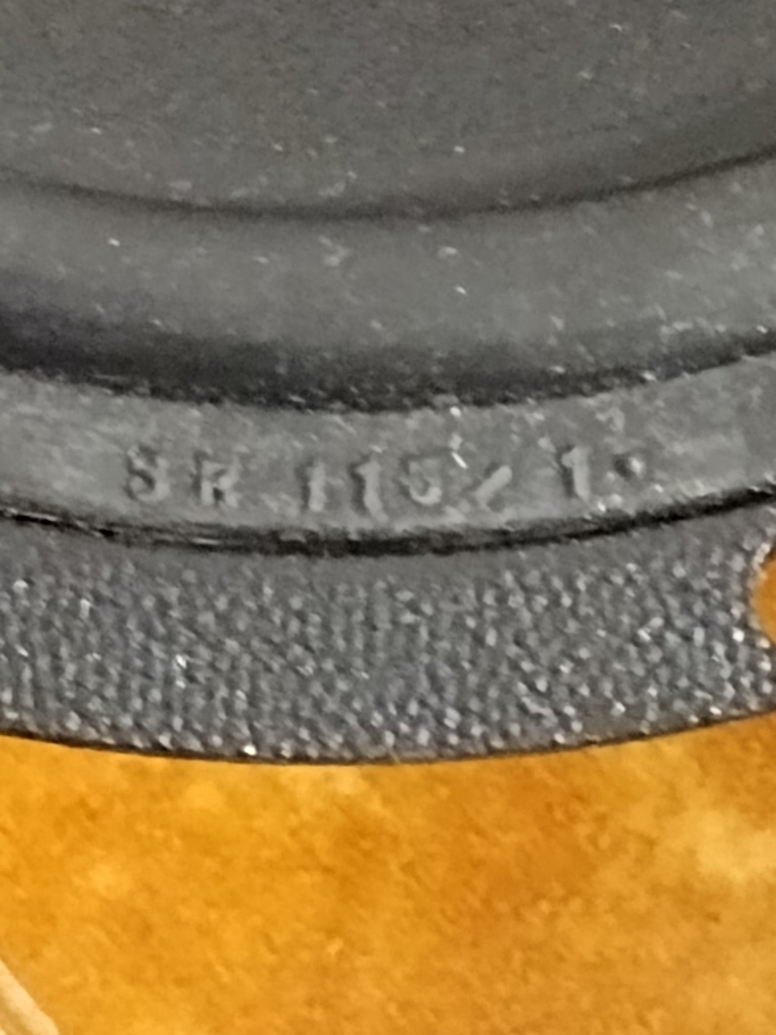

FYI, the surround they are selling is SR115/2.... whilst the original vifa P13WH has SR115/1 (see the photo). But, the specs between SR115/1 & SR115/2 are nearly identical (eg. diameter differs only 0.5-1mm). My next step will be the surround replacement surgery. Btw, I saw your p13wh surround replacement in Audiogon, John. Seems like it's not too difficult. I will post my progress in building this MLTL Ariel.
