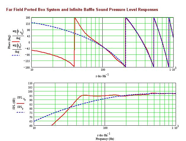

Here's an MLTL I modelled in the latest version of Martin King's MathCad worksheets (due for release around March). It uses the same Seas / Vifa drivers and Lynn's excellent crossover in an easier to build cabinet. I first posted this in the Full-range Forum in the thread on Martin's new sheets, but it might be of some use here.
Straight MLTL assuming 3/4" build material.
Internal line-length: 45" (external cabinet height 47 1/4" as best to double the top-panel).
Internal width: 6 1/2" (so preserving the external 8" width and avoiding any need for crossover modifications)
Internal depth: 12"
Circular port, 4"x2" (WxL) 3" up from the internal base on the front panel.
MTM driver layout, same as existing Ariel versions. Tweeter centre 11 1/4" down from the internal top or So.
0.25lbs ft^3 of Dacron (or similar) stuffing from the top to 4" below the lower driver.
Keep the large radii on the edges and top if you wish -no reason why not. You could also add a couple of internal braces too. Predicted anechoic response is shown below:

Gorfeas, have you solved the lack-of-sparkle problem? Or still no luck? Reading about your problems made me worried as I was going to start building the 6c version this spring...
Scottmoose, your predicted response for an MLTL looks interesting. Have you tried this in real life also?
Not yet. I will be at some point later this year, but I have a couple of other things to finish first. I used to own the V4, and I loved the drivers and crossover, but the cabinet... no.
Ariel was designed using traditional rule of thumb methods by Lynn before anyone really understood how quarter-wave resonators actually behaved. Don't get me wrong, I'm not knocking it or him, I'm just saying that we've made some major advances in the field, thanks to Martin, and now we know how they work and how to model and predict their responses. The old closed end with driver, open far end, tapered or untapered line is sub-optimal in 99% of conditions. Mass-Loaded Transmission Lines almost invariably give better performance than the 'classic' geometry, and I long ago learned to trust Martin's MathCad worksheets. This new one I'm playing with at the moment is a stunner. Based on my own experience with the V4, and with numerous different MLTL and ML TQWT enclosures designed in these worksheets, I'm pretty confident this MLTL should easily better any of the existing enclosure designs in terms of its frequency response, while also being a heck of a lot easier to build. I know that many point out that a flat response isn't everything: fair enough, and I agree. But I like to get as close to it as possible. Those concerned over materials could build the whole thing from birch ply (my suggestion), or, like the V6, MDF outer panels with doubled front and rear baffles, the inner pieces being ply, with some ply bracing if you feel the need, so you can blend the art of the originals into it.
OK, so lots of Ariel owners will probably want to crucify me for speaking such heresy, but it's not actually that different: it's still a quarter-wave resonator, albeit with a wider and shorter line, and most Ariels actually employ a form of mass-loading anyway due to the restrictions on their floor-firing terminus imposed by the spacers, which can be raised and lowered according to taste. Consider it another option in a world of infinite possibilities.

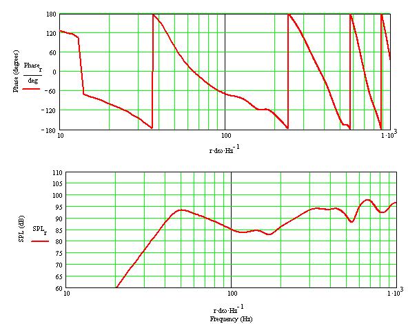

Good questions all.
Hmm. Bass differences. Well, the MLTLs tend to go deeper, smoother than the 'classic' (wince) tapered geometry terminating in free-space. They are very neutral and well damped, and have an extremely pure bass and midrange lacking the ripple common in most other enclosures, including traditional, unstuffed TLs, or the conjestion in traditional, over-stuffed TLs.
A quick bit of theory for you which should help explain things. 'Transmission Line' is an inaccurate description created by Bailey some 30 years ago for a heavily stuffed, straight line. It's an electrical term, not an accoustic one at all. The correct name is Quarter Wave Resonator, and they are designed to resonante strongly at a specific frequency. That resonance is called the Fundamental. Now, the problem is that you also create unwanted higher harmonic resonances in the process. (In a straight pipe, these occur at multiples of the Fundamental frequency, in a tapered line, they occur at different points). You can supress some of these by altering the position of the driver along the line-length, and try to damp the others with stuffing, but stuffing brings its own problems: too much, and you start to absorb the Fundamental resonance you were aiming for in the first place. Not so good. Fortunately, we can model these enclosures accurately now, using Martin's software, so we know in advance where issues are likely to occur, but the basic enclosure isn't ideal.
Enter Mass Loading. The air-mass in the restricted terminus provides an additional load to the quarter-wave resonances in the enclosure. This in practical terms does two things. Firstly, it allows a much shorter pipe. Let's assume we have a pipe, open at one end resonating at 60Hz. By correctly mass-loading it, you can decrease this pipe resonance to around 35Hz. The second benefit is that it frequently reduces ripple over 100Hz, which can only be a good thing.
Is the twin line necessary? In my view -no. There have been reported subjective improvements in the later versions of Ariel once they abandoned the original geometry, which joined the two driver pathways into a single labyrinth, I believe regarding sorting out a very slight touch of mid-bass 'muddle'. I haven't heard the early versions, so I can't speak from experience. However, I can note a couple of things. Firstly, the initial path-lengths were considerably different -effectively, you were joining two quarter-wave resonators of different lengths, and hense, different tuning frequencies, together. Not such a good idea. Secondly, the enclosure was designed under the old rule of thumb methods, and wasn't optimised in any case. In an MLTL, both drivers 'see' an identical line-length and resonant mode, which they simply excite at slightly different points, so 'muddle' isn't going to be an issue. Ripple might be fractionally greater than for an equivelant setup with one driver, but this will be damped out by the light stuffing and mass-loading. In this case, they are pretty small drivers anyway, and so close together that differences will be very minimal.
Hope some of this helps

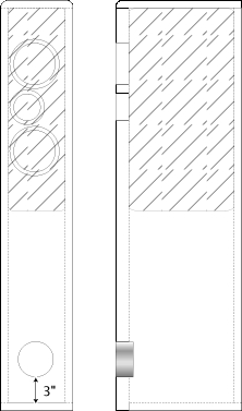

OK, I did a drawing.
Image should be in this message if everything works out. Actually, guess what? there are some questions...
The 3 inches distance from the inside bottom of the speaker to the hole - is that
1. the distance between the center of the hole and the bottom, or,
2. as I drew it, 3 inches of clearance between the hole and the inside bottom?
I don't know anything about MLTL ports. Are they constructed something like a BR port? So I can use whatever I want with the correct diameter? And the length of it, is that
1. the total length from the baffle front, including whatever depth the baffle has, as I did it, or is it
2. the length of port that protrudes from the inside of the baffle into the speaker?
For now I plan to use birch ply for all sides, spruce for the front baffle since it is a nice and soft wood, and birch or spruce for the top "lid".

You're welcome. I like the drawing by the way!
Sorry, I should have been clearer about the port position -force of habit. You're frst guess is the correct one: 3" from the internal base of the cabinet to the centre of the port, which puts it as close to the floor as possible. As for port materials: same as you'd use for a reflex enclosure, which is helpful. MLTLs don't require anything special in this regard. Port length includes the depth of the front baffle, so again, you're first surmise is the correct one.
Material choice looks good to me. One suggestion: double the top-panel. The top of a QWR has the greatest pressure appled on it, so doubling it should help prevent resonances. As I say, I haven't built it myself (yet -give me a few months!), but I haven't gone wrong so far with anything I've designed and modelled before building in Martin's worksheets. I reckon this one could be very impressive. It's well worth reading the articles and papers on Martin's site: the amount I've learned from those, and from chatting with him is truly frightening, and I owe him a great debt of thanks for all his help, which has had the side benefit of stimulating my own interest in many new fields I might never have looked at.
I wonder what Lynn would make of it. I might fire an email his way and get his views if he has the time in between his editing and designing etc.

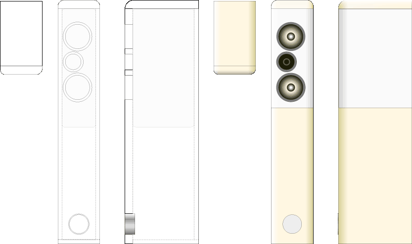

drawings, v2
Alrightie!
Port moved further down, and lengt kept as it was. The large radii weren´t quite right so they are redrawn.
I added a top view and made another drawing with some colours and shades to get a better idea of the appearance. I thought perhaps it would be fun to try putting felt around the drivers. Or leather, or something. This is the light grey area you see in the coloured/shaded part.
This is drawn assuming 21mm birch ply for the side + bottom panels and 40mm spruce, maybe made with solid wood "square profiles" (sorry, I am swedish and lack some proper english/american words regarding wood working, just ask me to explain and/or correct me if I don't make myself understood) glued together with vibration damping glue.
The driver cutouts that Lynn O suggests should be easy to do. Maybe the Scan-Speak would like its own chamber?
Some bracing could be needed also, I guess. But perhaps it´s best to try and find the "nodes" when the boxes are built?
